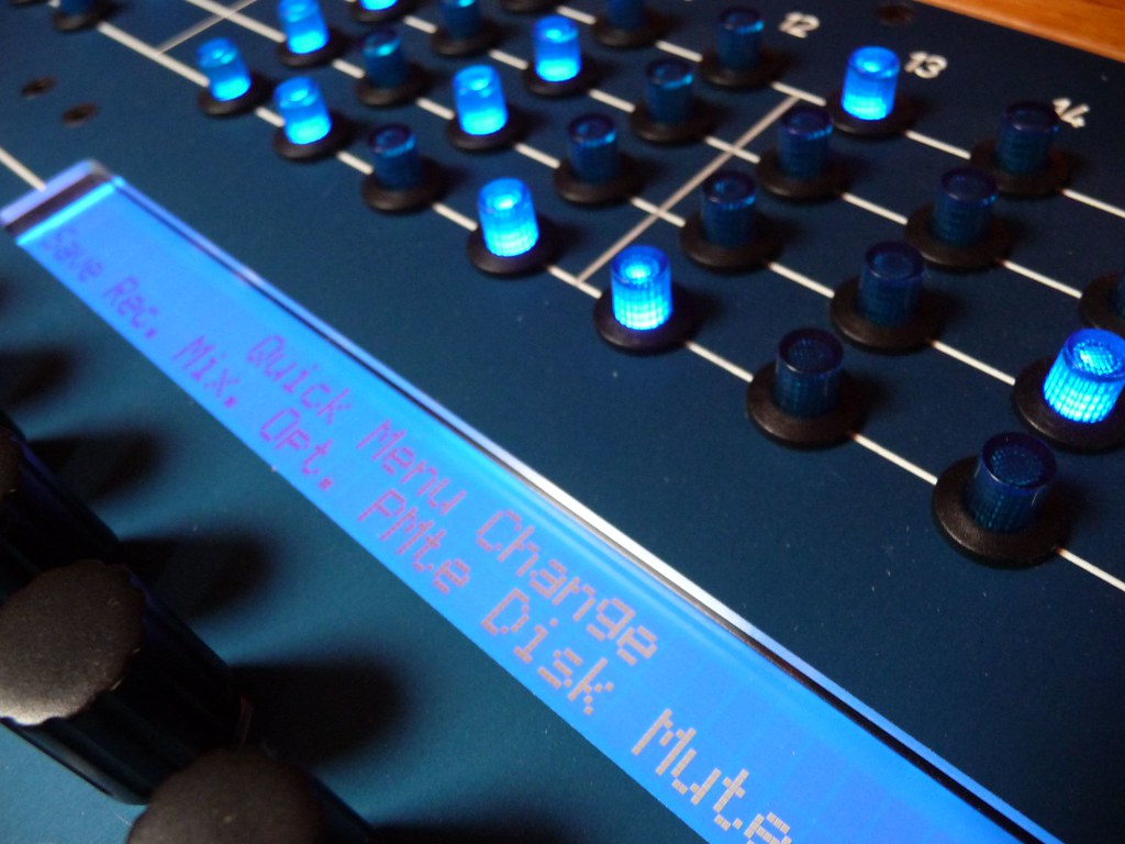

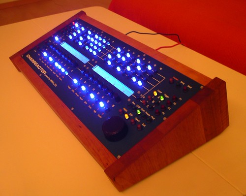

so since last weekend I have a grin on my face and this BOX on my desk:

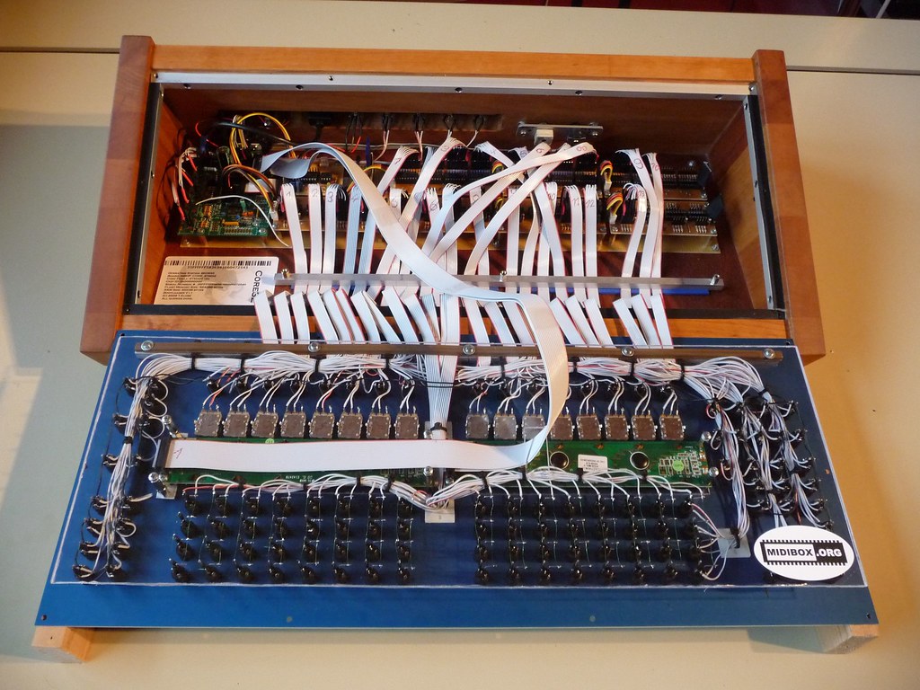

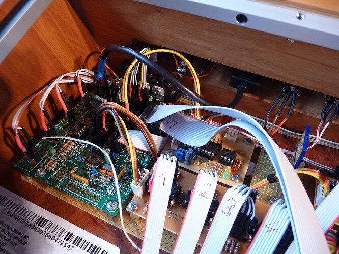

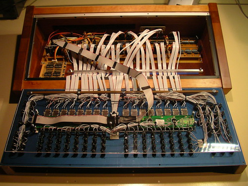

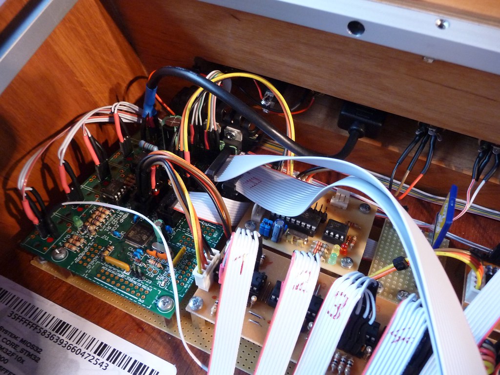

INSIDE:

My “want to have it all” frontpanel as well as the rearpanel is from Schaeffer
The wooden box is made by a friend and carpenter out of ALDER wood which is oiled with FLAXOIL
My singlecolour BLM is a slight variation of the duocolour version, I only added a darlington array as sinkdrivers.
These are the buttons I use (more about them, read below):
http://www.sci.com.tw/PRODUCTS/switch/(R13)%20PUSH%20SWITCH/R13-529.htm
All modules came as kits from MIKE
What i learned:
-reading is the key, if I had read more for example I could have avoided building my own bankstick e.g. :wink:
I just overlooked that there is a PCB available, only no kit …silly me.
-Switching polarity on the MIDI sockets is easy… but also easy to sort out, just compare by using an LED
with some commercial gear.
-Optocouplers are lousy little bastards! >:( I became just anothert victim.. mine passed all tests, but messed up SW upload! My bugy opto even works fine on the thru port of the IIC module as the signal gets amplified, but messes up the midi in -> note numbers and Velocity values get randomly changed!
-The “melt isolation” wire i used on the matrix is tricky, it takes lots of heat to get a propper connection
so there is the danger to overheat the components. I fried 5 buttons, 1LED, 1Diode and had lots of non
conducting connections, whereas I had not a single problem on the PCBs.
-The buttons I use seem to have problems with production tolerances, I guess I was lucky to have only 2 or 3 “sticky / rough” blue ones while I had to repalace almost half of the yellow ones due to the bad feel.
If the buttons show up to be a cause of trouble I might disassemble them and use them as luxury cap system for tact swiches.
-ALPS encoder STEC16B04 743420 unequal VOITI + SOUNDWELL encoder ?
I got my encoders from www.distrelec.de and had to discover that they only decrease values when
connected as described. I got mine to work by switching ground and highest din pin.
-Watch the spec’s of the displays, I had to use additional resistors and a different potentiometer e.g.

Very nice panel wiring.
And a very nice touch (if I’m not mistaken) adding the perspex insulation panel.

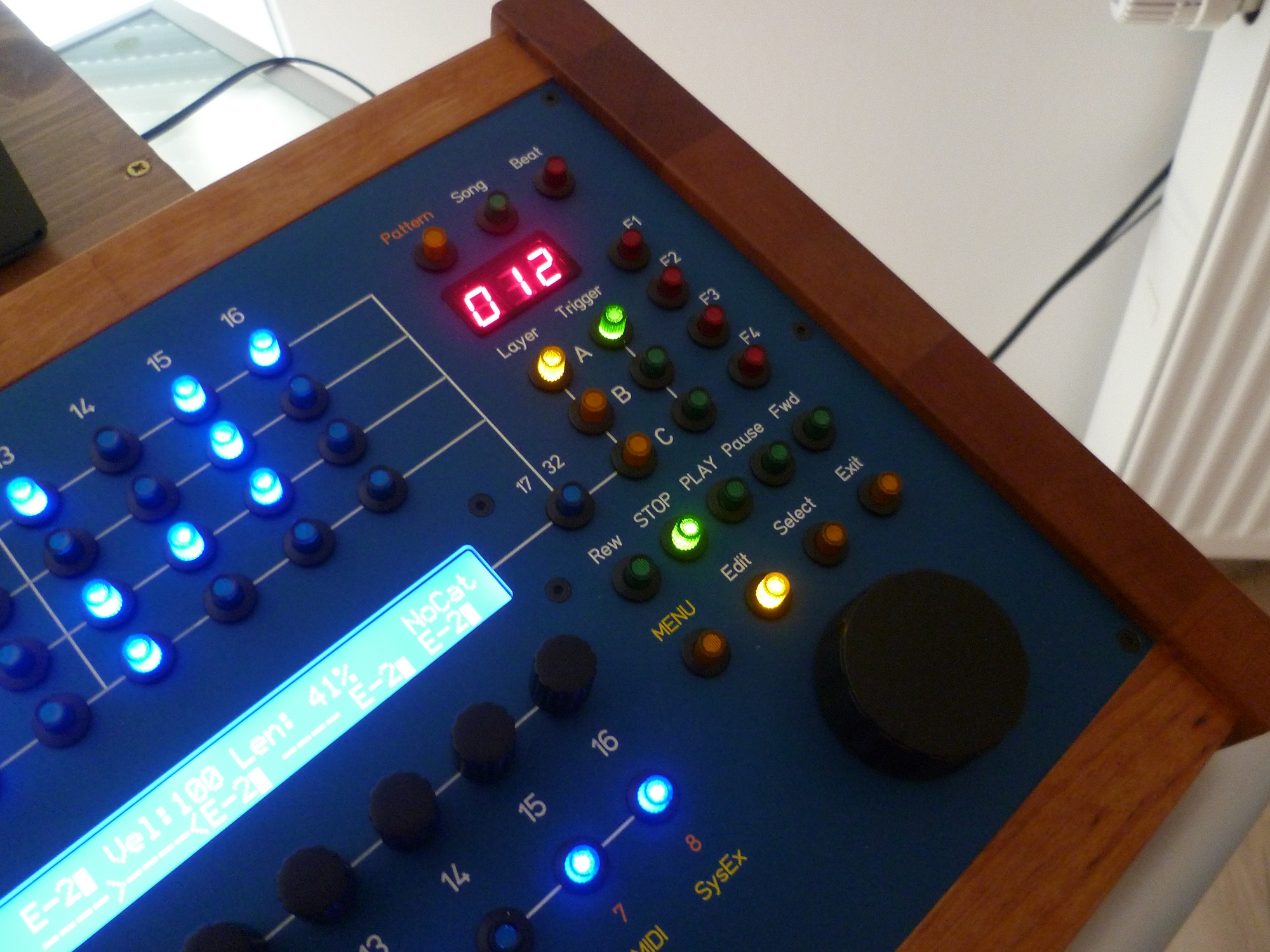

Now after some enjoyable months with SEQV3 here are some new pics from updating to V4 this week:

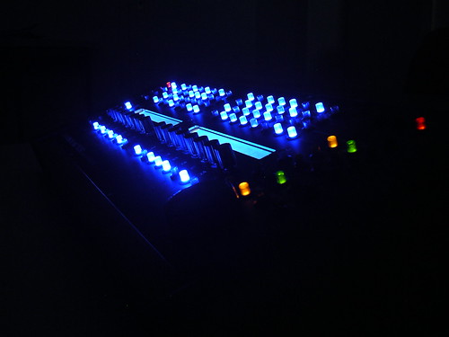

By the way, shortly after I had finished my SEQV3 I changed the resistors of the LEDs as I noticed
that they were much too bright:
I now use:
8,2KOhm !! for the blue non multiplexed LEDs
1,3KOhm    for the blue multiplexed matrix LEDs
470Ohm    for all red LEDs
(for all green and yellow LEDs i kept 220Ohm)
Now all LEDs look equal bright and are gentle to the eye, esspecially the blue ones do not spike out any more, which is clearly visible if you compare this new picture with my older pictures
on the beginning of this thread

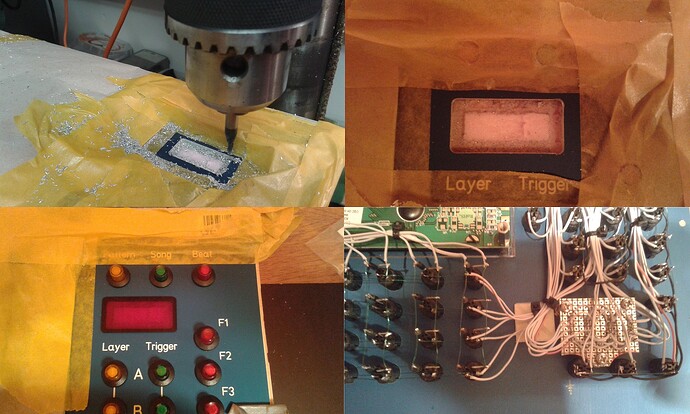

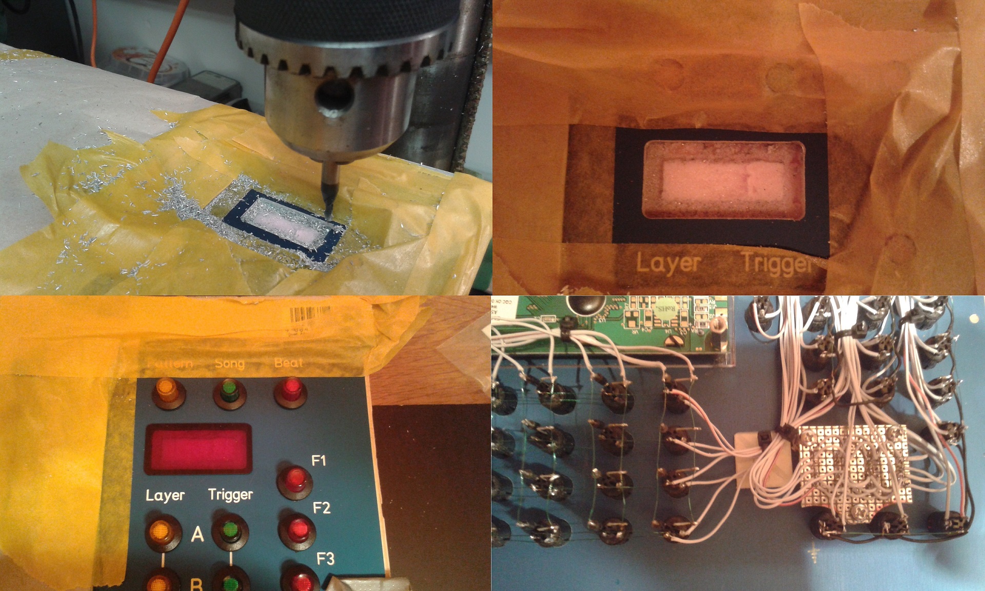

7 years have passed, time to post something new about my SEQ:
Since the optional step digits were released, i wanted to have them  too.
Finally this week I screwed my box apart and put  the frontpanel under the milling machine.
Luckily everything worked well, as same as gluing in the display glas and soldering the protoboard panel for the digits.
Only issue was that the pinout shematic Dout->Digits seemed to be wrong.
Thanks again TK, and everybody involved for this icredible piece of gear.
