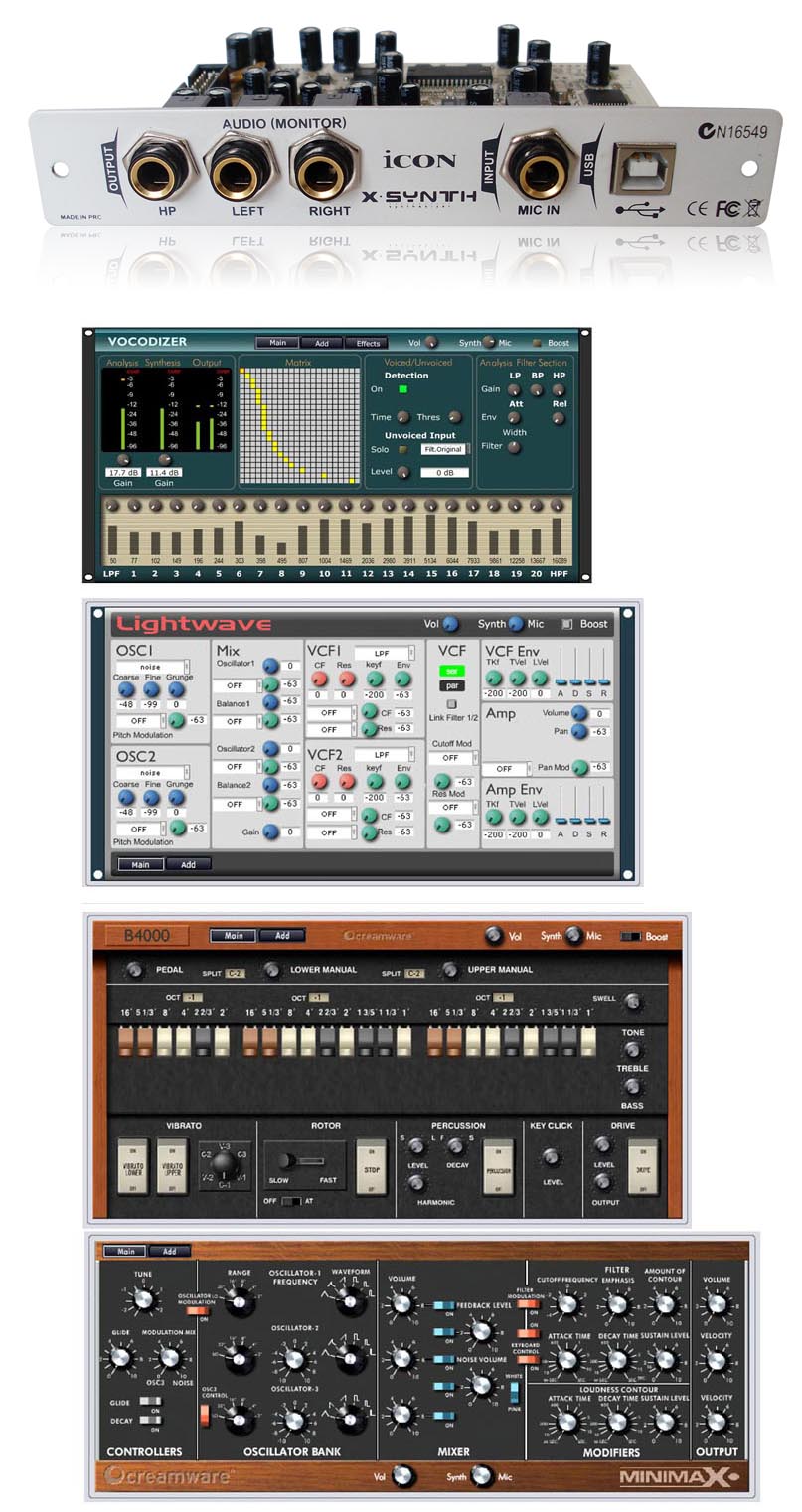

Maybe you still have room for a hardware minimoog DSP emulation board: check the ASX board from Use-Audio:
http://www.use-audio.com/asx.htm
It could save some PC CPU power (the processing is done by the DSP)
It would provide you a good sounding cheap 12 note polyphonic Minimoog DSP emulation (150 €). You will get also some alternative plug-in you can choose to use when not using the Minimax, the Lightwave, a digital synth providing something inspired from the Prophet VS, The vVocodizer, a rather nice vocoder and the B3000 a B3 emulation. Some other plugs can be bought at a bargain price (99 €) including a Prophet 5 and an Odyssey emulations …
Exciting concept but are you sure the the ASX board is stand alone? looks like an expansion card which would require CME UF or VX keyboards.
The ASX is not a standalone board: it is actually a part of the plugiator.
But I do think the ASX can be used a DIY integrated board: from what I know, the other board (3) available in the plugiator are:
  • a controller board for the front panel (a kind of simple fixed setting MidiBox)
  • a MIDI and power supply connexion board
  • the main ASX board (integrating the DSP, the audio I/O and USB)
I will try to request more information from Use Audio …
