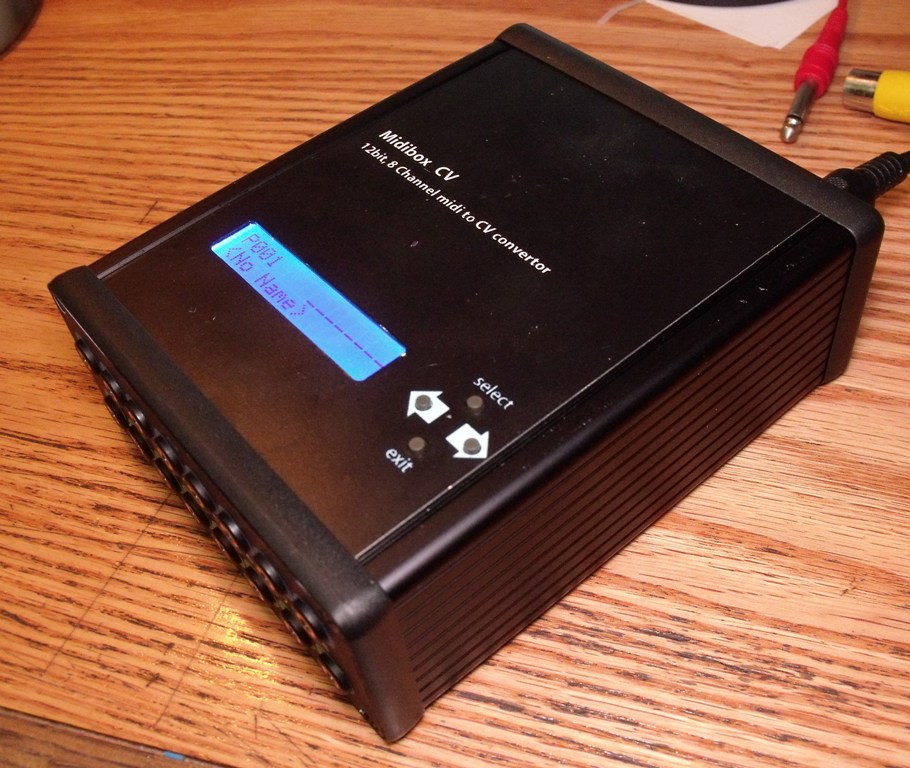

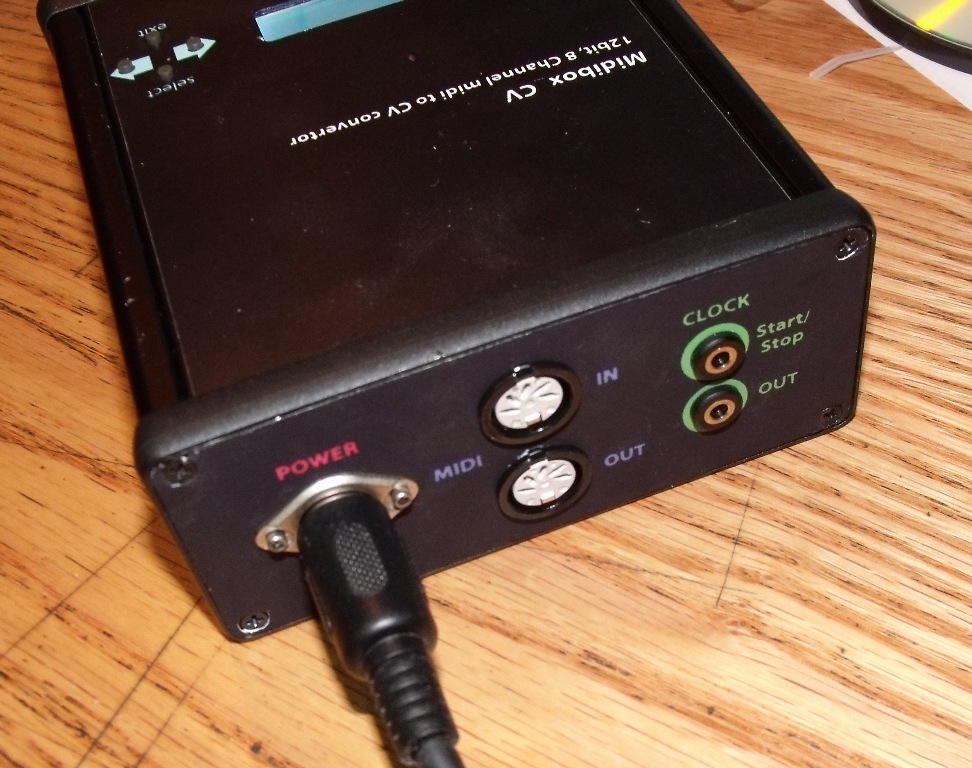

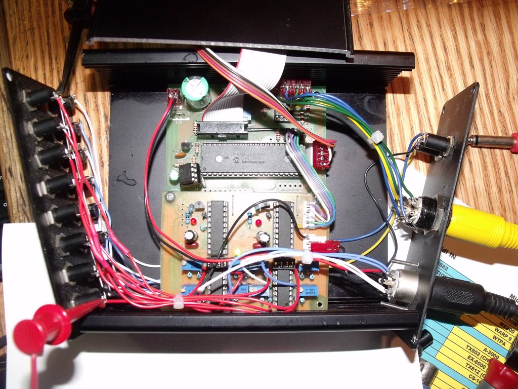

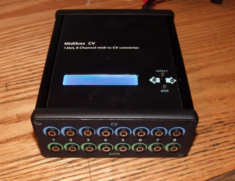

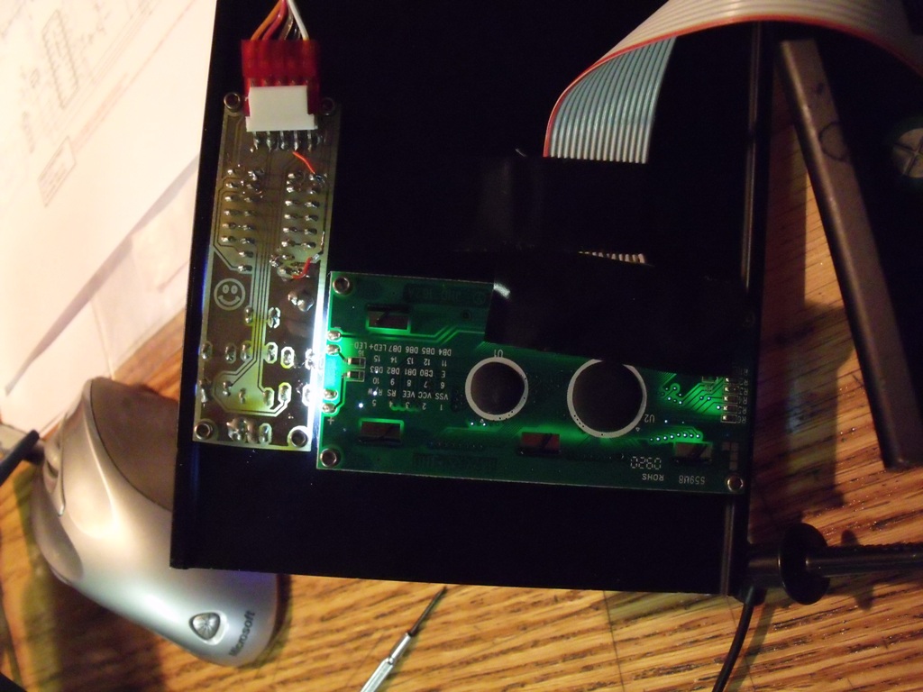

This was a side build that I was working for a long time and finally got motivated and finished this up. This is the MAX525 based CV. I etched a simple DIN1x with tact switches for the controls and packed everything into a chopped Hammond extruded enclosure. I had originally intended to put a bi-polar supply inside the case based on a PCB mount Amveco transformer but even with the original longer case, it was crazy tight for mains wiring so I opted for a regulated Elpac AC adapter which has a 0.6A +5 and 160 mA +/- 12 rails. This solved the space problem (at least in the case, the adapter is pretty big) and actually allowed me to cut the case down for a smaller package. The labeling is self done inkjet printable vinyl. The results are not to spectacular and this was my first go with the stuff. I have had much better results once I worked with it some more but did not feel like redoing this.
Inside:
My DIN1x board and LCD mounting:

BTW, I’m really digging those DIN5 jacks. They appear to be panel mount and have a nice finished look to them once they’re mounted. Where did you get them from?

Those are the Deltron Din jacks (both the midi and power). They are available in black and silver also.
The classic style is used for power (same DIN5 as midi, had to make this not confusing, dont want to accidentally plug my power into a midi port.) is Deltron 16HR635
The round ones are: Deltron 651
Neither of them are cheap but they are very high quality so for me it’s worth it.

The vinyl is this stuff. It is fairly thick but reasonably easy to cut. It sticks like CRAZY though. I used it on my WTPA sampler and made a mistake the first time around and had to remove the label. It was a nightmare to get off, acetone, MEK, heat, practically nothing even made a dent to it. I eventually used a grinder with a stainless steel brush to get it all off. Printing is just like photo paper but it will bleed if you give it too much ink. It comes in white so if you want black, you just have to print in black. A “normal paper” setting on my Canon worked well for me so it was not that hard on the ink. The thing I am not too crazy about is the fact that it is super matte when printed and I have not found a good way to gloss up the finish (tried semi gloss sprays with mediocre results). Also, the trick to applying this stuff since air bubbles are a big problem is to spray the adhesive side with some water with a couple of drops of dish soap. This allows you to slide it around your panel into position but more importantly, you can roll out all the air from underneath it with a roller or squeegee.
