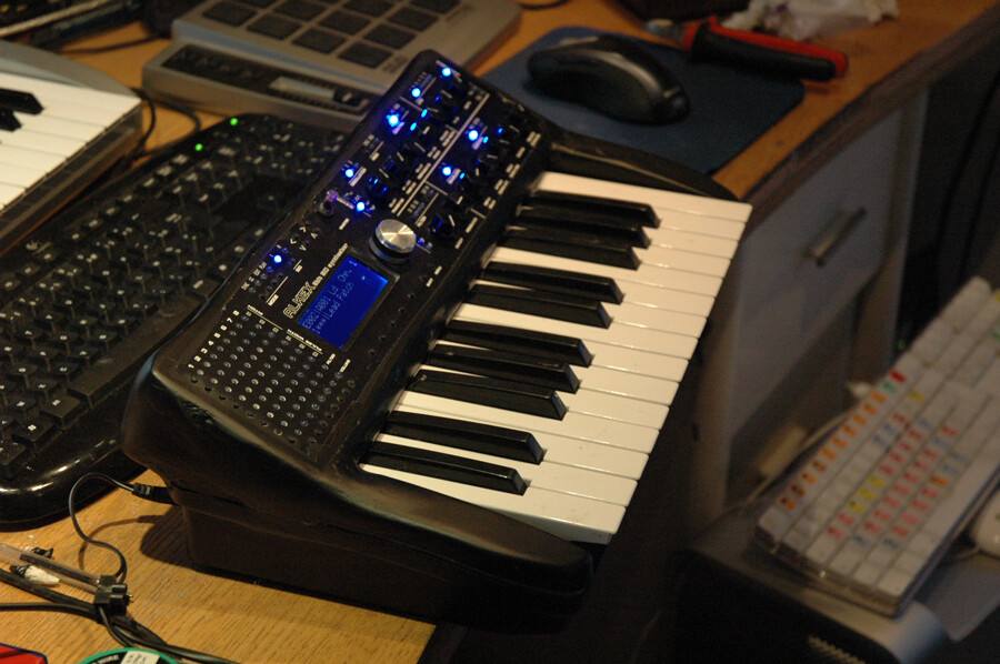

Alkex did it again: after Octopus, he built another great keyboard version of MBSID V2. :slight_smile:
He wrote:
Here is a photo of my beloved midibox_sid, built into an m-audio oxygen8 i found cheap on ebay.
I only have one busted sid (dead filter) module connected for the moment, but I plan to go stereo as soon as get hold of some more chips.
The core handles the midi from the oxgene 8 which happily shares the 12v su=pply :slight_smile:

Hi There,
Thanks for your feedback, Here is a little photo series of the making…
::::::::::::::::::::INSIDE:::::::::::::::::::::
The boards etc where all made from breadboards, very ugly and spaghetti like,
but the leds and buttons line up well and feel surprisingly robust. Lots of hot glue involved, again :wink:
::::::::::::::::::: Outside, Bodywork :::::::::::::::::::::
Here is an Oxygene8 happily sitting there, not expecting to be mistreated in any way…
Same keyboard after a brutality session!
I used cardboard of make a basic “idea” frame, to the size of th panel. Glued with hot glue .
Now came the hard part, I had to smear the cardboard with car bodyu filler (called mastic here in france) ,
and sand the hell out of it (I spent about 3 hours untill my hands nearly dropped off).
i could have achieved a much nicer finish with a few extra hours sanding/filling/sanding/filling/sanding again
But hey, this is diy, and I kinda like the organic feel of it’s imperfections  (thats my excuse for being lazy)::slight_smile:
So here it is, on a glorious almost spring-like day:
The font panel was made 100% in schaeffer front panel designer
Based on Wilba’s design (Massive respect to Wilba by the way!),I had to vectorize the waveform icons

Thank you for posting more photos. I like the messy internals! :slight_smile: This Is one of few ugly but same time very beautiful boxes that I`ve seen here!
I like the idea of modifying an existing case using body-filler (called “Bondo” in the US).

Nice work! I love that you put on the front plate at an angle, so much more convenient ;D
i surely love it within 25key keyboard.
Realised within oxygen8, you had to compromise on Pitch and Modulation wheels  ::slight_smile:
I personally don’t see that as much of a comprimise. With the full control surface, it’s relatively easy to reach over and turn up an LFO, or program a modulation delay into the patch. I rarely if ever use the pitch and mod wheels on any of my synths, but then none of those are an SH09 :frowning:
The best use for on oxygen 8 ive seen yet…  Ace!!!
