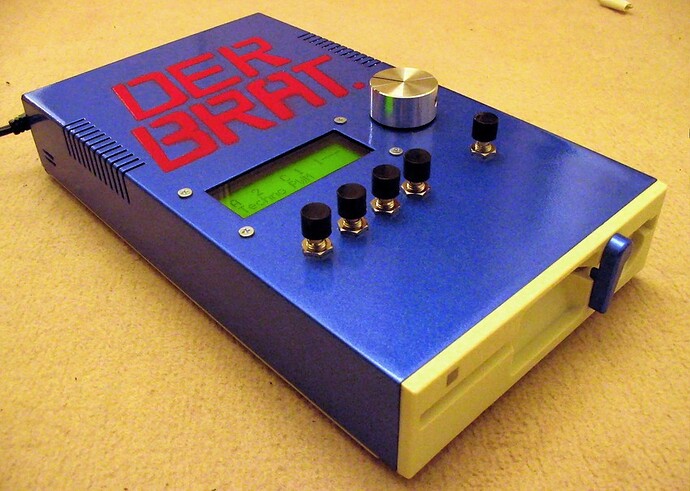

This is the small version “Der Brat. 50” - the ideal mobile solution for jamming together with friends :wink:
Seppoman wrote:
Here´s the new MB SID I built: A little brother for the “Der Brat. tausend.”, called “Der Brat. 50”. Main goal was to keep the box as portable and cheap as possible, so I built it into the case of an old C64 floppy, used only the Step A surface with an old 2x16 LCD I had left over and even didn´t use premade PCBs.

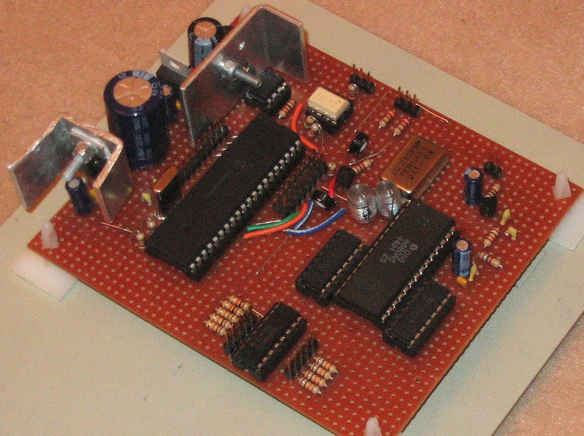

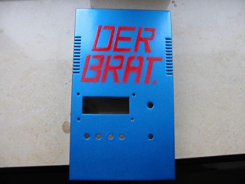

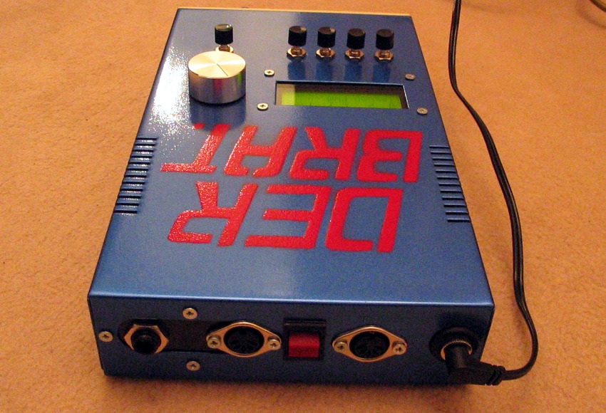

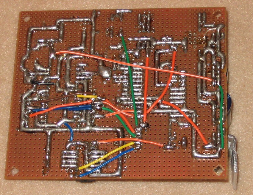

You can see I built everything (Core, SID, DIN_X1 and BankStick) onto one vector board. The power switch is the old one of the floppy drive. The access LED of the drive is used as Midi In LED :slight_smile: . The metallic blue paint was very time-consuming - I had to sand it down and start over several times because of too much dust, too much paint, touched the thing too early etc… So I needed two cans of blue and 1.5 of clear paint. Without this waisted paint the total cost (not counting the display) would´ve been around 40 Euros.
Great job Seppoman..  great case idea, grat paint job, great PCB/protoboard work.  Heavy duty soldering!! : )    I like the stencil, and the knob/button choices go very well with the overall look of the device..  Theres actually alot of room inside, it looks like you could put two or three SID in there! (or half of a control surface!

the case is absolutely fantastic!!! :slight_smile:
great work
Actually there´s not so much room inside for additions - above the board there´s only about 15 mm of “usable air” and below the display about the same. The case is just 4 cm high, way smaller than a 1541 floppy. If there would be a board below any CS items, everything would get very crowded inside.
A second SID is not needed for live performance in my opinion, and the CS can´t ever be the full version on this size, so this box is not for creating sounds via CS but only for using them anyway. I briefly thought about at least adding the filter section of the CS, but the encoders/buttons/LEDs would need another DIN_X1 and need to be placed on the free front portion of the case. But a good workaround for live use is to route the filter cutoff to the MOD-wheel of the keyboard. I also wanted to preserve a bit of the floppy disk look, and a disk drive with 30 crowded knobs standing out of the top would just not look nice. I´m a friend of clear simple designs, as you can also see on the Brat 1000 :slight_smile:

How the hell did you have the patience to make the vector board??? Nice integration of the circuits there!  ;)
Thanks - it gave me quite a headache to get all the connections right, two very long nights of soldering and thinking. But I think it´s also quite rewarding to do this by hand one time, because you can more physically learn to understand how everything is interconnected and how it works. But I won´t do this again, one time is enough :wink:
