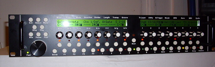

Julien has finished his great looking MIDIbox SEQ V3. It fits into a 2U case!
He wrote:
thanks a lot for seq v3, it is pure craziness !

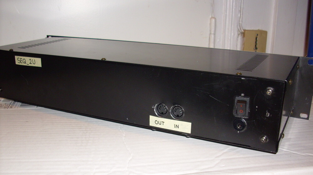

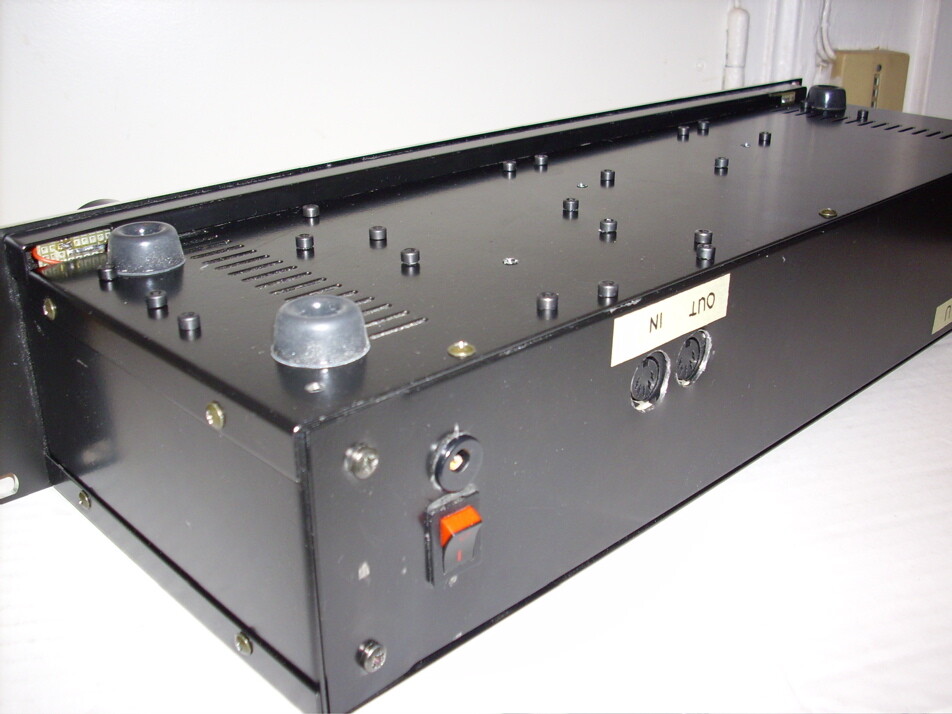

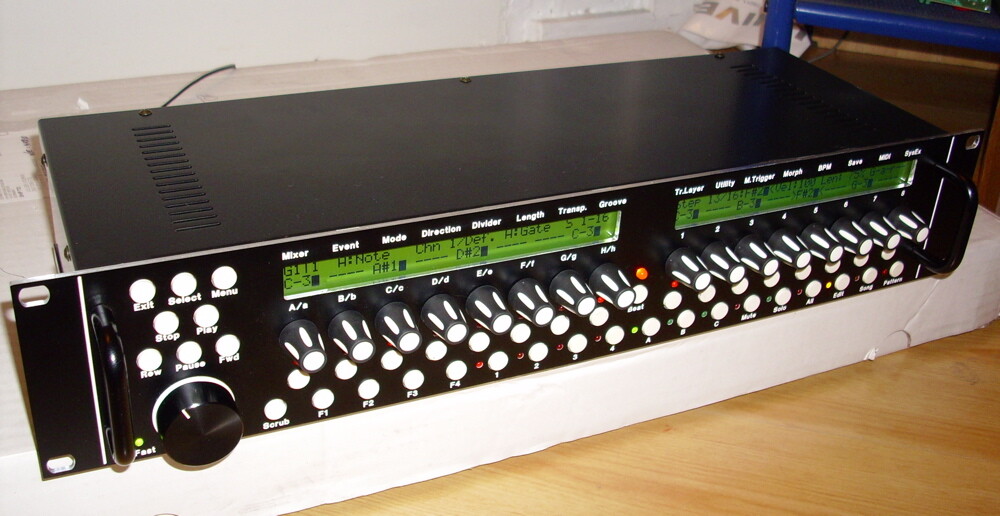

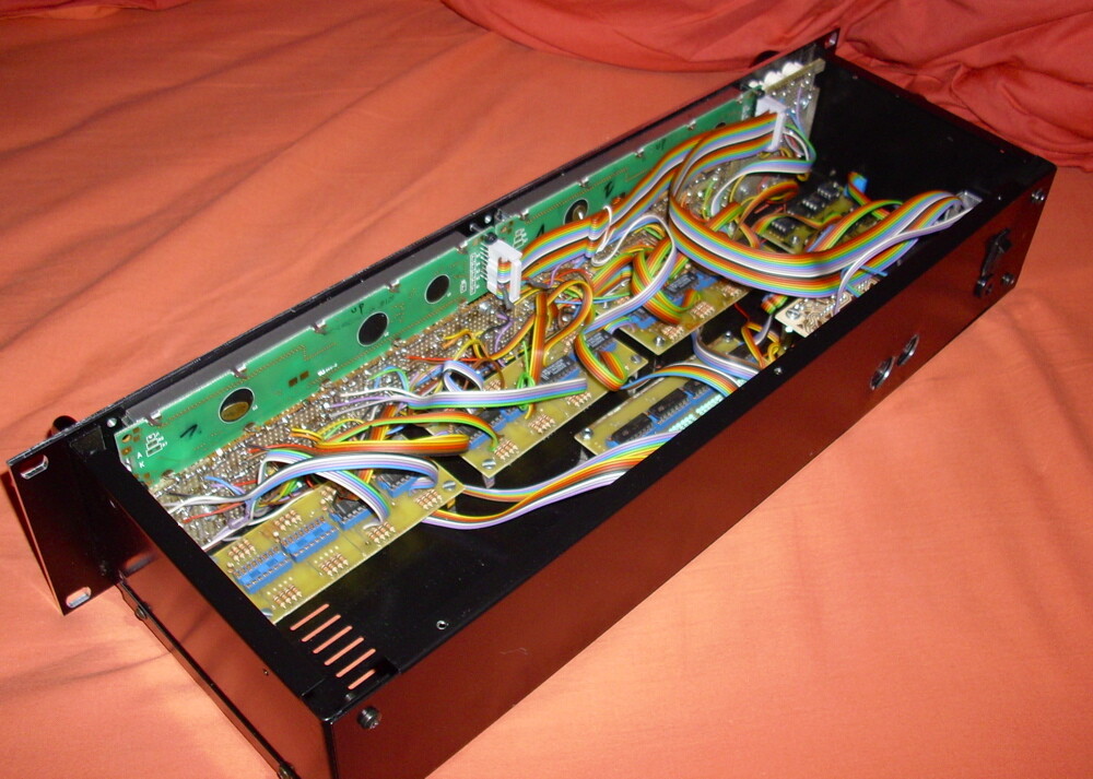

Here is the 2U rack design i did cause somebody gave me the enclosure.
Notice there is not a lot of spaghetti, obvious i did the panel on veroboard(!)
All PCB were produced by my little hands in the school lab last year, most of the compounds were offered too. The panel is Schaeffer (150€ !).
Total cost : 250€. But lots of reflexion before soldering or drilling or cuting with the dremel (very long and very crazy to cut all the enclosure)
I also join the schaefer panel if someone wants to copy it.
Frontpanel Layout: http://www.midibox.org/users/julienvoirin/Seq_2U_CADv3.1.1a.fpd
That’s one professional looking case ;D Great layout on such a “small” panel! Very clean inside as well, great job!
Félicitations Julien!!! The implantation is so clean and there is a lot of space to add modules :wink: Impatient to see it in real!
Best regards, Didier.
Excellent! Congratulations Julien!
Great panel layout… threaded blind holes on the reverse side is a great idea!

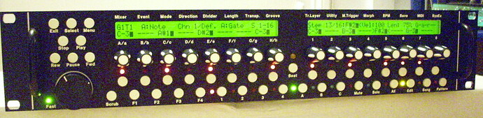

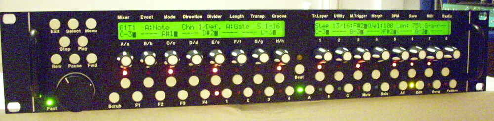

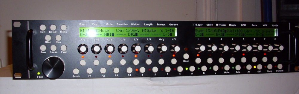

Something else about the LCD : as i am playing with the SEQ_2U since yesterday, i noticed that a shifting of the screen of 3mm on the right (and of course the holes on the back side of the panel ) is very recommended , in order to get the values better aligned with the buttons (especially this Note length gauge).
Yes there is still some place inside. The rack is the smallest i could find ; i hesitate to saw it, but 15cm depth is cool.
The hardest has been the drilling for the MIDI Jack : 16 mm !!! with a f*****ng low cost driller and some “huile de coupe” to avoid heating and my weak arms. The Dremel is the definitive tool to get, a friend let me his one.

whaou lots of questions. I should have take a lot of pictures, but taking pictures while you are dremeling is not a good idea. I prefered not loosing a finger.
So :
I know what a dremel is but could you explain what you used it for on your box.
a Dremel is a small driller. i used it to cut, through a cutting disc (in fact i used 6 marron, and 3 black, and i really reduced their original size, because of the roughness of the steel). At the begginning, the rack had edges that went where the LCD are now. So i had to cut. In the meantime, the size of the box is smaller than the size of the panel. So, the second line of buttons must go through the down panel ; i then have cut again with my friend dremel.
I also used the dremel to cut screws needed for fixing the spacers on the back of the frontpanel.

i know this tool. But it is expensive (75€) and need a driller with a mechanical arm. For drilling, i only had my low cost driller (a Bosch at 20 € in Carrefour that don’t even accept drill superior to 10mm in diameter) and a piece of wood to avoid making a hole in the ground.
question about your veroboard.
it is 3 classical vero (maybe 3-5€ in shop) assembled together with soldering and leads of resistors (!!)thanks to the placement of the spacers, everything is super strong.
I also had to grind the Voti encoder, because they had a noze that was not compatible with the placement (the head of the encoder in the ass of the next)
And about shifting the screens.
the screens are shifted because you shift the holes on the back of the frontpanel. the windows stay at their place.

no visible screws!
yes, an advice of reboot from the forum. i know him normally (i mean i already shacked his hand :D)
the frontpanel has a 3mm thickness, so you can use 2mm holes, placed on the back. Then you can ask to Schaeffer to format them for M3 screws.
i love this solution.
can i ask you  witch is the risk to brake the screw lines of panel turning the screw too much? aluminium it’s not so strong in this way.

there is no way to break the panel if your are tiny. and because you screw the cutted screw with your hand you can’t have enough force to break. moreover, the screwhole isn’t complete ; Schaeffer can’t mill the all hole : they need at least 0,5 mm free.
So, on a 3mm thickness :
2mm milled
0,5mm free
0,5 mm of panel
The case was bought at Selectronic
I think these holes are only really suitable for light, shallow racks. Keeping in mind that the rack front panel supports it’s entire weight, if your kit was a big deep heavy unit full of hefty analog like transformers, it’s not a good idea…
I dunno man, I’ve stripped a lot of threads with my hand in my time :frowning: It’s easily avoided, except when the screw must be tight, like this. There’s also the risk of screwing the bolt in too far and going right through the panel - 0.5mm is not much metal.
But for this light box it’s no problem and looks really pretty!
