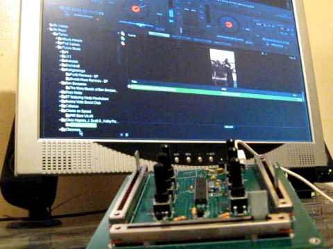

MIDIbox of the Week (MB64E based Traktor Controller made by PayC)

@TOS: I tried out different sizes and for me personally I really have the optimal size. Not to big, not to small. That´s the cool thing about DIY. Love it…  :wink:

But I really think that the BIG difference in those two boxes only lies in some frontplate design. Just use the same stuff as I do (some sort of self-adhesive inkjet-printable overhead foil) and voila -> wonderful frontplate designs! :slight_smile:

Its too obvious, ill have to fill up that space… but i dunno where to find big round spin caps..
And i wasted so much time on that plate, its brushed aluminum 6 mm thick and now i want to change layout (too late).. and the worst part is that  its giving me hard time implementing the buttons… i have 40  9x9 mm click buttons and I dont know ow to put them… Tryed glueing with epoxy but they refuse to hold after few clicks.. :frowning:
You know what? I didn´t have the slightest clue where to get those spin caps, too. So I did them myself! I misused some “normal” knob as a base (especially the screw holding the stuff to the pot/enc shaft is important). The outer stuff is just a plexiglass plate (satiniced) which was roughly brought into shape and then attached to the drilling machine for grinding it exactly round (so I misused the driller as a turning machine). Tadaaa! Spin caps! :slight_smile:
Are your buttons PCB-compatible? Then you could solder the buttons just as normal to the PCB and attach *THE PCB* to the frontplate with some screws. I do that always and it works out pretty perfect (especially because you save a LOT of screw holes).

how do you satinice your plaxiglass ??
I’m looking for a good possibility to do that.
MfG Christian
am besten mit 1000er Nasschleifpapier :wink: *geheimtipp

I ordered the Plexiglass already satiniced (cause there´s nearly no difference in pricing). If you want to satinice it afterwards, like MTE said: Just some grinding paper (rough at the beginning going in big steps to finer papers) and circular motions will do.
Greetz & good luck!
sand blasting works quite well too! do do lots of tests on waste pieces with various grains sizes first though!
