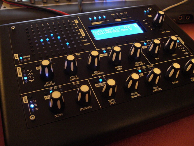

here is my MB6582 midibox :

the front side :
Congratulations JV, it looks great!
Very nice!
People commented that they expected the ALBS knobs to be bigger but they look perfect to me.
The mis-aligning of the labels on the fron-panal doesn’t look to be too much of an issue once the thing is put together.
I think we’re oing to have an aweful lot of Wilbabeasts appearing on here in the next few months.
they are too big, it is hard to easily go pushing buttons
absolutly no problem. more problem with the leds holes which are often too small.

I wonder how they’d look if the bottoms were sanded down a bit? Obviously they couldn’t be made much smaller because of the fairly large holes in the panal. I may get some spare knobs in the next order and investigate this… Wouldn’t want to wreck the translucent red ones though  :-\

Nice work JV. It looks very close to mine, the only difference are the knobs. I used the clear ones. I think we should start a thread where everyboy that has built a MB6582 can post his picture. So we can easily compare the boxes with each other.
