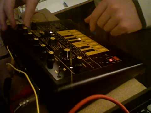

<object width=“425” height=“344”><param name=“movie” value="
name=“allowFullScreen” value=“true”></param><param name=“allowscriptaccess” value=“always”></param><embed src="
type=“application/x-shockwave-flash” allowscriptaccess=“always” allowfullscreen=“true” width=“425” height=“344”></embed></object>
Midi for the TB-303:
http://www.colinfraser.com/mb303/
:slight_smile:
