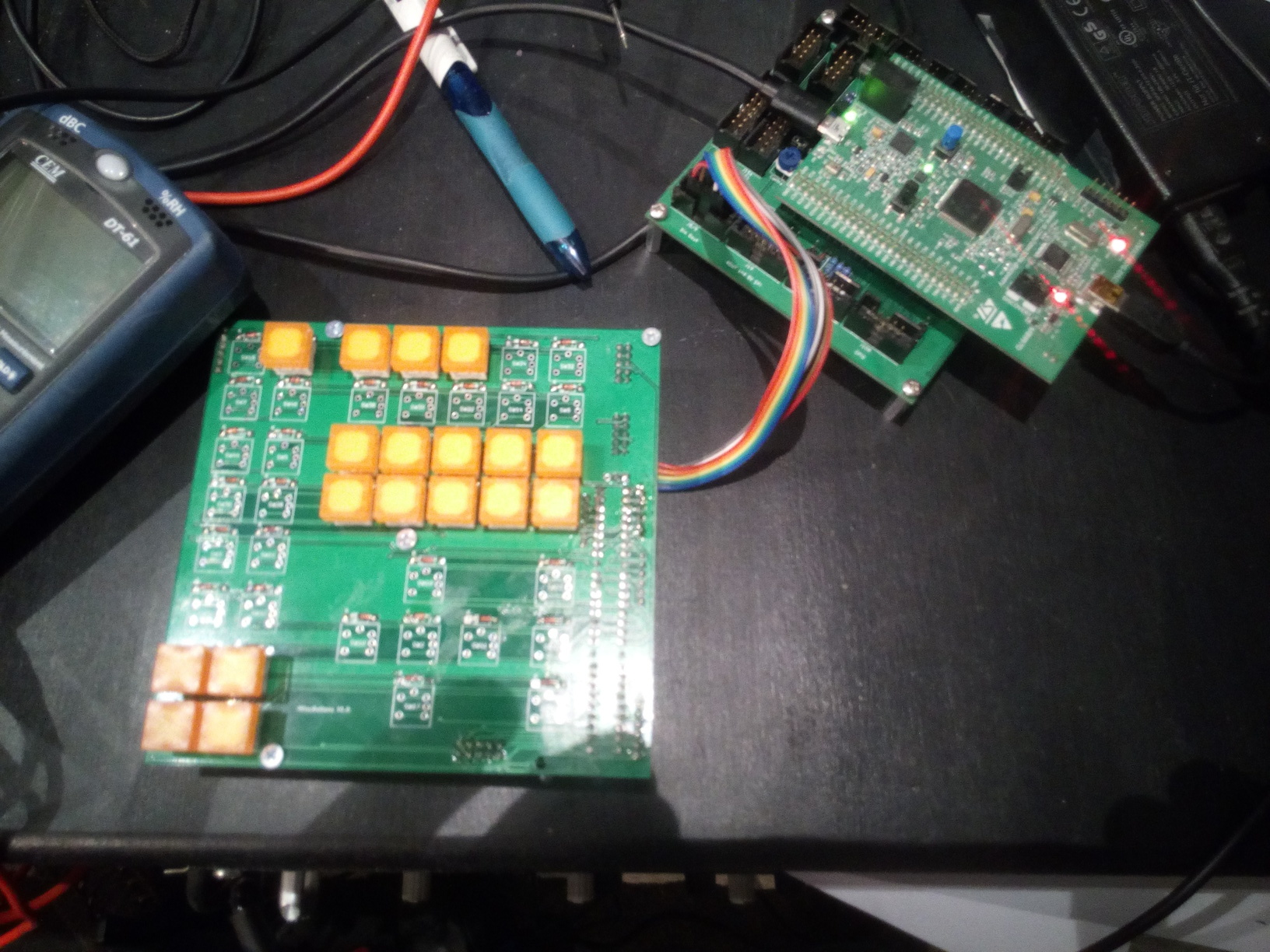

I’ve received my first PCB along with some switches, and it works quite well (see below)
More switches will be coming in the near future, but for financial reasons, i only ordered one color.
I also ordered a few samples Oled screens from aliexpress. Unfortunately the first ones were I2C only, so i didn’t manage to use them. ordered some new with SPI capability, but i don’t expect them before christmas.

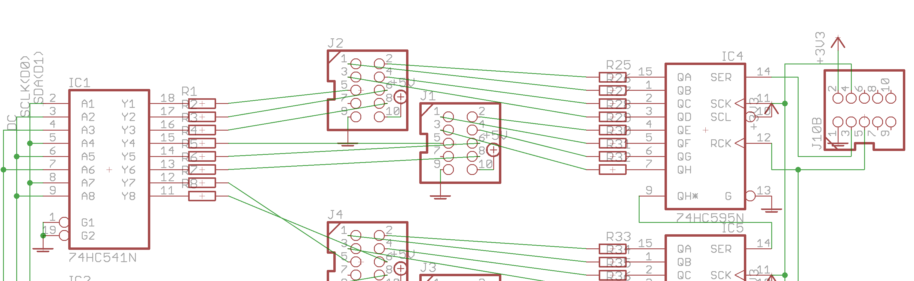

as i was writing this post, things finally got to work! I’ll still put my troubleshooting here for future reference, with corrections in red. Please anyone, correct me if i’m wrong
I’ve been playing with my screens on a breadboard. I wired a 74HC595 to adress screens 9 to 16 as in this schematic:
I assumed QA has to be wired to screen 9 CS pin, QB to screen 10 etc. !!! as in Dout modules, outputs of 74HC595 seems to be  “reversed” ie: QH is screen 9 and QA is screen 16.
So far, it’s not been working as intended. Both screens display the same text as if they are enabled all the time.
I put some leds in parallel with CS pins, to see if they blinked and they did NOT blink when changing display. (as it should in normal operation).
So i wired my analog scope to monitor SCLK, RCLK and SER signals, and figured that there was no SCLK on pin 4 of J10B.
Finally i found a “solution” (more of a workaround really) by complete luck. I just changed the number of oled declared in the bootloader from 16 to 64 and TADA! now i can monitor an SCLK signal and screesn are working as intended.
I tried to go back to 16 lcd , and it doesn’t work anymore.
Tried 32 screens… it works!
15 screens ? doesn’t work…
17 screens? it works.
It seems to me there’s a bug with J10B port not initializing correctly when the number of oled screens declared is <17.
