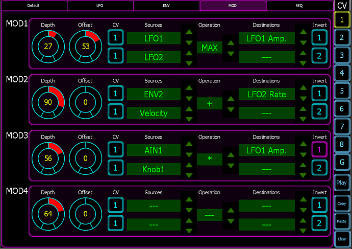

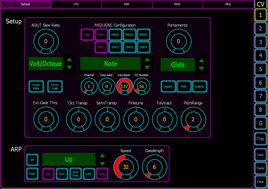

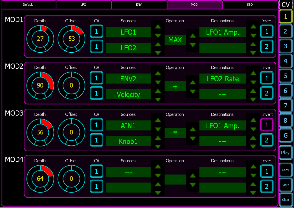

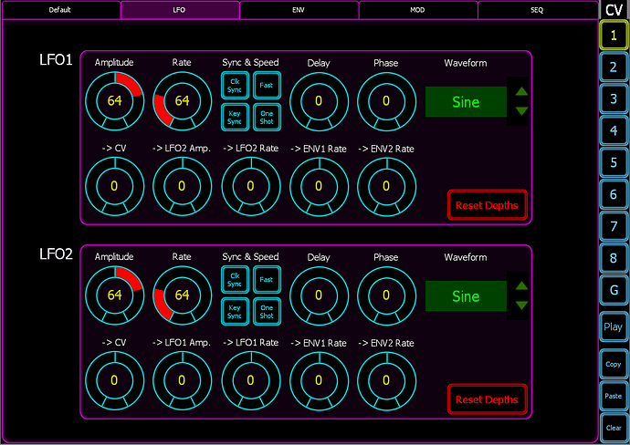

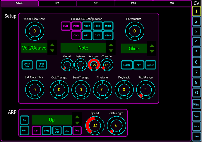

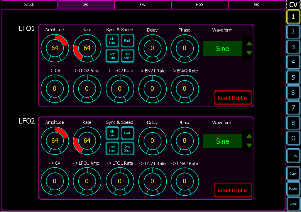

Here the first “mockups” - not for the physical control surface, but for a SW based editor :slight_smile:
Next step is to establish the communication between Lemur and MBCV, so that I’m able to test the parameters.
Note that the modulation matrix will allow to pass a value of a certain channel to other channels.
This means for example: LFOx of channel A can modulate channel B (and C!) regardless what kind of electrical signal they are controlling!
Best Regards, Thorsten.

I don’t think that a good control surface is crucial in the first place - maybe so for the bulk order type of guys, but for me it would be more important to have a full MIDI implementation, i.e. that every parameter can be controlled via MIDI, and that all current parameter settings can be requested from a remote device over MIDI. This way the sound processing and the control surface could be kept separate. I could use my Mackie C4 to control that thing, or I could build an Access Matrix programmer clone, or whatever control surface I like the most.
You are totally right, therefore I’m starting with a “virtual control surface” this time (in distance to MBSID V2 design where a HW based control surface was already available), which forces me to keep the parameter handling simple!
All parameters can be controlled via NRPN messages now.
Bidirectional communication is supported as well - means: by sending a special NRPN message, all parameters will be dumped out.
This works fine with Lemur, and I’m sure that it will also work with ctrlr, Max4Live, etc… all those modern PC based controllers which allow perfect DAW integration :slight_smile:

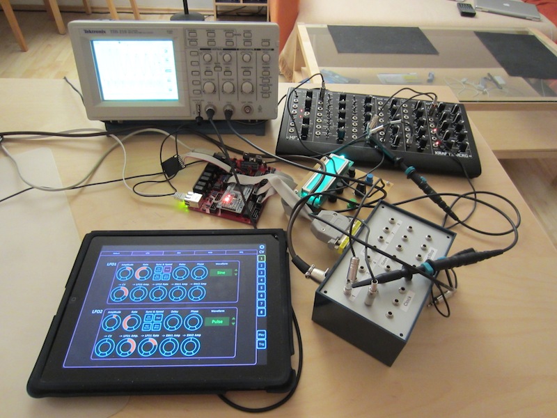

A snapshot of my workbench (reduced cable set!)
A scope is very helpful for debugging - and depending on modulation settings it shows very nice animated pictures (not part of this photo)! :ahappy:

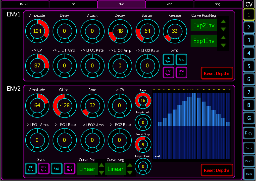

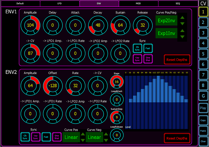

Update: the envelope generators got a Fast and Oneshot option.
I also added an Offset parameter to ENV2:
This results into an alternative usecase: ENV2 can be used as a configurable LFO - just “draw” a waveform and listen to the result!
By syncing ENV2 to MIDI clock, you can even “draw your rhythms” :slight_smile:

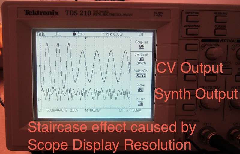

Here two audio examples - I used extreme settings to demonstrate the difference, please don’t expect nice sounds :ahappy:
Filter modulated via ENV2:
http://www.ucapps.de/mp3/midibox_cv/mbcv_env2_demo1.mp3
  • 0:00 slow modulation
  • 0:07 added a spike
  • 0:11 and another spike
  • 0:21 disabled curve
  • 0:27 enabled curve again
  • 0:35 now a bit faster
  • 0:40 and even faster
  • 0:48 much faster! (sounds like my good old 4800 baud modem!)
