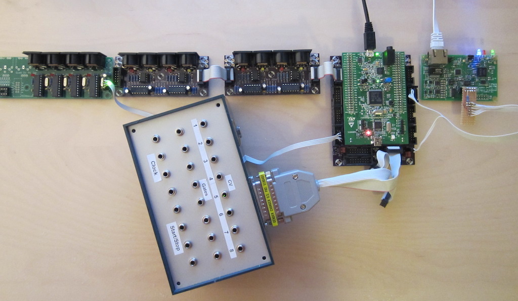

Did you also consider, that STM32F4 has already 4 MIDI OUT (and 4 MIDI IN) ports in conjunction with the two (upcoming) MBHP_MIDI_IO boards?
(Ignore the RTP MIDI extension at the right side, and IIC MIDI at the left side…)
This might be the best solution. :smile:

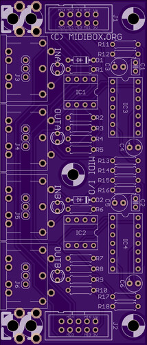

Upcoming midi_io boards… Tell us more!

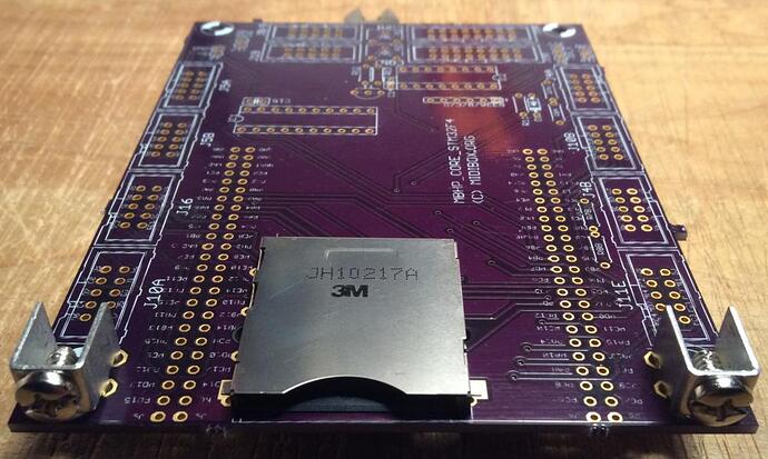

Preliminary version, has a couple of changes since this:
http://www.ucapps.de/mbhp/mbhp_midi_io_orderlist.txt

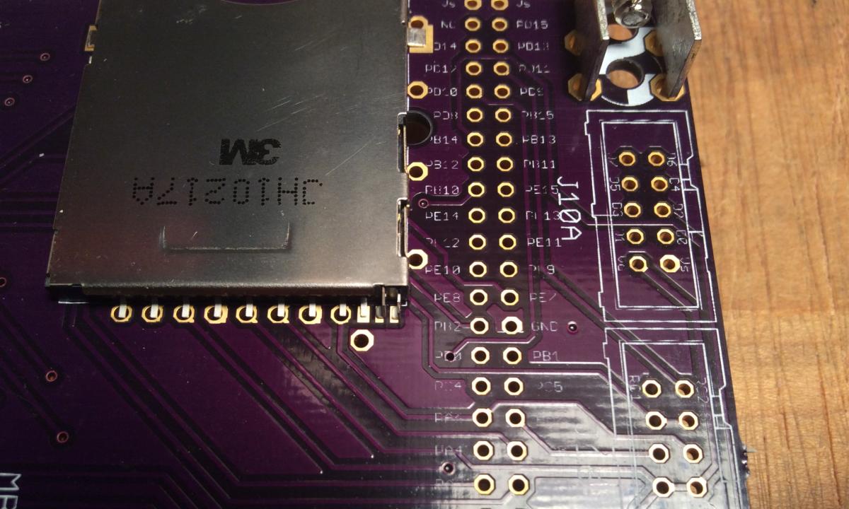

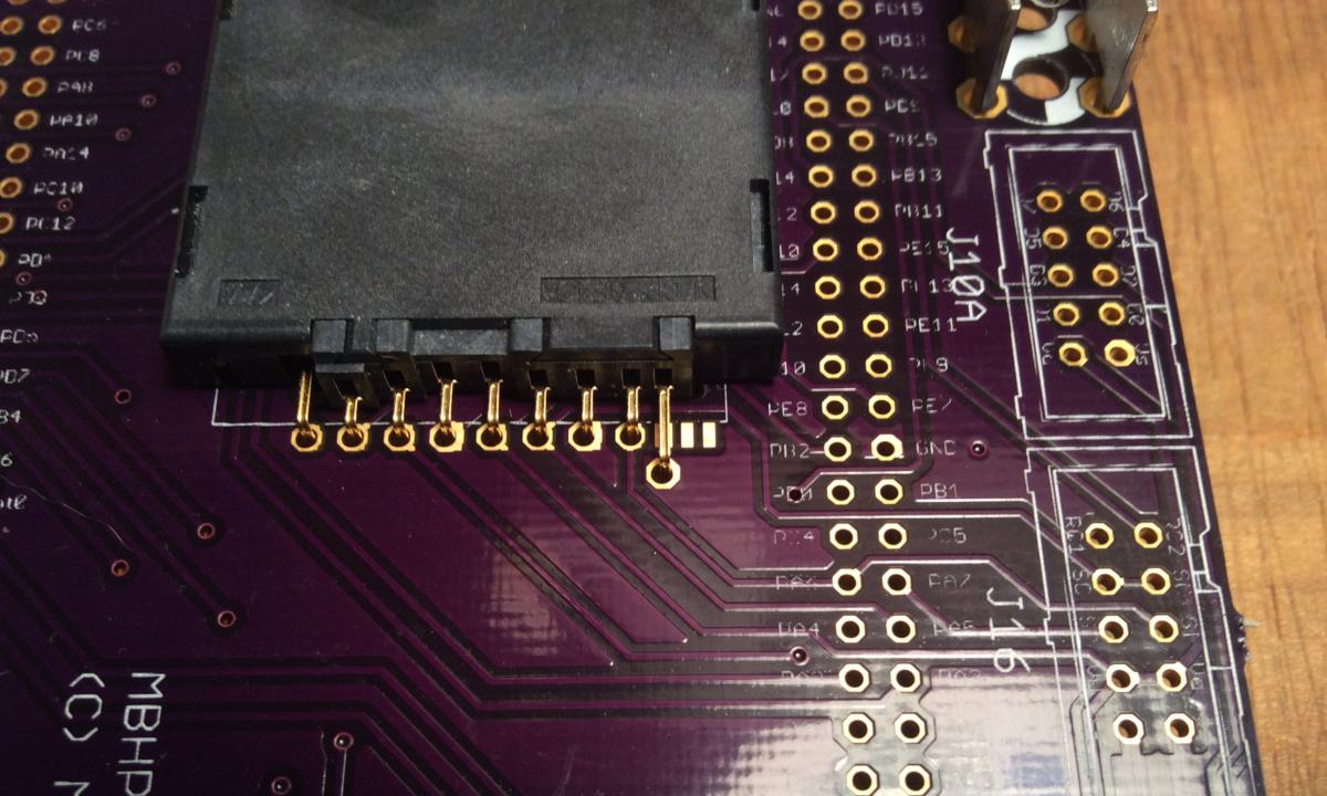

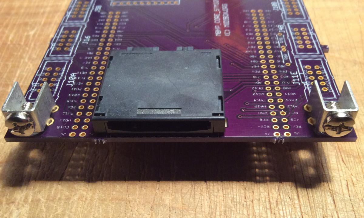

Tim: The new SD slot looks good.
I’m testing the beta core you sent TK and everything is working perfectly here.
This trough-hole SD Card Connector is wonderful! Where can i get that?
Yes, any supplier information available?
I even wrote Tim on facebook but i didn’t get an answer… I was not able to find a suplyer…
