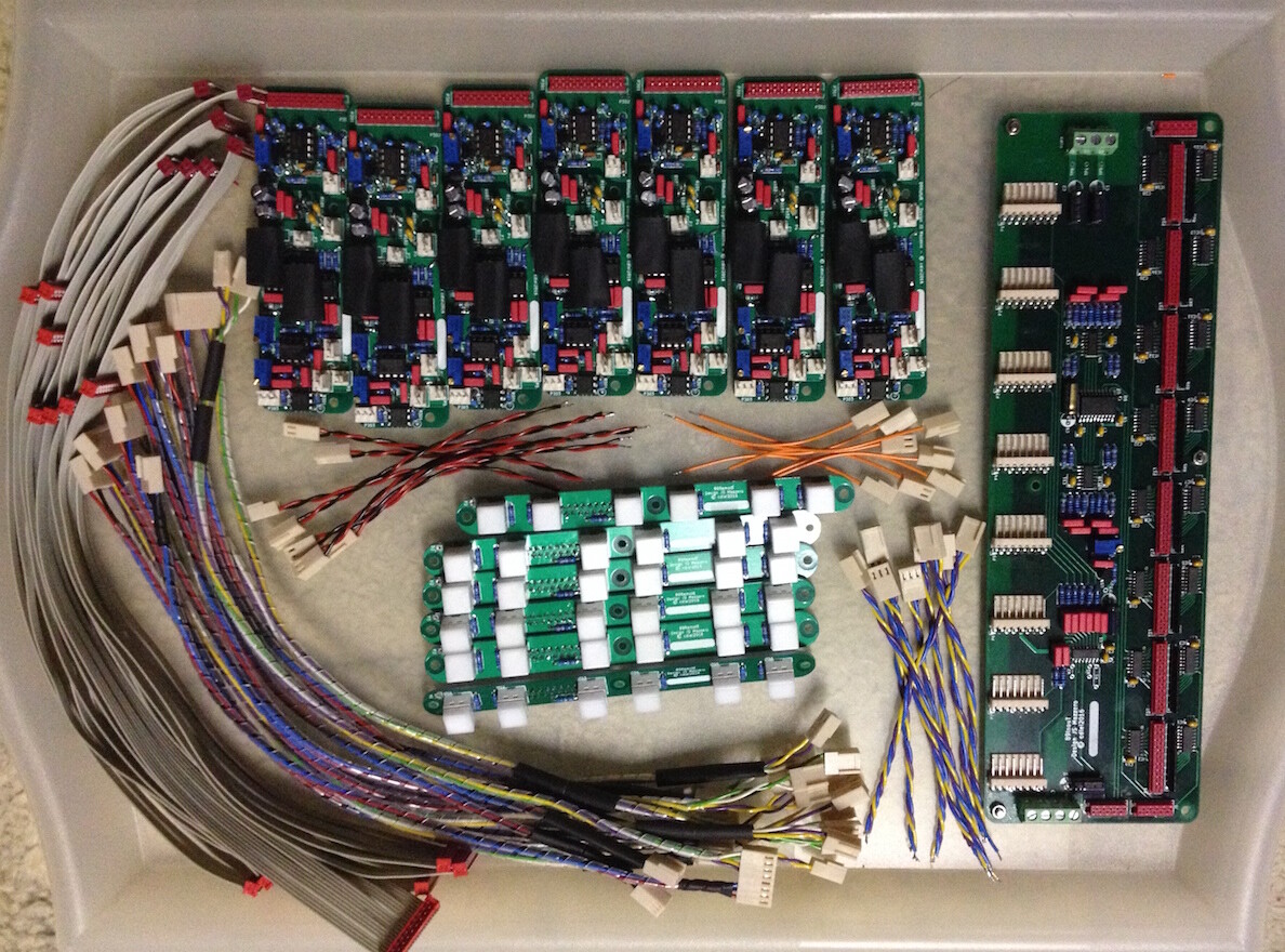

It consist of 17 pcb to build a 8 fader pack automated motor fader system as follow:
-1x 89InouT, 4 layer 80*260mm pcb, which handle 64 D i/o and 8 A i/o, connection to 8 89MotoR board, connection to core(or line receiver), and optional D i/o chain connector, and power supply distribution.
-8x 89MotoR, 2 layer 34*116mm pcb, which handle analog PID motor driver, touch detection, one optional isolated digital output (optocoupler), one optional digital input (button), 6 D i/o through connector from 89InouT to 89 RemotE
-8x 89RemotE, 2 layer 14*148mm pcb, which support up to 6 omron B3W-9 series illuminated tact switch.

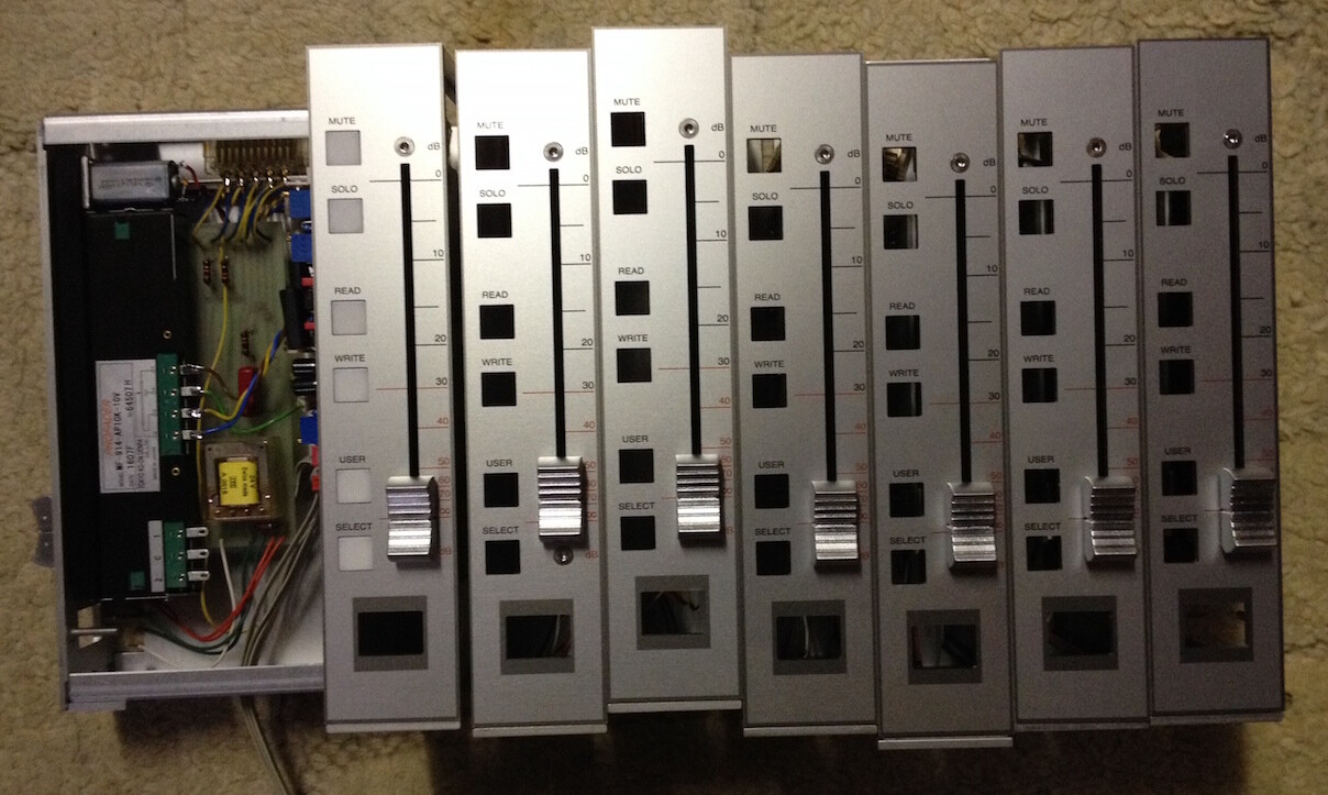

Hi
Here is how it look just before final assembly
Best
Zam
