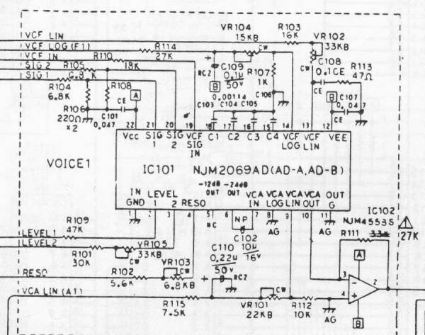

The DW-8000 Service Manual page 22:
The DW-8000 is in POST config.
The VCA is after the VCF Two VCO come to SIG1 and SIG2.
The Noise Circuit is directly applied to VCF In.
The VCA Input connected to the VCF 4 poles output.
The VCA Output is the output of the filter stage.

Precious information found once prototyped.
The SIG1 and SIG2 has inverted signal audio inputs.
It seems all VCA cells invert the signal, then same thing for the VCA part.
? It will need some OP AMP, this is sure now…
Two  Inverter OpAmp, one for each SIG input.
One for the VCA
We can observe in DW-8000 and DSS-1 Service manual that the VCA output has already an Inverter OpAmp Stage.
I did the same, I suppose original circuity respects the internal output Impedance.
LOG CV Input of the VCA seems unusable.
I’ve got only some NJM2069 BD for spare then I used the D version present in my EX-800 to test Log CV of the VCA in the 2 versions, and it appears to be definitively not usable for both!
Maybe some other version (AD, DA…) of the chip release this function. I don’t know.
? But I respected and reproduced the two different existing circuit. This pin is to ground in DW-8000(AD)/EX-800(D) and acts as a kind of bias(?) in a DSS-1(BD).
