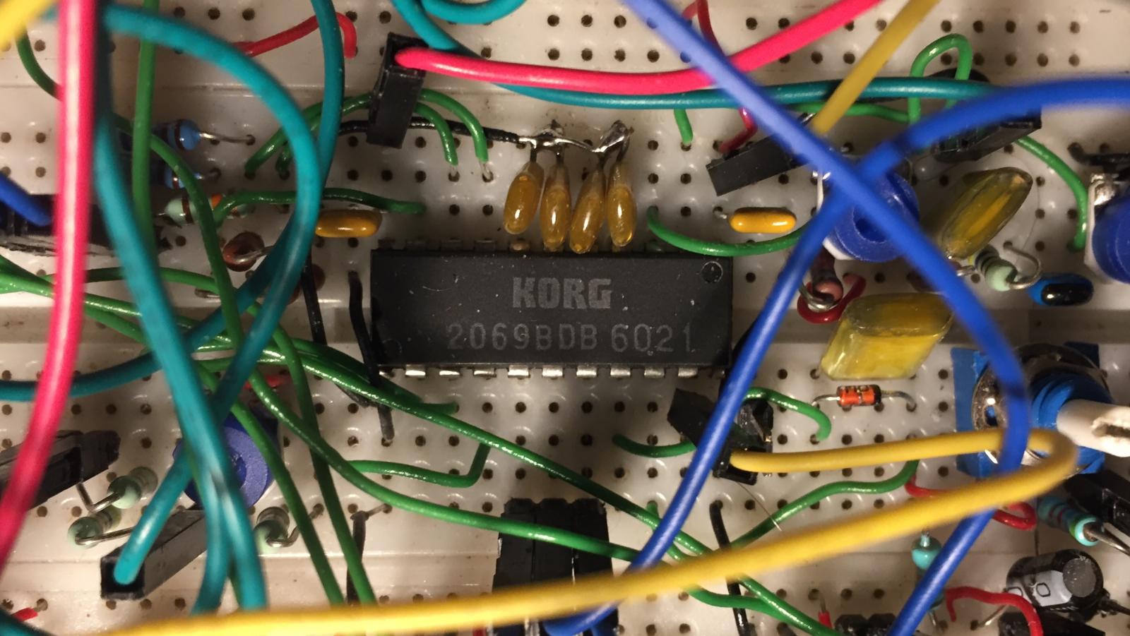

NJM2069
NJM2069 in a cable jungle!

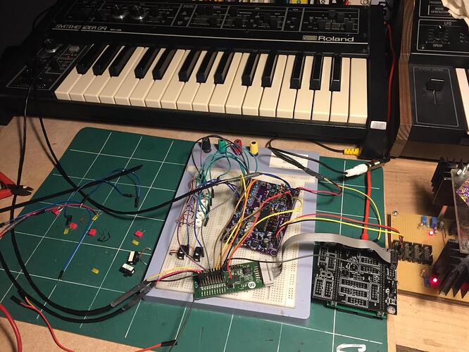

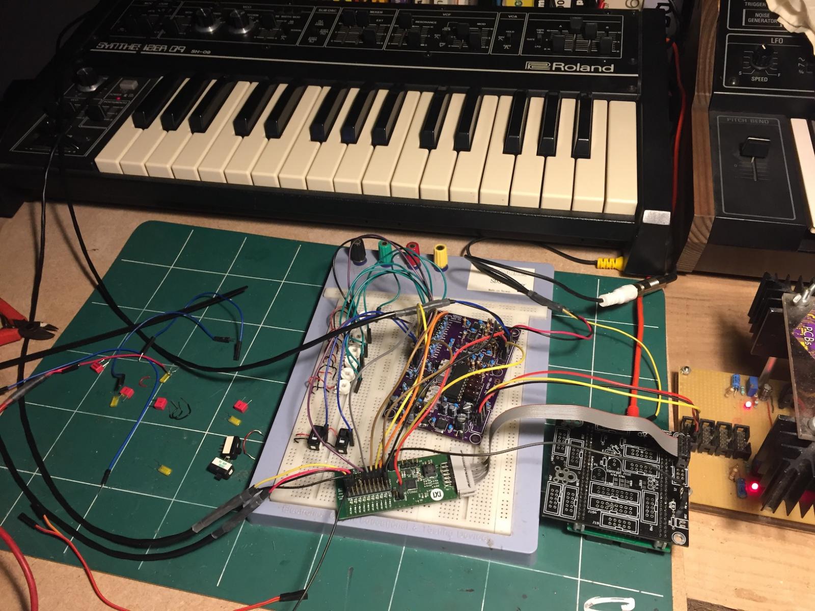

MIDIbox 2069 - Proto, testing Analog and Digital Controls
The source is a SH9 in amplitude HOLD mode, then continuously generates output.
Some trims are used to modulate the CV inputs of the board.
The Core is Andy's new one. It controls a PIXI to get configurable CV and Gate outputs.
The PIXI is a MAX11300 and is a weapon of choice, have a look if you don't know it...
For now, the PIXI drives the "DAC" inputs of the board and the 1V/Oct of the SH9.
In software i reused envelope, lfo and routing routines from Nils's synth project, I like his coding style. And created a software module for the PIXI also.

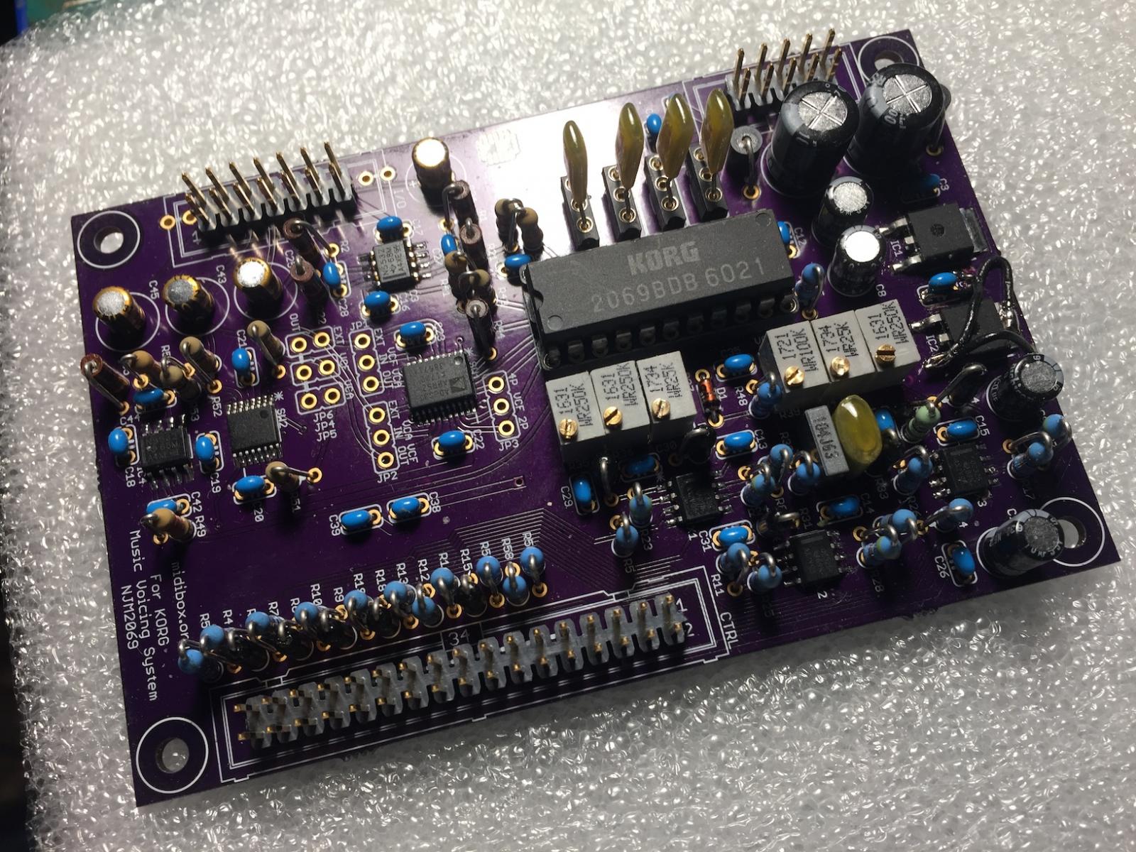

MIDIbox 2069 - PCB Proto
As you can see, there’s an error on the 7905 regulator, wrong footprint.
This 2 large +/-5V regulators will maybe replaced by smaller package, need to measure current with front panel PCB before deciding...
Re: MIDIbox 2069 - PCB Proto
@antichambre These are amazing! Do you sell them? I would like to buy some if possible. I have six 2069 chips that I’m trying to make into something useful :slight_smile:
