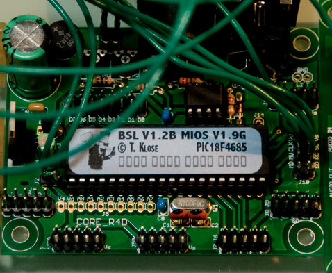

I have this pcb.
My pic was deleted several times, but it’s still functional, I didn’t know that there was a bootloader inside, so what do I need to leave my pic like the one in the photo? I charge a bootloader first?
greetings and thanks for helping this newbie!
Hey,
What do you mean by “deleted” exactly? What does the LCD or “Mios Studio 2” report if you connect Midi In and Out to the PC as soon as you switch on the core? And yes, the boot loader comes up first (it has its own address)

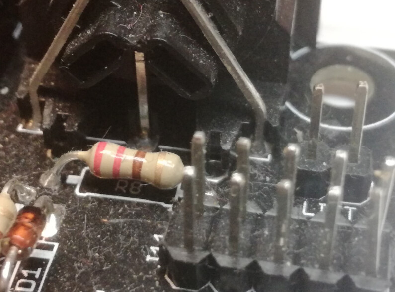

Hello friends, I have been reading the instructions well, I thought I was roasting the microprocessor badly.
The story is that it is a project of my Father, he is 65 years old or older. XD, he bought it to do the V2. and also the minimum project with which I am now helping you. Today I discovered, after coming from  fk!$ the doctor,  :slight_smile: the problem, the female din5 connector, you only have 1, 3, 5 pin. I could never get in touch with the core, maybe wireless. Tomorrow, if my ankle allows me, I’ll go find a din5 with all the pins. Sometimes we look for problems where they don’t exist. Just putting the oscilloscope on pins 2 and 3 of the octo was enough to see that there was no sign of a signal.
Tomorrow I will tell you how it is, I am very grateful for your comments.

missin pin 2 and 4 lol
why did someone solder this in? it’s obvious. And also check the Midi In port. yes change the MIDI Out port and then test it in mios studio.
if you do not have a desoldering iron, cut the legs and remove the legs with heat using a soldering iron and pliers.
The problem is that the two dins do not physically have pins, maybe it is poorly manufactured. I have to buy 2 new ones with the 5 pins.
