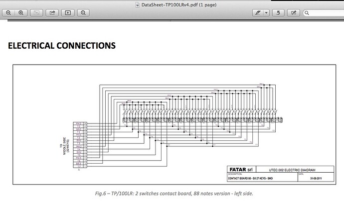

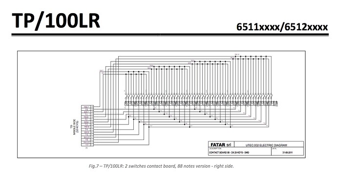

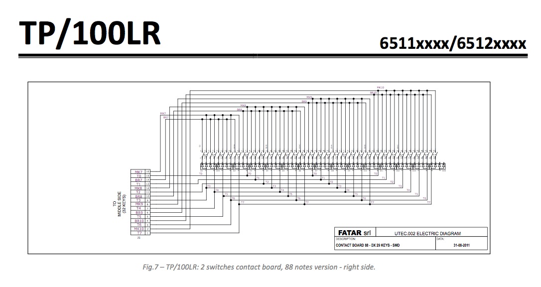

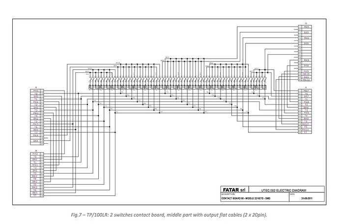

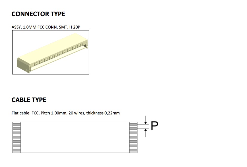

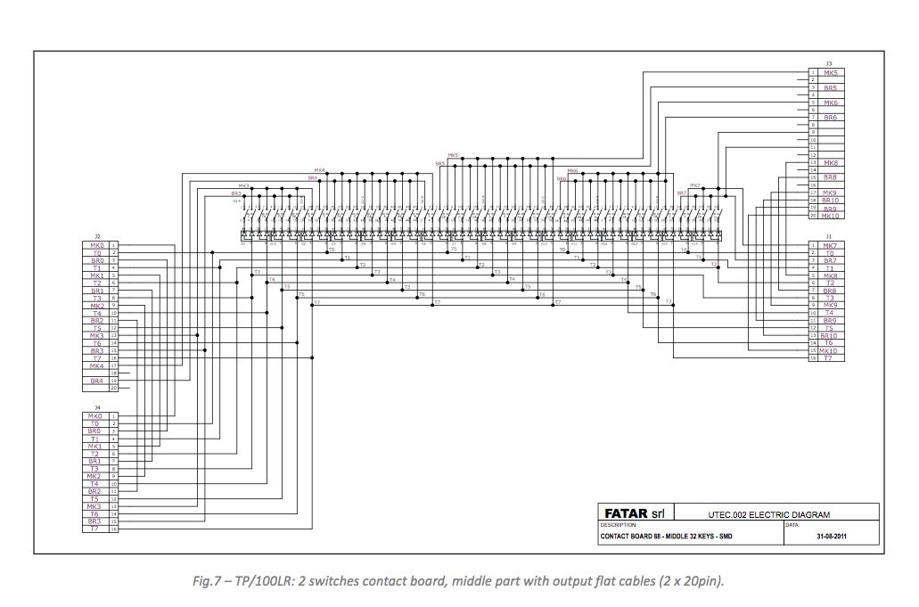

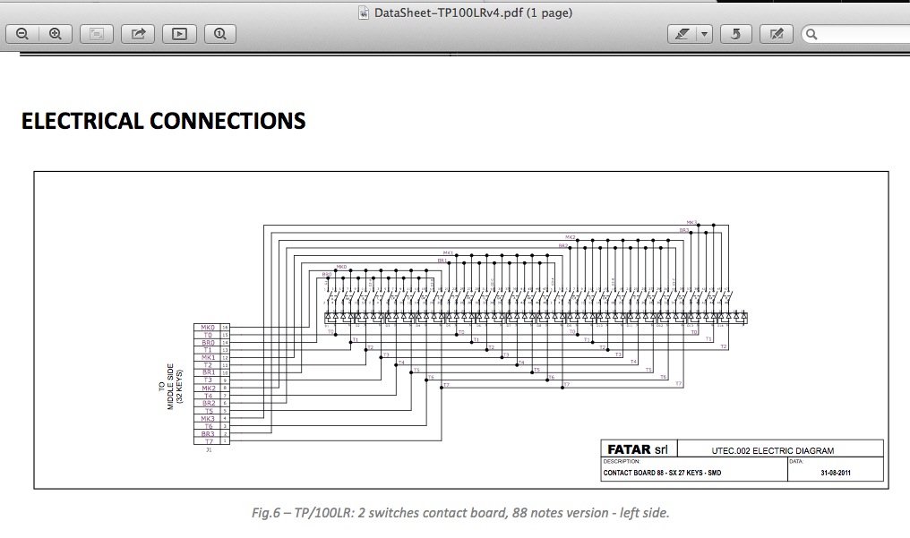

I have gotten a completely naked Fatar TP100LR keyboard, 88 keys.
No case, no electronic boards, no power.
I want to add power & MIDI to this.
Attaching/linking pinout diagrams.
Is there a MIDIbox product, that would help me realize this?
