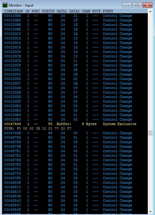

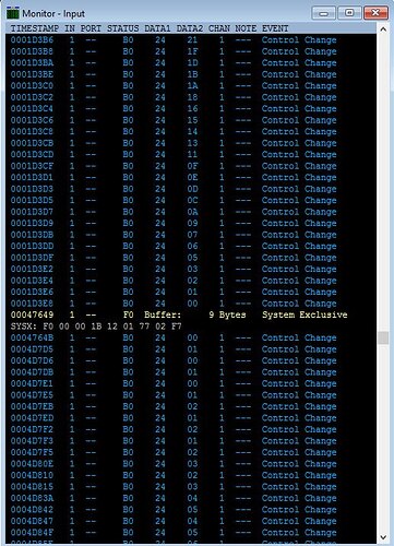

Everything works quite nicely, except the volume pedal of the Sanpera. It does more of an on/off switching and in general is very unpredictable. I captured Midi Data with MidiOX with and without merger (see attachment, part above sysex is without, below with merger, sysex comes from switching the amp on) and can’t see any difference.
What I’m trying to find out now, is if there is a generic problem when using a merger in conjunction with midi CCs from an expression pedal, or if only the merger I have sucks :wink: I also found this discussion, no idea if that could be relevant: http://www.diystompboxes.com/smfforum/index.php?topic=102792.0
