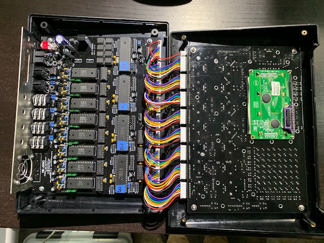

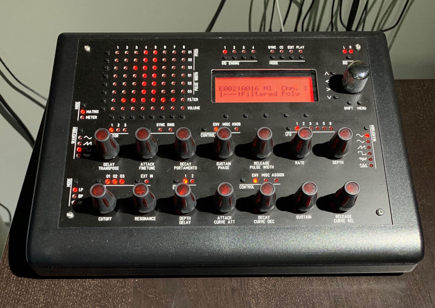

MB-6582 will support up to 8 x SID chips (in pairs of two 6581’s or 8580’s). It also includes a more full featured control surface and a routing matrix. There are no complete kits that I’m aware of, so parts need to be ordered separately from suppliers like Mouser, DigiKey, etc.
> The parts to build a complete synth will run between $600-700 USD without SIDs.. The average cost for SIDs on eBay is around ~$80 USD, so that can add up to ~$640 for sound chips. You can chose alternatives, like SwinSID nano (avg $20 ea.), ARMSID (avg $32 ea.) or FPGASID (avg $45 ea.).
> In my experience the total DIY build time is about ~20 hours (so would need to negotiate a labor fee)
http://www.midibox.org/dokuwiki/wilba_mb_6582

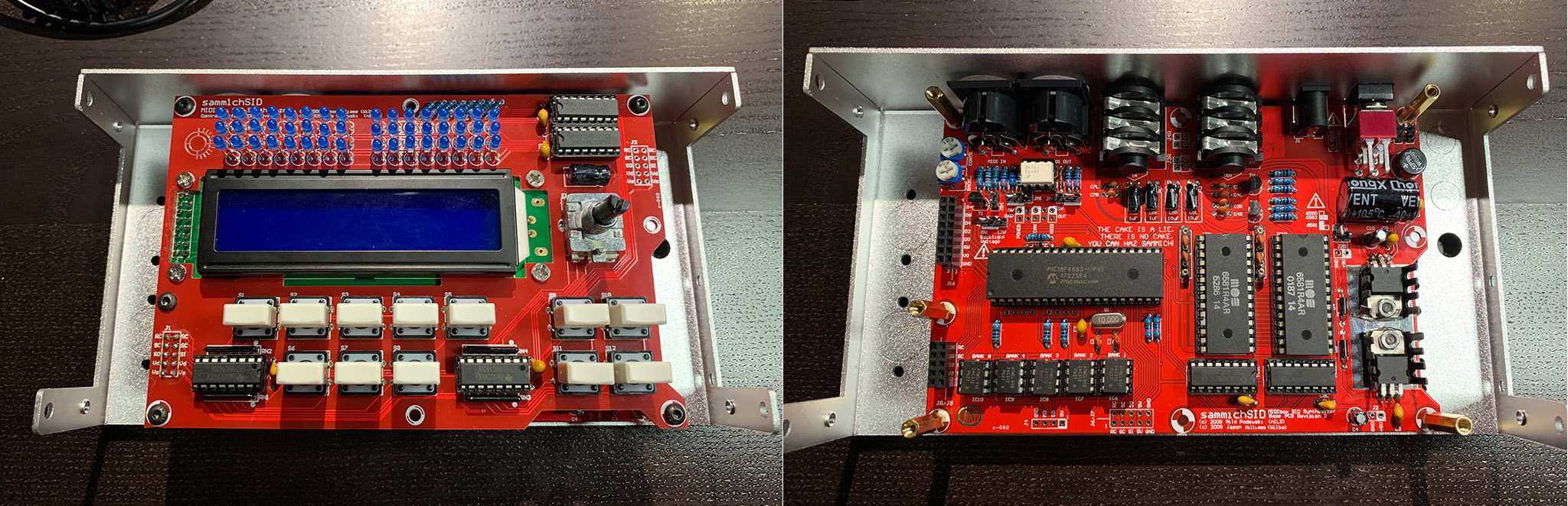

I’m close to finnish the sammichSID.
Regarding the original chip, it cannot mix several one so will go with two 6581.
Meanwhie i got two swinsid nano.
I know there is two jumper one for setting the filter type, and the other for the output voltage.
I suppose the output voltage setting isn’t needed for the sammichSID ?
On the sammichSID i can select the chip type. Does i have to select the same type as on the swinsid ?
Does i need to put the capacitor with the swinsid ?

I don’t understand you correctly.
You need the capacitors for the filter, too, if you use a swinsid, if you mean this with capacitor.
Yes you need to choose the same SID type
Voltage doesn’t matter for a swinsid, as far as I know you don’t even need more than 5v

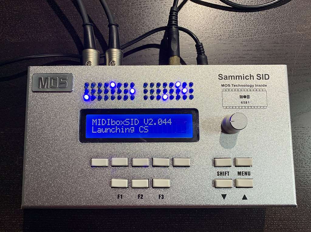

The sammichSID is working now.
Setting confirmed:  Sammich motherboard chip type  8580 (JP set to 8580 JBP without shunt) + 4*Capacitor 22nf (8580) + swinsid (J1 not shunt,  J2 shunt)
Is it normal that the output is very high ?
Also when changing the volume on the VST, it doesn’t seem to work, it’s like a mute ?
