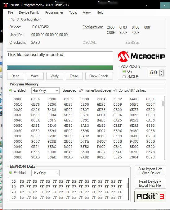

I have tried programming a pic18f452 and pic18f4523 using the pickit3 and the pickit3 software which is running in parallels. according to the the pickit3 software, the bootstrap upload has been successful, but I still can’t connect to mios.

I included some screenshots of the pic programming. The bit values are all default, do I need to change those at all?
