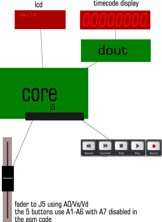

i need to make a little controller similar to the presonus faderport.
all it needs is the lcd, the mtc 7 segment time code display and then 5 buttons for the transport, rew, ff, stop, play & record.
also a single fader.
so as i understand i would go about it this way.
using J5 on the core i put a single fader to Vs/Vd/A0 and then i attatch the 5 buttons to A1-A6 grounding the last pin or diabling it in the asm file.

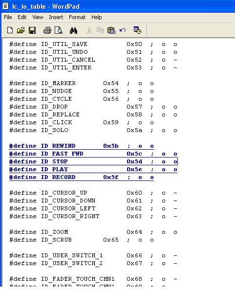

now i looked into one of the files in the lc folders and found that
;; 7th shift register
;; button LED
db ID_MARKER, ID_MARKER
db ID_NUDGE, ID_NUDGE
db ID_CYCLE, ID_CYCLE
db ID_DROP, ID_DROP
db ID_REPLACE, ID_REPLACE
db ID_CLICK, ID_CLICK
db ID_REWIND, ID_REWIND
db ID_FAST_FWD, ID_FAST_FWD
;; 8th shift register
;; button LED
db ID_STOP, ID_STOP
db ID_PLAY, ID_PLAY
db ID_RECORD, ID_RECORD
db ID_CURSOR_UP, ID_IGNORE ; (no LED supported by host)
db ID_CURSOR_LEFT, ID_IGNORE ; (no LED supported by host)
db ID_ZOOM, ID_ZOOM
db ID_CURSOR_RIGHT, ID_IGNORE ; (no LED supported by host)
db ID_CURSOR_DOWN, ID_IGNORE ; (no LED supported by host)
now i have a spare core with the mb64 app installed, can i assign the play stop rec etc to the j5 pins on the core instead of the shift registers on a din board?
so i have got the fader on vs/vd/A0 and then the buttons on A1-A6 can i mix them on that terminal strip and mios will take it?
the only other option is to make a dinx2 board just have two shift registers, with the mb64 menu buttons on the first sr and the mmc on the second sr.

thorsten if you read this, help please mate :wink: also can i have 1 fader and 5 buttons on j5 of the core running mb64 or mb64e and use the fader as a master fader and the buttons for mmc use.
how do i edit this so that the buttons use A1-A6 on J5 with the fader using A0?
