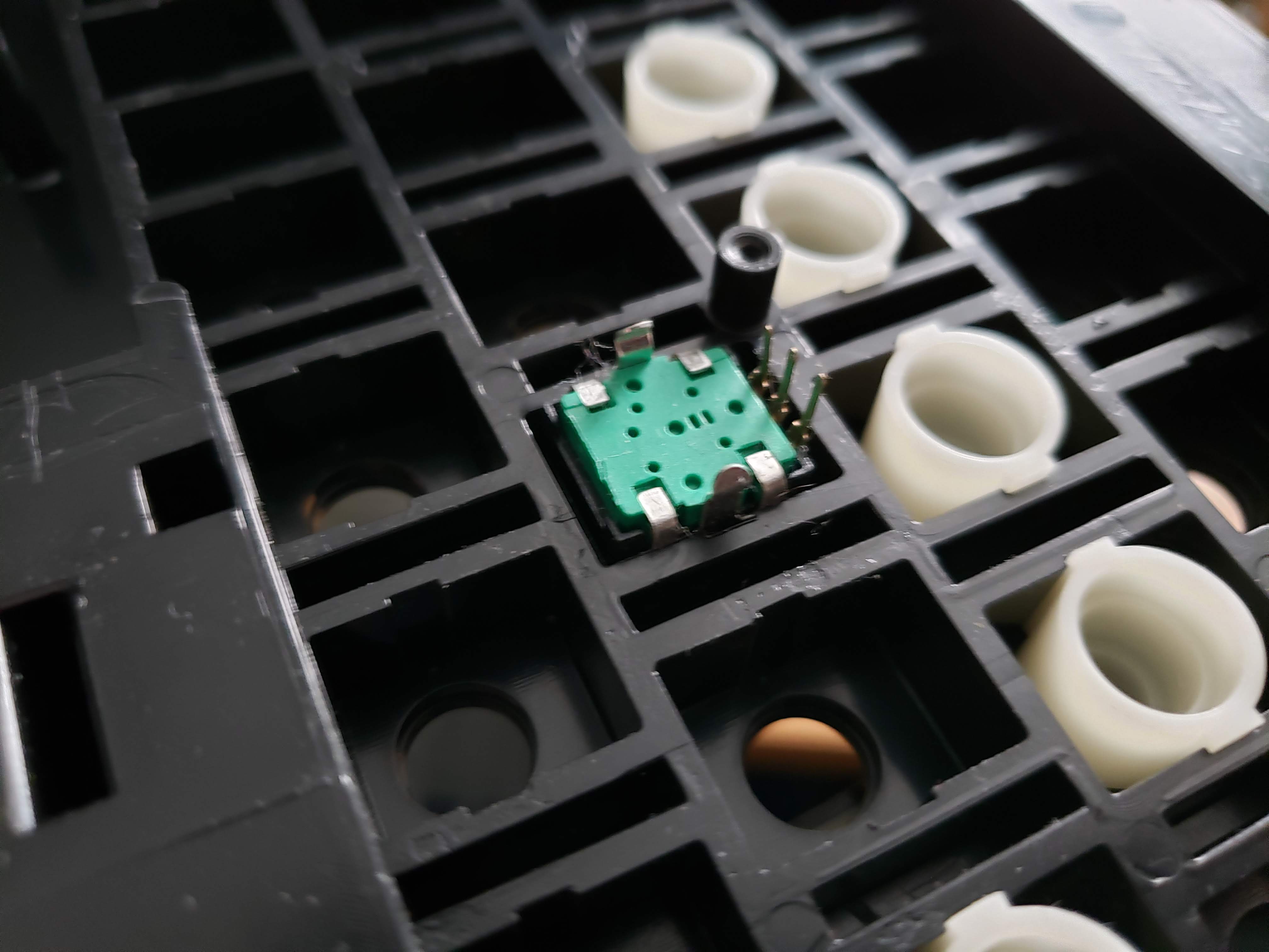

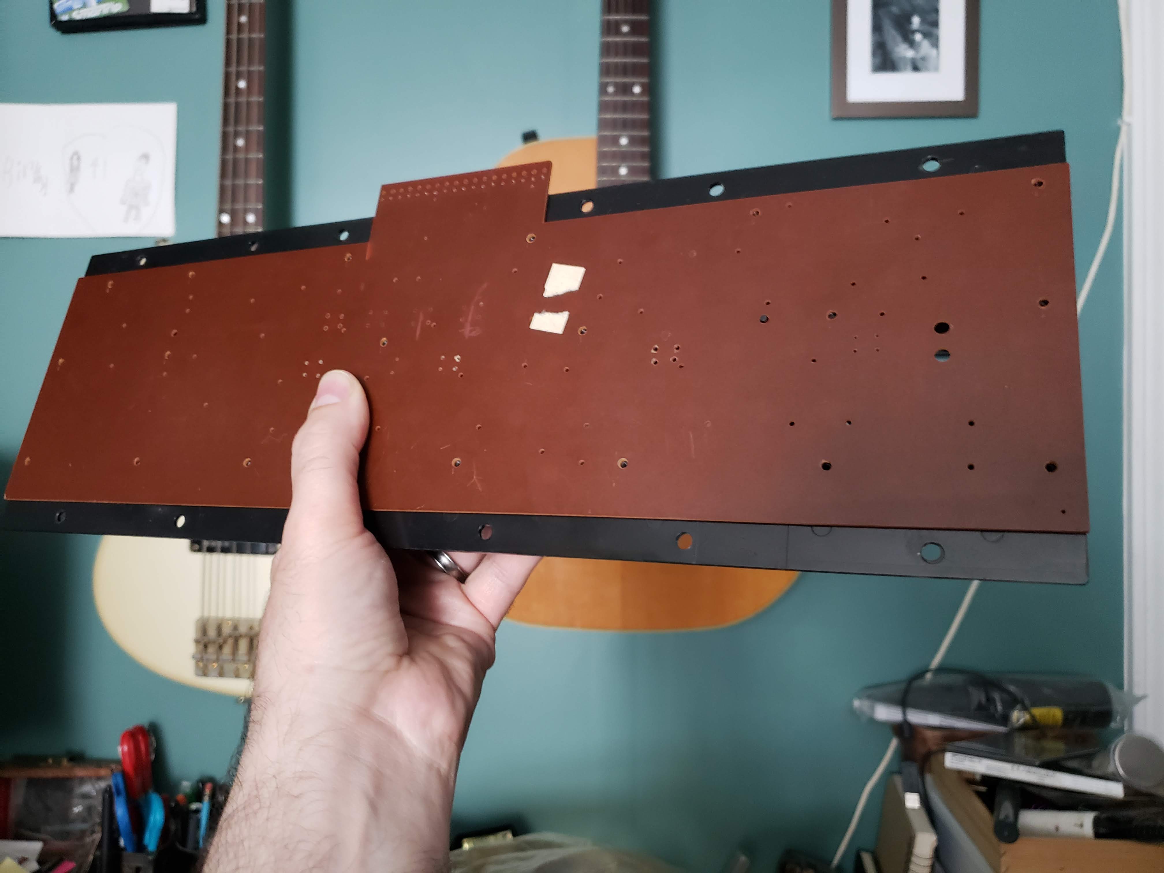

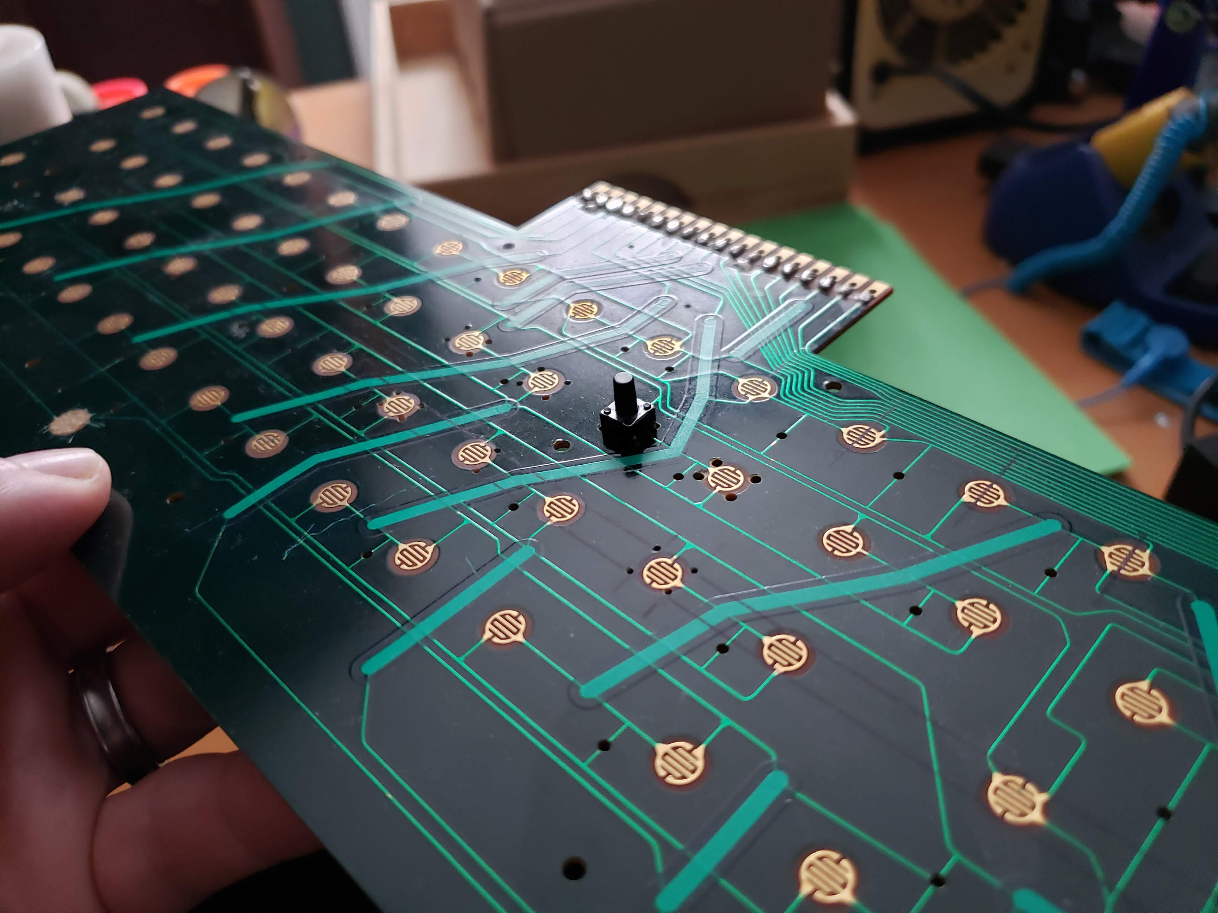

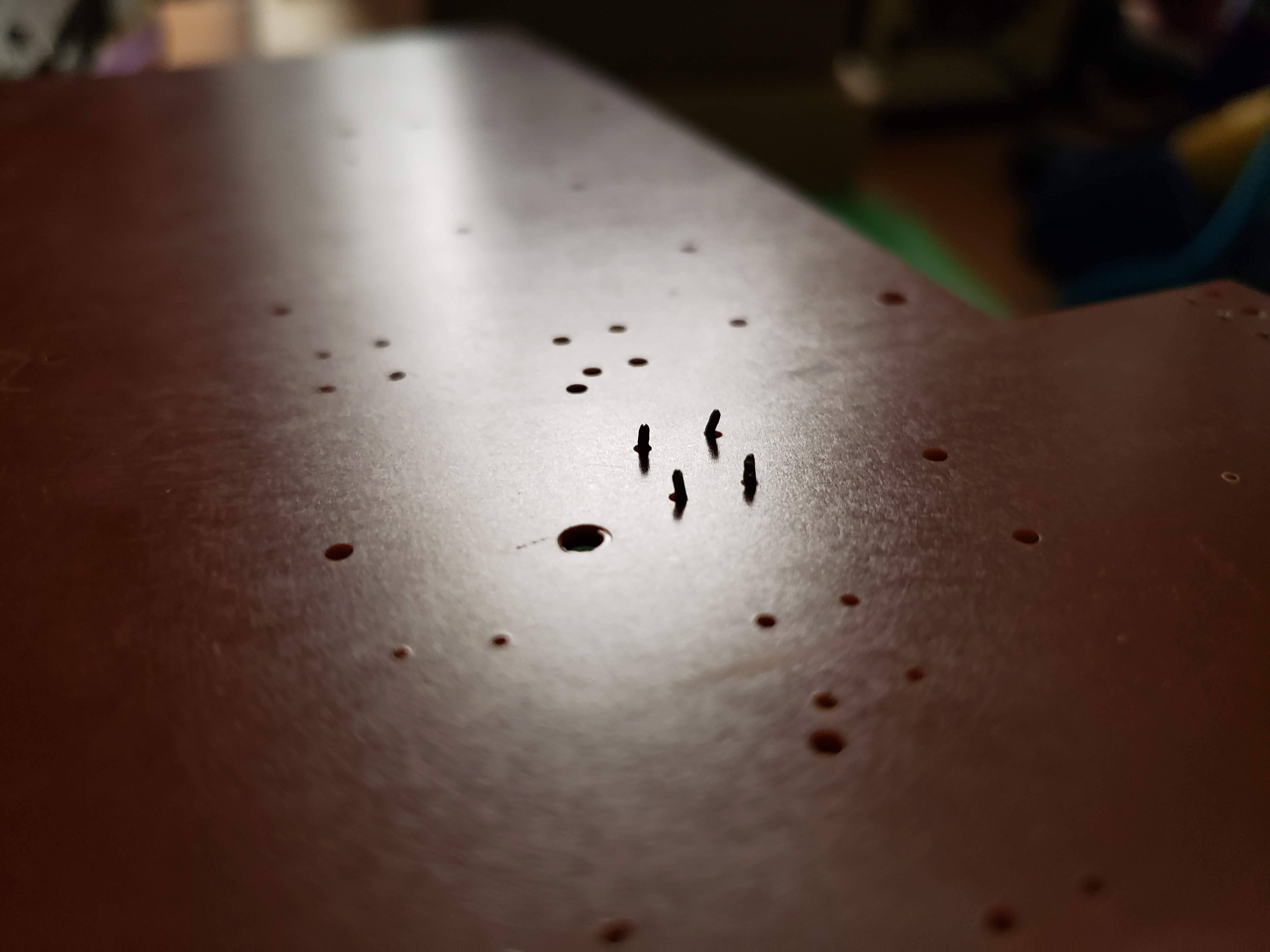

I’m lousy at drawing, but i took some photos to illustrate what I’m doing.

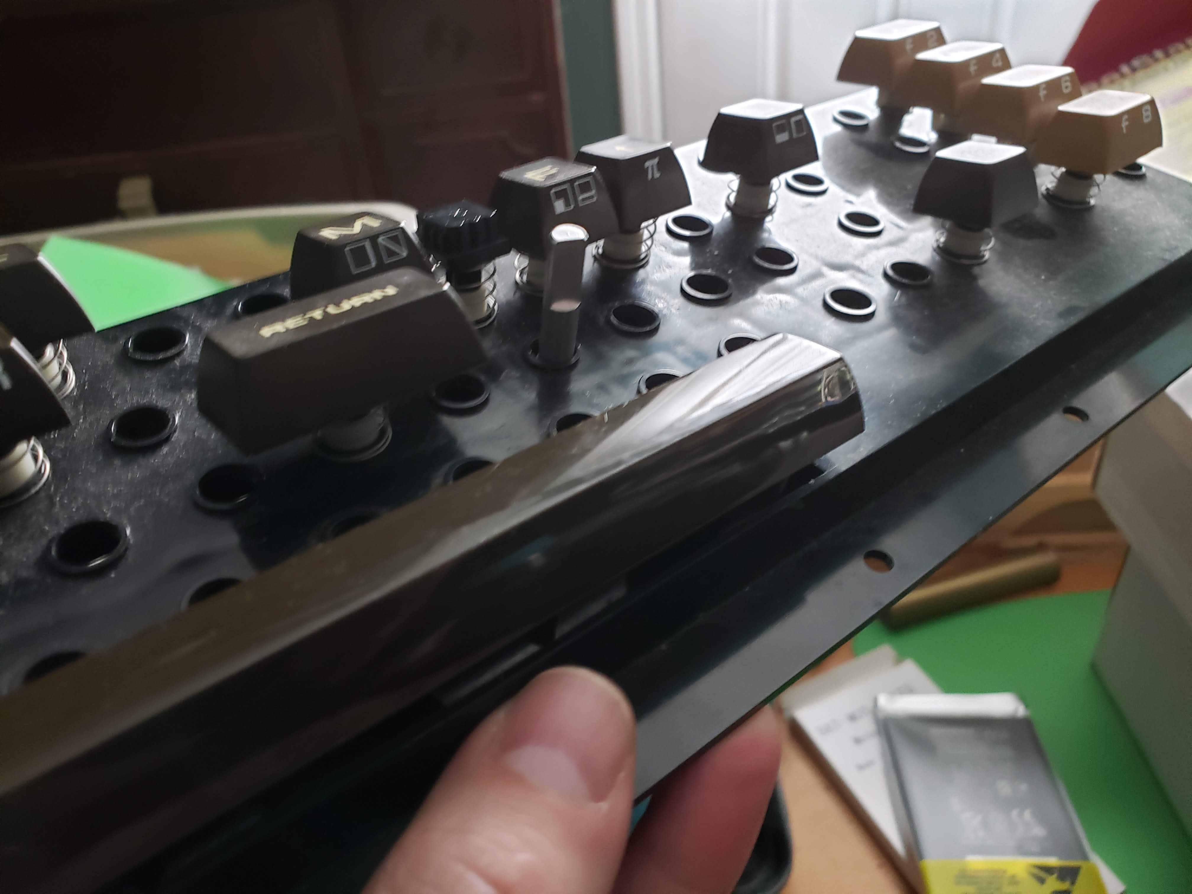

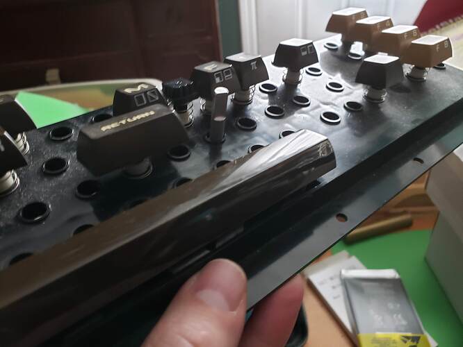

The knobs I got wedge perfectly into the cavities for the keyboard switches on the frame. Those leads will attached to wires between the PCB and the frame and come out a hole somewhere. The switches mount into the board using holes I’ve drilled. In one of the attached pics you can see the leads sticking through.
My skills using a Drimel drill press have proved less than ideal when it came top lining up the spinning bit with the mark for the hole and so some of the drilled holes have been off by a few mm. I feel bad wasting this keyboard PCB and in hindsight I would have gone straight to creating a board like I’m going to do now (I was less “woke” to retro computer preservation than I am now).

I’m actually building this inside of a VIC-20 case. I didn’t always plan to be anachronistic, and was going to put this inside a C64C case, but there wasn’t enough room for the keyboard and the mb-6582.

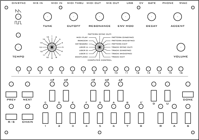

If it is in your budget you might want to look into an xy slide for your drill press. perfect aligned holes. You can make your layout in inscape then  print it and tape it to a sheet of lexan or plexiglass  to see right where to drill. Aluminum is a lot stiffer but has a bit more cost. You will want to attach your panel to a scrap piece of wood so you are not drilling into your xy slide.

I have been able to also do a pretty good job with printing my layout out with the centers of the holes marked with an x and drilling the first hole with a really tiny bit. The smaller the pilot hole the less error you should have in your finished holes. A self centering step bit is also really helpful for stepping the holes to the size you want.
