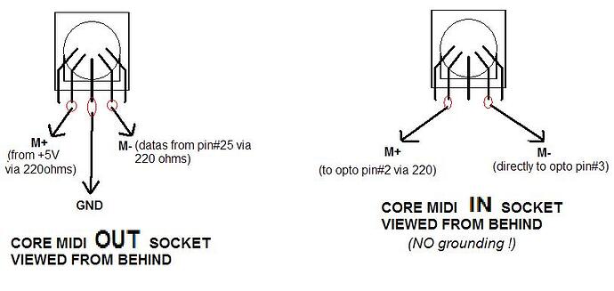

My midi ports are wired correctly, on the midi-out, it shows that the center pin is tied to ground, is it already tied to ground - so I just hook my midi port to that pin? or do I need to solder a jumper wire from the middle pin to ground as well?
I am not sure what you mean, but you don’t have to solder any jumpers on smash’s PCBs. The sockets are already there. Stick MIDI cables in 'em.

Are you using real MIDI cables ? Or a home made pair of twisted wires like I first did ? Because I had the same problem than you, correct midi request (are you sure you set the good ID ? The number at F0 00 00 7E 40 XX 01 F7), first block then… nothing. It all solved when I used MIDI cables and sockets - after some experiments on polarity though.
Just to be sure :
  • if you use a gm5, when viewed from above, the left socket is gm5’s midi in (that you have to connect to core’s midi out) and I let you guess what follows for the right one.
  • the sockets on my core are soldered like shown below.
If it still doesn’t work though, or if you’re already in the right configuration, just do the test in 3 and let us know (beware particularly of the LED polarity - it should lit). If datas actually reach your PIC, this LED should flicker when, for example, you use the keyboard tool of miosstudio and hover your mouse on it. You’ve got to well observate the LED because the flickering is not obvious, since it’s a normally lit LED. The more events you send at a time, the better it is. You can also send a sysex with midiox if you know how to do this.
