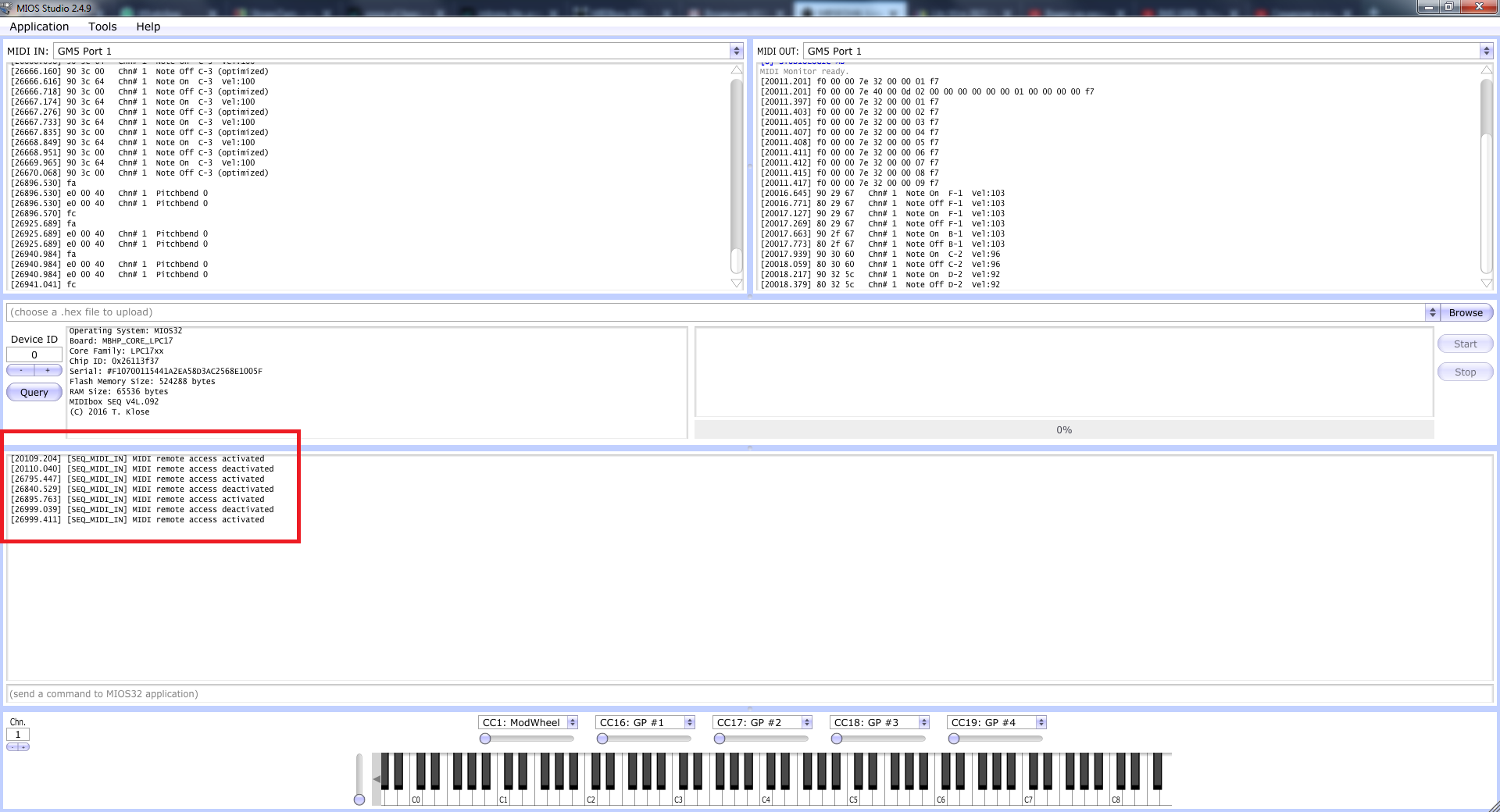

But, is anyone faced an issue with live recording in MBSEQV4L?
I replicated a beautiful MBSEQV4L, even added BPM led panel and encoder, and tries to do some live recording according to guide from TK’s veroboard video, all buttons and leds seems to be worked well, signal from midi keyboard passes to the core (because if transpose func. is on, repeated note in trigger section is changing it’s tone), but IN>OUT, RecLive, RecStep and RecArm functions seems to do nothing with incoming midi data, even if GP buttons is pressed for on\off. Is exist any spectial settings in system I should be done before start and which I could be done with only MBSEQV4L? (I haven’t MBSEQV4’s LCD and other buttons\encoder)
I also got a strange messages in MIOS about remote access enabled and disabled.
Did you set the midi channel for seq1 to match what the keyboard is set for?
Yep.
Looks like it should work, all leds are behaving correctly. Did you try to reflash the firmware? And maybe look at the monitor windows in MIOS for incoming and outgoing notes. The messages about remote access might be a clue, but I don’t know if the V4L has remote access like the SeqV4+ has.
