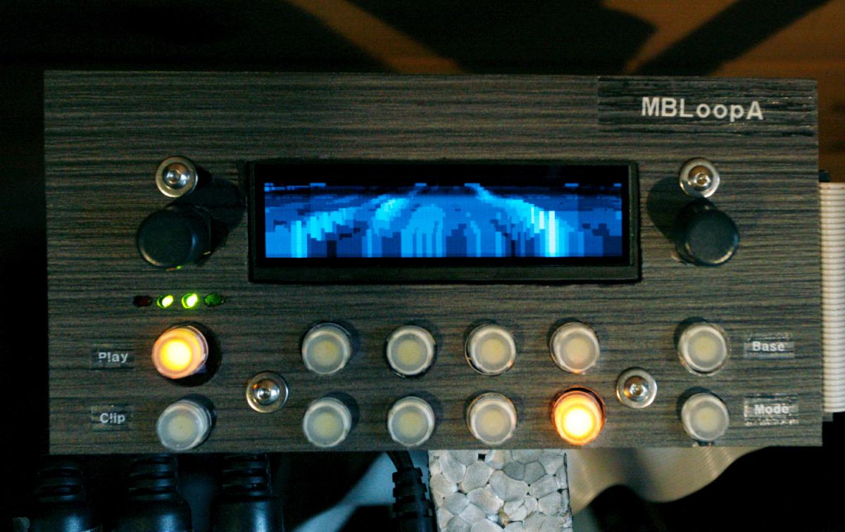

MBLoopA: Voxelspace MIDI recorder and clip looper
Hola,
we recently had some very rainy days in southern Germany and MIDIbox-build-fever struck again, so I had to do something… my project build stack is very large, and even some started projects are not complete yet (MBProgramma), but this one has been on the wishlist for even longer than the Programma, so I just had to start it this year… otherwise it would probably never happen :-).
I have to say, that the MIDIbox platform is phenomenal and addictive! It would be so nice to work on something of this quality on a daily job basis… results can be reached very quickly, the documentation and code base is great. Thanks a lot for everything, TK.!
Let’s start…
Motivation
* DAW hate
Turning on the computer and loading a DAW as complex as Ableton or Cubase makes sure any of my already limited inspiration will be gone by the time it is able to record MIDI. I’d like to sit down and “just jam”. I felt, very often, that what i played was lost in time, because, of course, the computer was off. So I wanted a simple MIDI recorder, that “just records” automatically a few seconds after turning it on, without any major interaction. If what was just played sounded nice, it would be automatically stored on SD card in compatible .MID format for later playback or even some DAW-based post-processing. If not, well, one could just jam on, or delete the track (called clip in this app).
* Hardware minimalism
Building the unit should be quick and cheap. There should only be a minimum number of buttons and encoders. I managed to build everything including the control surface (yes, i know, it looks cheap, but it also was cheap :-)) on one long weekend - and so can you. We just use standard hardware (STM32F4 core, one DINx4, out DOUTx4 and a nice display). Because there are few components, it is very viable to do it on vector board, no immediate need for PCBs…
* Space minimalism
As we all have very limited available upfront space in our studios, the unit is separated into a very small control surface (16x8x1.5cm), which is connected with a 40-PIN old-computer-IDE cable to the base unit, that contains the Core, the MIDI ports and the DIN/DOUT modules.
* Bling
Every MIDIbox needs a bit of bling… I always wanted to use that 256x64px OLED from Newhaven. TK. helped me in getting it connected a few years ago, but we never managed to initialise it 100% (there was some flicker). Meanwhile, Newhaven updated their Datasheets, and after further experimentation, the display now works very nicely and is flicker free. The display is still available on the market, and there even has been a reissue from Newhaven - it came to stay at least for a while, it seems. The 16 grey/blue levels are fantastic! Connection to a STM32F4 is very straightforward, you just need a 3V3 regulator, as the onboard STM32F4 regulator is too weak.
Functionality (already completed)
* Realtime MIDI Recording and playback (functionality cloned from the MIDIO128 MIDI recorder, thanks for that! :-)) of nearly unlimited length to compatible .MID files for later postprocessing. No quantisation or step-recording, we have the MBSEQ for that job!

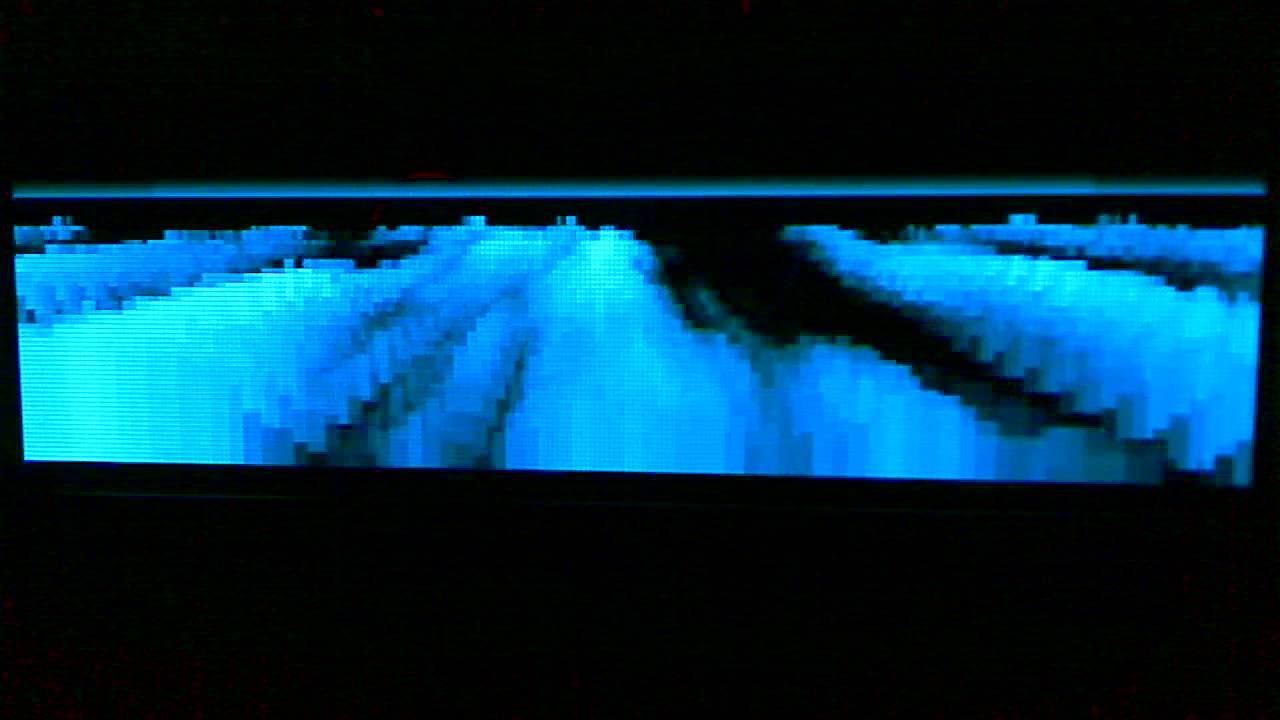

* Graphical Note output. For bling reasons, we currently display notes in voxel space. That means, when a note is played, a “mountain” is drawn - left side are the low keys, right side the high keys - the mountainscape is scrolled continously, so that we “paint” a mountainrange while flying over it. Beats/quarternote timing is indicated in the mountainrange, by an area of “even terrain”. Higher mountains = higher key velocity/louder notes. A demo video should be up soon :-). Smooth framebuffered playback @ ~30fps, the STM32F4 is great! :smile:
* Proper MIDI sync with a MBSEQ V4. This was very important, as the SEQ is the mastermind and controls all MIDI synths here. Pushing play on the SEQ, while the loopa is armed will record “in sync”. The same applies for playback: when a clip is armed for playback, and the SEQ is started, it will playback in sync with the MBSEQ as a MIDI timing master. This already really works really well, and i spent the last night just smiling and jamming! :smile:
* Beat LEDs are working - the leftmost is a red LED and will blink on every beat/ quarternote (like MBSEQ), there are three more green LEDs, which will flash on the 16th notes.
* The illuminated clip switches are working. For later on, the illuminated switch will show, if a clip is “filled” with MIDI data (solid on), is armed for playback (blinking slowly, every quarternote) or is armed for recording (blinking quickly, every 16th note).

In the loopa, the display flyby is reverted, the notes appear in front of the screen and “fly back” as mountainline. It feels very responsive and should be an inspirational little tool (better than any windows laptop), I’ll put up a video, once the font renderer works, and we see some more of the stuff, that is going on (like the current clip position) while recording :-).

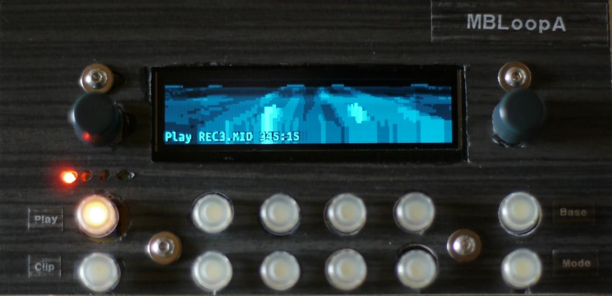

Meanwhile, the 16-greyscale levels font renderer works (it is already commited in the repository) and can be used for “font outline” and “font overlay” effects. The loopa can now be used as a standard one-track recorder with playback with visual voxel output. This is basically just the MIDIO functionality with simplified use with four buttons (Play/Stop, Arm Record/Record, Previous Track on SD, Next Track on SD).
Am now trying to play back multiple MIDI files at once, which should work, because TK. did some amazing work with prebuffered MIDI-file reads from the SD card. You can basically define how many MIDI events should be preloaded from the MIDI-file, before they are inserted into the sequencer module. As long as the SD card is fast enough, there should be no buffer underruns and all should be in sync… let’s hope for the best! :smile:
Last evening, the gurl stopped by and asked if i build a new retro car radio. So much for the ugly design. I hope it just needs a manufactured aluminum/plexiglass frontpanel ;-).

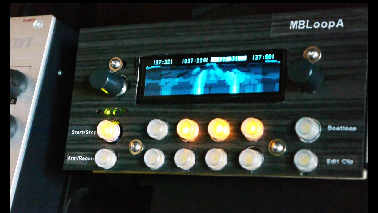

There has been a little bit of progress (already commited) - recording to incremental MIDIs in each clip slot works now, as well as parallel playback of multiple clips. Great idea with using new filenames when starting a new recording session! Unlooped playback of normal recordings seems nice and in sync, no problems with SD card speed :slight_smile:
SRAM would have been my first choice, too (especially regarding timing), but after some experiments (the voxels need some RAM, too), i only managed to allocate around 800 midi events (2 events for note on/off) on each of the eight tracks, so i stopped there, basically because i wanted to record potentially really long jamming sessions, so recording to SD was a must… but that works fine (i have not tried parallel recording and playback yet).
For clip loop playbacks, I still have a logic problem, that is a bit too complex right now :slight_smile:
We have pre-fetched MIDI-Events from clips on SD card, that need to be fetched a bit before their “time”, so the sequencer can play them just at the right moment. For the clip loops, at some point in time, we need to jump back to an earlier file position (loop start point, e.g. start of midi track), but it is difficult to determine, when that rewind (followed by a prefetch) needs to occur, for the clip to be exactly in sync with the song. Need to think more about it - any thoughts are welcome! :-). I think, some kind of a loop-hint index is necessary, but my brain is hurting :wink:
Many greets and have a great day!
Peter
Science Breakthrough! :alien:
It will have to do for the first iteration. A few glitches/bugs and quite some extensions on the wishlist, but it will have to wait - celebrating the nice summer now :afro:

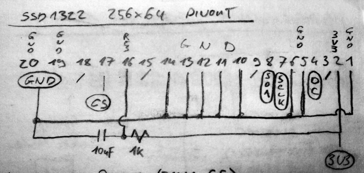

Altitude, I’ve attached the connection diagram for the SSD1322 display :slight_smile:
To see the correct mapping, this link will also help (the wiring is very similar to the ssd1306): http://ucapps.de/mbhp/mbhp_lcd_ssd1306_single_mios32.pdf
Here is the connection table in verbal form:
SSD1322 256x64px Connection Pins
GND: Pins 1, 5, 6, 10, 11, 12, 13, 14, 19, 20
+3V3: Pin 2
NC: Pins 3, 9, 15, 18
DC (=RS Pin on MIDIbox Core): Pin 4
SCLK (=E Pin on MIDIbox Core): Pin 7
SDA (=RW Pin on MIDIbox Core): Pin 8
Reset (Active low, slow pulled high on powerup with 10uF cap/1K resistor, see schem): Pin 16
CS (=D0 Pin on MIDIbox Core): Pin 17
Regarding the voltage supply: a LF33 or any other low-drop 3 or 3.3V vreg is nice (no switcher recommended, the OLED is very sensitive regarding stable voltage, but the standard-size linear vregs will do without additional passive cooling) and a 47uF/100nF pair to stabilize pins 1/2 is recommended (not in the diagram, probably not necessary, when the vreg and the vreg output cap is nearby). The STM32F4 Core should be jumpered to 3.3V (display lines), but the display seems to be able to tolerate 5V on the datalines (made a mistake first, but nuthin’ burned ;-)). It probably does not withstand 5V on pins 1/2, so be careful :-).
I’d recommend to build a test wiring first before finalizing the PCB, i can send you the .hex to get some output, if needed :slight_smile:
Many greets and have a great weekend,
Peter
