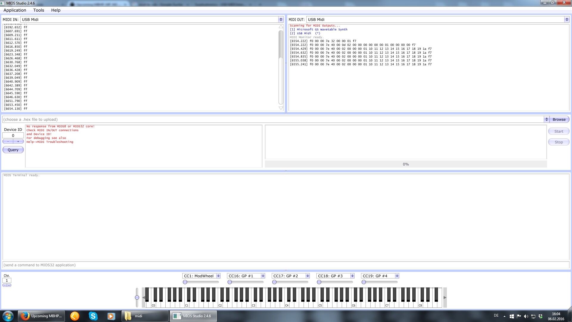

In MIOS Studio i get the error message:
No response from MIOS8 or MIOS32 core!
Check MIDI IN/OUT connections
and Device ID!
For debugging see also
Help->MIDI Troubleshooting
and in the MIDI IN section an endless list of signals appear (everytime the IN-LED of the interface blinks the list updates):
Scanning for MIDI Inputs…
[1] USB Midi
MIDI Monitor ready.
[6104.260] ff
[6104.920] ff
[6106.760] ff
[6109.840] ff
[6111.680] ff
[6112.941] ff
[6114.219] ff
[6114.239] ff
[6115.839] ff
[6119.102] ff
[6121.122] ff
[6121.460] ff
[6121.740] ff
[6122.722] ff
This is my MIDI OUT section:
Scanning for MIDI Outputs…
[1] Microsoft GS Wavetable Synth
[2] USB Midi  (*)
MIDI Monitor ready.
[6554.222] f0 00 00 7e 32 00 00 01 f7
[6554.222] f0 00 00 7e 40 00 0d 02 00 00 00 00 00 00 01 00 00 00 00 f7
[6554.429] f0 00 00 7e 40 00 02 00 00 00 01 10 11 12 13 14 15 16 17 18 19 1a f7
[6554.632] f0 00 00 7e 40 00 02 00 00 00 01 10 11 12 13 14 15 16 17 18 19 1a f7
[6554.835] f0 00 00 7e 40 00 02 00 00 00 01 10 11 12 13 14 15 16 17 18 19 1a f7
[6555.038] f0 00 00 7e 40 00 02 00 00 00 01 10 11 12 13 14 15 16 17 18 19 1a f7
[6555.241] f0 00 00 7e 40 00 02 00 00 00 01 10 11 12 13 14 15 16 17 18 19 1a f7
I already tried to choose different Device IDs but it doesn’t work!
I hope someone can help me, i have no idea how to fix this problem :frowning:
cheers, Leo!

The MIDI-Interface should work fine, i get a signal from the burned PIC and the MIDI IN status LED of my interface is blinking (recieving information). But this information looks like this:
[1] USB Midi
MIDI Monitor ready.
[6104.260] ff
[6104.920] ff
[6106.760] ff
[6109.840] ff
[6111.680] ff
[6112.941] ff
[6114.219] ff
[6114.239] ff
[6115.839] ff
[6119.102] ff
[6121.122] ff
[6121.460] ff
[6121.740] ff
[6122.722] ff
…endless…
i burned the PIC with PICkit 2 v2.61 and there was no error at all… :confused:

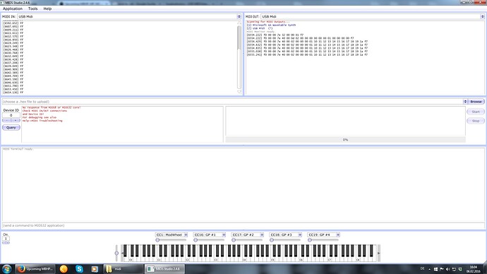

Try turning off the Core, select the hex file and press Start in MIOS Studio. Then power on the Core.
Reading mios8_v1_9h_pic18f452.hex
Trying to contact the core…
mios8_v1_9h_pic18f452.hex contains 12826 bytes (52 blocks).
Range 0x00000000-0x00002fff (12288 bytes) - MIOS8 area
Range 0x00003000-0x000033ff (1024 bytes) - PIC Flash
Range 0x00007c00-0x00007fff (1024 bytes) - PIC Flash
WARNING: no response from core
Please reboot the core (e.g. turning off/on power)!
Waiting for upload request…
still got no respond from core :confused:
the only thing that changes is this constant MIDI IN stream:
[10223.823] ff
[10225.221] ff
[10225.222] df 7f   Chn#16  Aftertouch G-8
[10225.222] df 7d   Chn#16  Aftertouch F-8
[10225.222] ff
[10225.223] fd
[10225.862] ff
[10225.905] ff
[10226.061] ff
[10226.881] ff
[10227.116] ff
[10227.720] ff
[10227.919] ff
[10228.341] ff
[10228.978] ff
[10229.619] ff

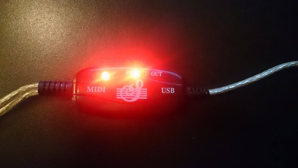

Your MIDI interface is probably not suitable; MIOS has a rigorous loopback test (?) that won’t properly upload firmware unless the connections are solid.
Check here:
http://www.midibox.org/dokuwiki/doku.php?id=midi_interface_blacklist
Check here:
Okay, that could be the problem! I’ll try to get a different MIDI-Interface!
Thanks!
That is the problem. I had the same problem with the exact same interface.
Okay, good to know :wink:
I just ordered a different midi Interface and i’ll let you know if it solved the problem!
Cheers!
