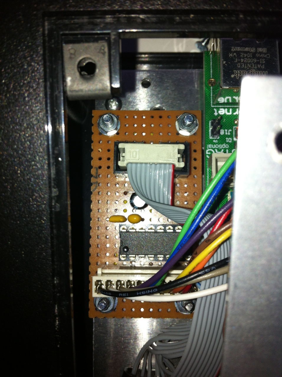

Hey,
I built my small “Ainser8” on breadboard today and it all works perfectly!
At first I wondered why a single pot would send 8 values at a time, but then I figured out that I had to disable all the pins which were on by default.
btw I bought my MCP3208 from Segor, and they have two different versions (C and B, which has slightly better specs) of the chip. In the store I was unsure what to buy so I just got the B version to be on the safe side, but maybe that’s not necessary at all.
anyway, no more jitter!
Thanks!
