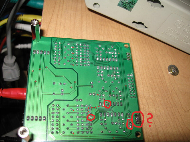

what i noticed was that pin3 of ic3 is shorted to the flood somewhere? i removed all the solder from ic3 joint and the connected jumpers joint? i couldnt find any other shorts to the flood anywhere?
IC3 pin 3 comes directly from the DAC when the jumper for channel 3 is set to unipolar mode (one jumper horizontally). You mean there’s a short to GND, right? Is it present if you remove IC3 and the channel 3 jumper? If not, maybe the short is located around the DAC. If yes, maybe while soldering you’ve damaged the green protective laquer somewhere and made a connection with a large tin blob? If you don’t find the short yourself, maybe you could post some hi res pics of your board?

with ic3 and the jumper removed i was getting continuity from ic3 to the bottomside copper flood surround section.

if the short is under ic3 or the header maybe? i could probally get better photos and also keep in mind as of right now the board needs a once over (removed alot of solder for trouble shooting), solder and cleaning.
did you also measure with the jumper completely removed (not only turned sideways)? With Jumper and IC3 completely removed, the marked trace should not be connected to anything.
which place of bottom gnd pour did you measure against? the gnd pour on the analog side (right) is normally not even connected to anything, so the problem can only be on the bottom side if more than one solder joint makes connection to it. Make sure that none of the solder joints touch it (normally that’s no problem but maybe you’ve damaged the laquer somewhere). Especially resolder both joints on that marked trace.
A problem on that trace occurring on the top side isn’t very likely, the tin normally doesn’t go through the holes in large amounts.
J3 also looks dangerous. I can’t really see what’s happening there due to image resolution, but try to remove all solder on top and bottom side, looks a bit like you have some interconnection there.

this is exactly what i did. i put the jumper in sideways just to ‘mark it’ after testing.
i was measuring against the right side/analog. actually when you said that it is a GND pour i got really worried its not connected to anything except pin3 of ic3 and the connecting jumper pin.
this is exactly what i was worried about so i checked continuty across all solder points and the right pour and only found the short at ic pin3. i may have went alittle fast at it maybe i need to go over again…
S
j3 is a complete mess im ashamed of myself :stuck_out_tongue: one of these days i need to go pickup a real desoldering tool. i will go into it with the wick some more and try to get everything out of it. if this is the spot where the laquer is damaged and the traces are interconnected i hope i can get around it. i would just like to say thanks for taking time in helping me with troubleshooting this.
