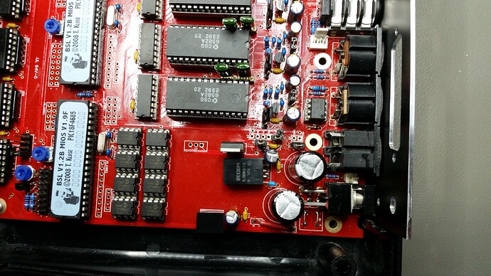

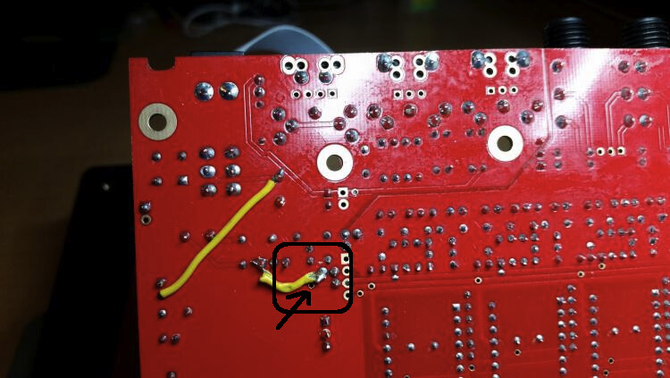

Hi,
Just looked at your pictures.
Maybe there is a short where the yellow wire crosses the hole?
Perhaps test the solderjoint and the hole with the multimeter.

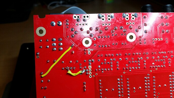

I measured that suspicous wire and did not measure any problems. Still decided to remove that wire completly because i will not be using it for this build i only need that bridge when i wanted to use 6581 sid chips but decided to not use these. After i removed the wire and connected everything again the problem is still not solved  the mb6582 still does the same thing.

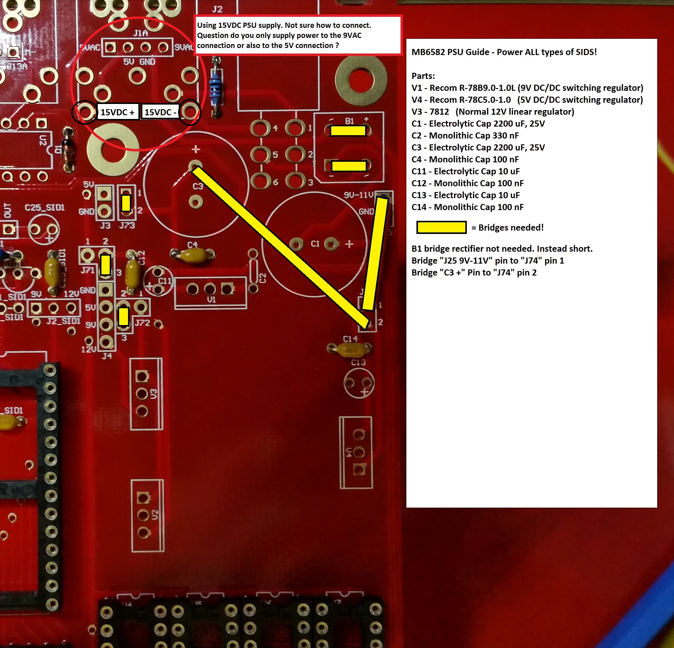

i tried to explain how everything is connected by pointing you towards the other topic. But maybe easier to repost it here.
So above picture show how the bridges are running with a component list on the right side. The PSU i’m using is a 15V / 2A switching power supply. I choose 15V because at first i also wanted to be able to use 12V for the 6581s the bridge previous mensioned is now removed so 12V is not used anymore.
Above shows the power plug that shows where the power comes in. I only use the 2 pins that are marked with the red box. So i’m using only those 2 pins directly soldered on the 15V DC powersupply. So Pin 6-7 is connected the other pins are NOT connected. The values mentioned in the pic are not used.
When i only connect the power supply to the MB6582 without any other connectors the MB6582 acts normal. So the power switch works how it should. If i connect a headphone to the MIX OUT connection the MB6582 still acts normal. But when i connect the MIX OUT (and any other output of the MB6582) to my External soundcard that the powerswitch does not act “normal” anymore. But the connections act like a power switch. Also if i connect it to any other “plugged in” computer/synth it does the same. So i gues a connection made with a “plugged in module” it will creat a closed power loop and thus switching “ON” the MB6582

Looking at the diagram here it’s probably the expected behaviour, as +15V is always present. If the polarity was reversed the electrolytics would go pop and nothing would get through the regulators. So the next question will be about the 15VDC PSU, what is the model/do you have a picture? If it has a metal frame and earth pin, do you get continuity between it and the 0V line in the MB-6582?
