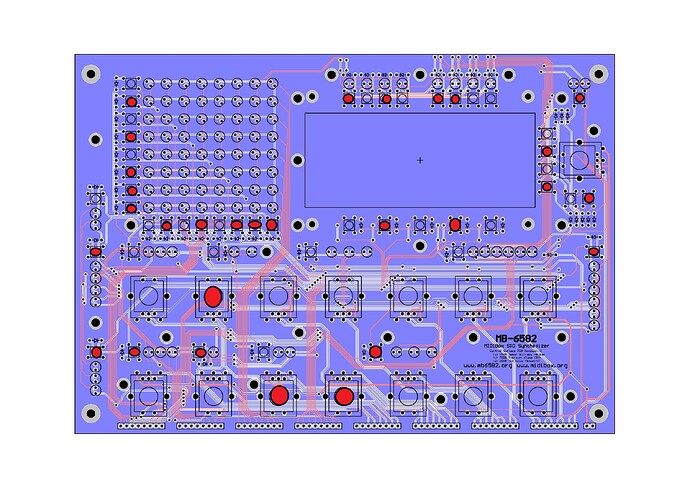

I finished the CS surface and notice alot of buttons not responding. Did not do much troubleshooting yet hope to get some feedback first or a good starting point or a point out about the problem.
The only thing i checked is the wirering combining the CS with the Base board. Also measured with a multimeter checking continuality. All these wires make a good connection.
All buttons and POD meters marked RED are not responding.

i checked the orientation and the type of the shift registers. These add up. Allthough i wonder if the HC165 type i use is the correct one. Don’t think it matters much but if someone can confirm this
Did not check the soldering yet..
Hmm. soo i just tried the following..
I still had a CS board laying around from the previous time and i thought lets connect this one to the new base board and see what happens. I got exactly the same non responding knobs and buttons as i have with the new CS board.. That shifts my suspect to the Base board. And also this problem looks alot like the problem i had previous time. Meaning that maybe there are some components on the base board that are not working well. So the only thing i re used from the previous time are the ICS. Shift registers and PIC processors.. So is it maybe possible that a PIC processor is bad??

so i did some swapping around with the hc165 shift registers. And there is definitly something wrong with these. Every time i remove one and place back different parts of the CS board fail. I even had some new ones laying around that never have been used from the same batch and still fails are happening..
I guess a smart thing to do now is to order some ordinary regular ones..

 WHOOHOO IT WORKS
I swapped out the 165’ers with ordinary ones. And i can confirm it works without issues.
I also tried my old CS board. And this one also works. I’m kinda annoyed that i didn’t try this before cause my old 2011 BASE board is now damaged because of all the troubleshooting i did on this issue.
But i have a working MB6582 now
