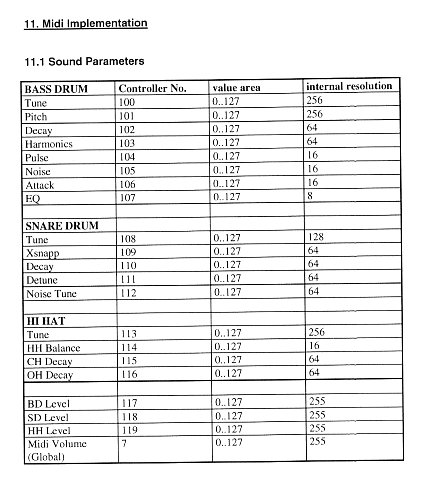

I’m the new owner of a Jomox XBase 09 and it’s pretty fun… But I’d like to program the parameters such as Tune, Pitch, Decay… that can be changed on the Jomox through controllers… But I’m not that familiar with the process.
If anyone has any experience with such a setup, that would be great!
Here is the Midi Implementation chart of the Jomox:

you need to send MIDI CCs, best by using the special CC track type in the MBSEQ - it allows e.g. automated filter sweeps, you can even record the CCs sent by your XBase and play them back… I´d suggest to to record the CCs at first, so that you see which values are sent/are of interest to you.

The “Controller Number” in your datasheet above corresponds to the CC number.

I have a problem selecting the right parameter layer. By choosing CC 128 steps 8 layers I should be able to attribute a CC number to every layer, from A to H.
But if I choose another value for A instead of 001 (for instance 113, which should control the Jomox Hi-Hat Tune), there is a “!” right after the value and when I initialize the track, it goes back to 001!
