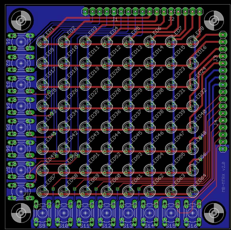

I have been working on an 8x8 LED Matrix board for my own MB-SID synth and figured I would offer it up for a bulk order in case anyone was interested in having a printed version cheaper than having one-off done via BatchPCB or somewhere else.
Information about the board itself can be found here.
Adding yourself to the bulk order page only indicates intent but isn’t a full obligation at this point. Please only add yourself to the list if you are serious though!
Prices should be about $15 (not including shipping) for 25 boards or about $8 for 50 from Advanced Circuits. 25 is the minimum I am willing to do since, otherwise, folks can just have their own boards made via BatchPCB for about the same price.
The design is open - you can grab the Eagle files from one of the above links if you’d rather do it on your own. If you have any suggestions, however, just let me know and I will see if I can implement them if they make sense for the design goals.

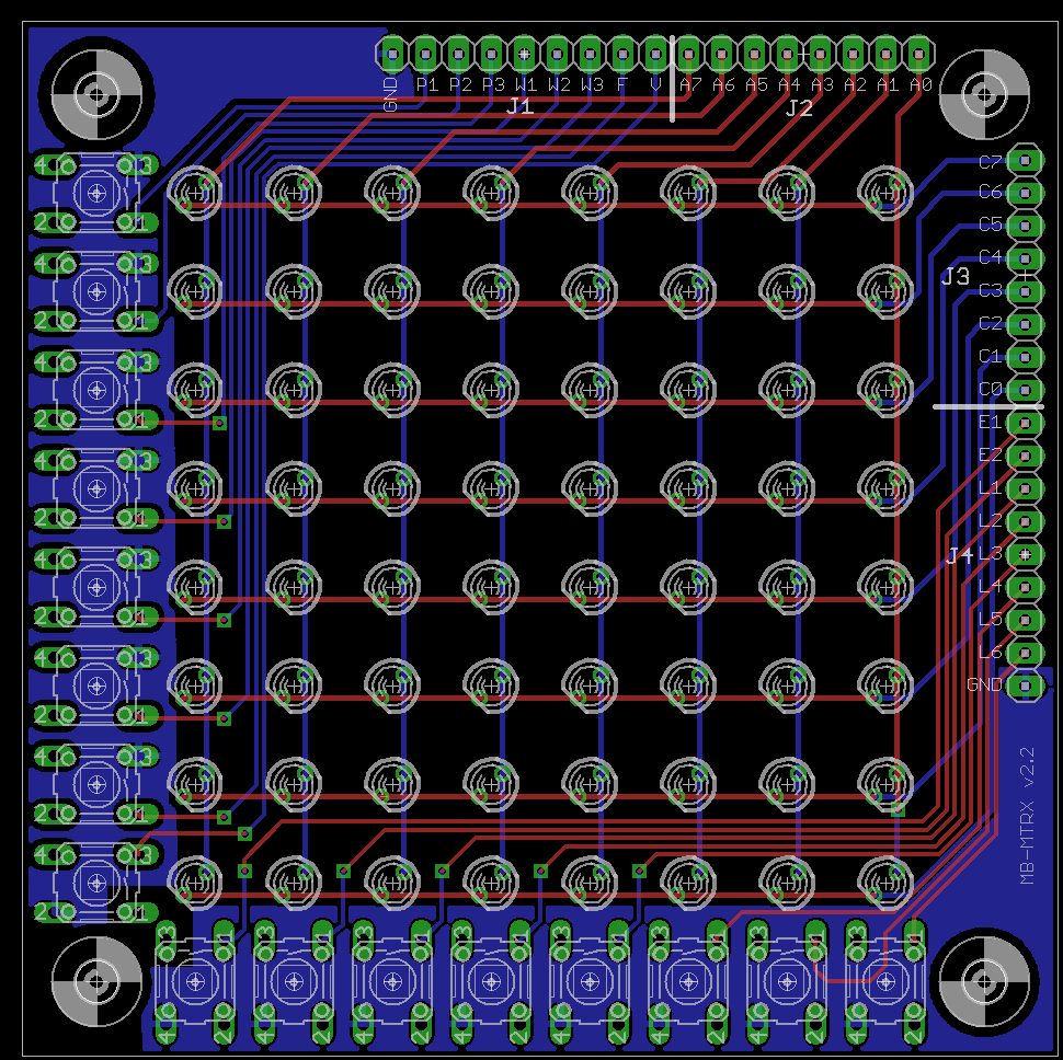

I updated the design a small but by going ahead with the jumper idea. Now it is possible to share JD8 (for control surface designs mirroring the MB-6582) or simply use one of the pins on the jumpers separately, avoiding having to share JD8 with the LEDs. I can’t think of a great reason to do it that way unless one was using separate LED and button matrices, but I figured I might as well provide that as an option, just in case.

Spent some time thinking about this while working on my other boards. I think the size of the LED matrix board would grow in size too much for me to be happy if I tried to cram shift-registers on it. So, instead, my idea is to convert the current LED board design to one that can accommodate the “standard” wiring by default. For folks (such as myself) wanting to do special things, a daughter-board can be used. In my case, I am going to make a daughter-board to house shift registers, resistors, etc. since the rest of my control surface is likely going to use board-mounted shift-registers.
For folks wanting to use a button matrix (ala MB-6582), another add-on board could be used. That’s probably not something I will be designing myself unless folks already on the bulk order would like it (since originally I was thinking of using a button matrix when I designed the board initially).
Everybody wins this way, except for those wanting to do fancy things, as this will increase the costs, but I think is the best route to go to offer the most options.
Ah well in that case you’d be all set The only catch for you is I will likely have 1 GND pin for each row of buttons (2 total) you will have to account for. I have to do it this way if I want to offer a potential compatible option with a button matrix. I may try to see if I can make that easier via a jumper or something, though. I’m hoping to start work on this tonight so should hopefully have some layouts to share in a few days.
Still need to work on the labeling (pins are swapped for some of the headers, stuff like that), but here is what I’m envisioning it to look like. The board is bigger on all sides, but only by a little and, unlike the old board, is symmetric for the OCD folks There are two planes for the buttons that will normally be tied to ground but could be used for a button matrix using a daughter board. The headers are intentionally on the top left to make such a daughterboard smaller (and thus cheaper). Since there is no need for diodes, I removed these off the main board. Folks wanting to do a button matrix could add them onto the daughterboard I think (I don’t believe they need to be close to the buttons to work right, although I’m not 100% sure on that).

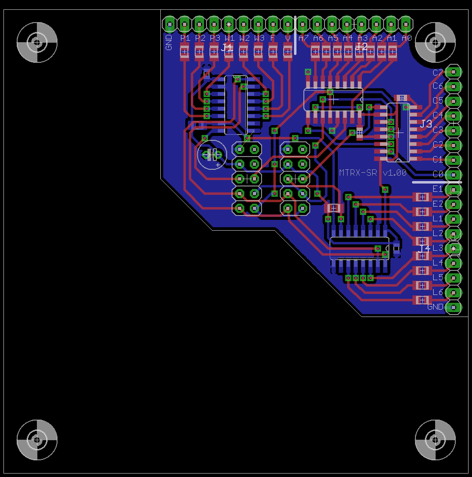

Once I finish this, I’ll make the daughterboard next which will basically be a DIN / DOUT board mounted to the back with the idea, as noted previously, being that the board can be part of a chain when using shift registers mounted on control surface boards directly. Fare warning, there will probably be some SMD work involved here since, so far, I have had to use SMD shift register chips for my other control surface components and would prefer to use all the same chips throughout. Plus it should end up saving space (and thus cost) to have the board made.
Here’s a better version of the 8x8 Standard LED Matrix and of my SR daughtboard.
I had the wiring backwards for the LED Matrix, which would be probably easy to fix in software but I wanted to stick with a drop in solution for folks trying to go with standard wiring (at least for the LED matrix itself). So that is fixed and I added some nice labels to make it easier to hook it up however you might want.
The SR board is, well, I feel like it could be simpler than it is. Thought about using standard DIP SR’s instead to see if it would make things a bit cleaner (fewer vias maybe). I am using SMDs for other boards so I figured it might be better to use SMDs for this one too.
I will likely order both boards soon but I’m moving in a week so I will probably have to wait a few for things to settle down. I’ll be using DorkBot so I’ll have a few extras of both boards if anyone wants to have whatever I end up not using (if I don’t screw up, I’d only use one board of each ).
