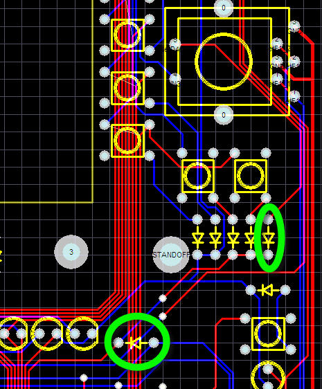

The CS parts list calls for 48 small signal diodes but I came up two short when soldering them in.  Does the CS board actually take 50? (Meaning there’s an error in the parts list?)

There are 48 switches on the CS.
The CS PCBs (R1) from the original bulk order had 48 diodes.
The CS PCBs (R2) from SmashTV have 50 diodes.
The extra two diodes are for optionally using rotary encoders with switches… the switches for the lower 14 rotary encoders (i.e. not the Menu rotary encoder) are joined in parallel, thus only two diodes.
Find attached a picture showing which are the two extra (and optional) diodes.
Sorry for the inconvenience.
