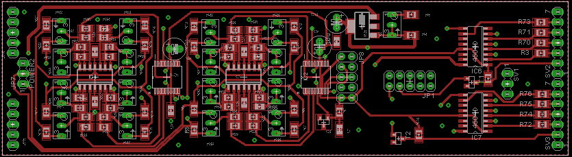

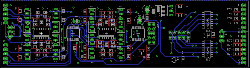

So I have been working the last month or so on a new surface mount based Max525 Auot module with integrated daughter board and level shifter.  The level shifter if based on the Midisizer Alf analog board and is adjustable from 5 to ~11V gates.  Sync24 is also included via normaled jacks so the signals are run to the DIN port on the 4xIIC module unless something is plugged into the 3.5mm on the break out board.
Critiques/comments welcomed and appreciated

Perhaps a 1:1 header pinning from the core could be useful if there’s space? And you might also want to keep the digital and analogue sections of the PCB separate, which is harder than it sounds!
I went with the 525 simply because I had the SMD parts on hand and it’s supposedly a better part.

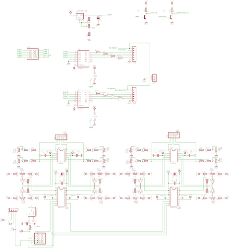

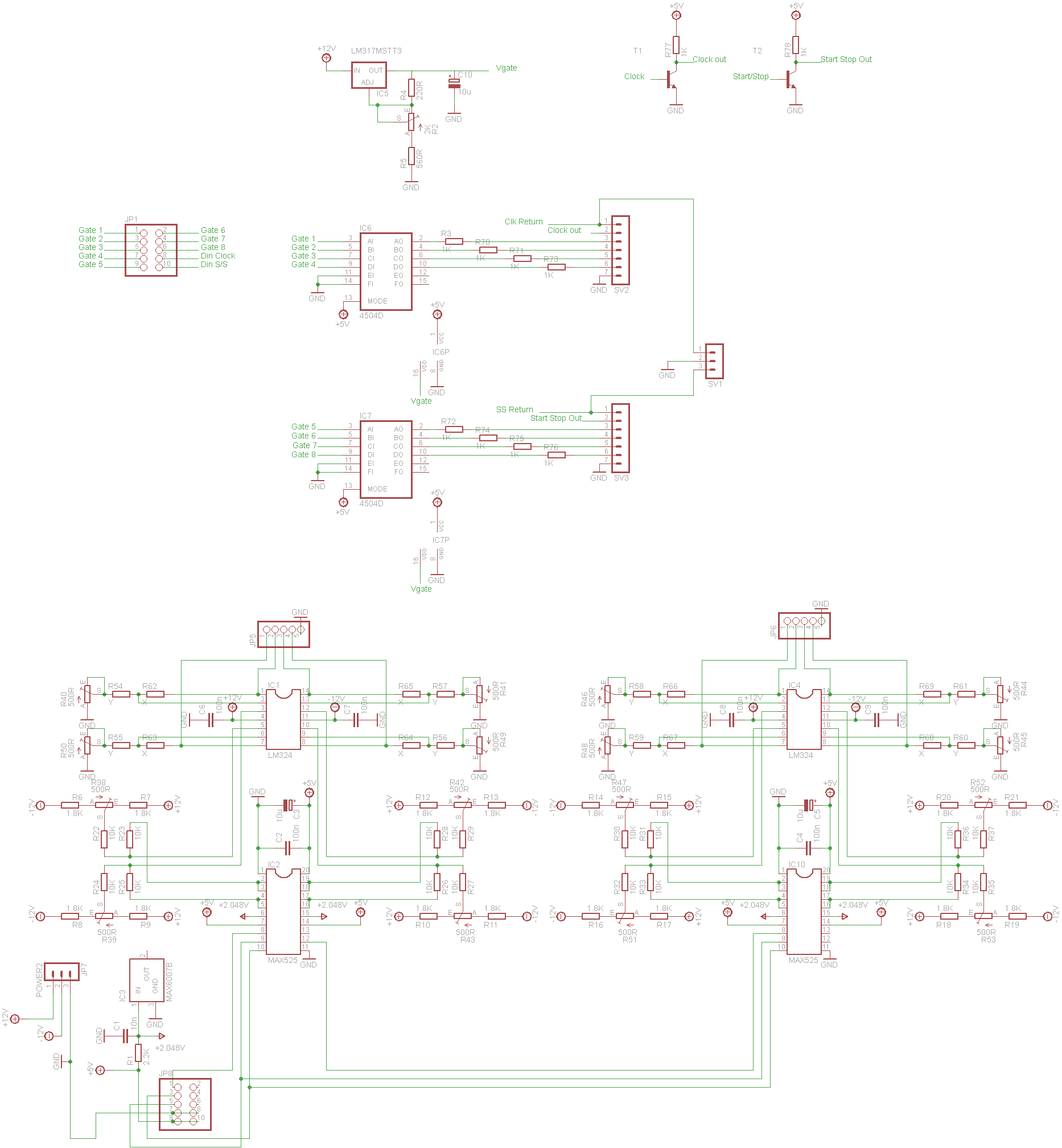

JP8 is the 1:1 pin connection from the core (or it should be anyway, I’ll make sure to double check that).  I used the NorthernLightXs schematic from the Aout redesign page and that was one of his changes to the original design

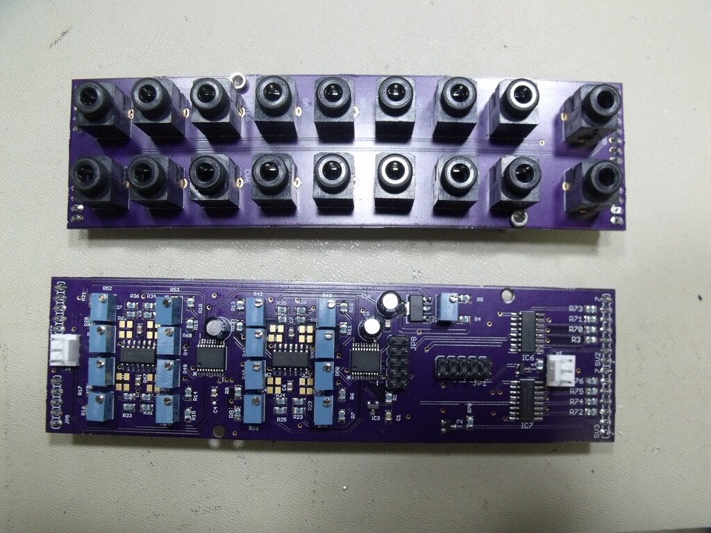

and the results:
Yummy, OSH Park PCBs!

I use the LPC cores right now, I have a layout for CNCing the holes for those and right now. I am doing a second rev of the Aout board, the first one had a bunch of mistake since the schematic I used which I assumed was correct had a bunch of errors on it. The prototype worked fine with all the fixes though. If you are not familiar with soldering fine pitch surface mount parts, I recommend you learn on something else. The Max525 parts are SSOP size which is VERY fine and at $25 each, its not a part you want to practice on. This board was made with the smallest possible footprint possible as the goal so the layout is pretty dense.
if you want to rack it, you might want to consider TK’s new line length extender as well, the Aout is pretty sensitive to long data cables.
Once I confirm that the new rev is fine, i’ll post the files
