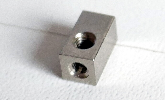

Does someone know what name this M3 standoff has? It is used for example to mount PCBs to a Frontpanel!
Name in German/English, and maybe where to get them.
thx!
thx!
Gewinde = thread/threaded
Apparently called a cube standoff or mounting cube e.g.
https://www.newark.com/ettinger/05-60-233/spacer-m3-12mm-x-6mm-brass-nickel/dp/59M4072
Gewindeblock:
https://www.ettinger.de/p/montageblock-6x6x12mm/005.60.233
i renamed the title…treat thread
thanks!
English: mounting-block / cube , cube standoff
German: Gewindeblock or Montageblock or better Leiterplatten-Montageblock (because Montageblock is used for Water-Installation-“Montageblocks” too)
buerklin (29,75 € incl VAT, excl Shipping)
ettinger (52,44 € incl VAT, excl Shipping)
a bit strange that Reichelt/Mouser doesnt have it, they all have such Nylon Variants: https://www.reichelt.com/de/en/mounting-block-m3-16-mm-natural-rnd-610-00209-p254065.html?r=1
