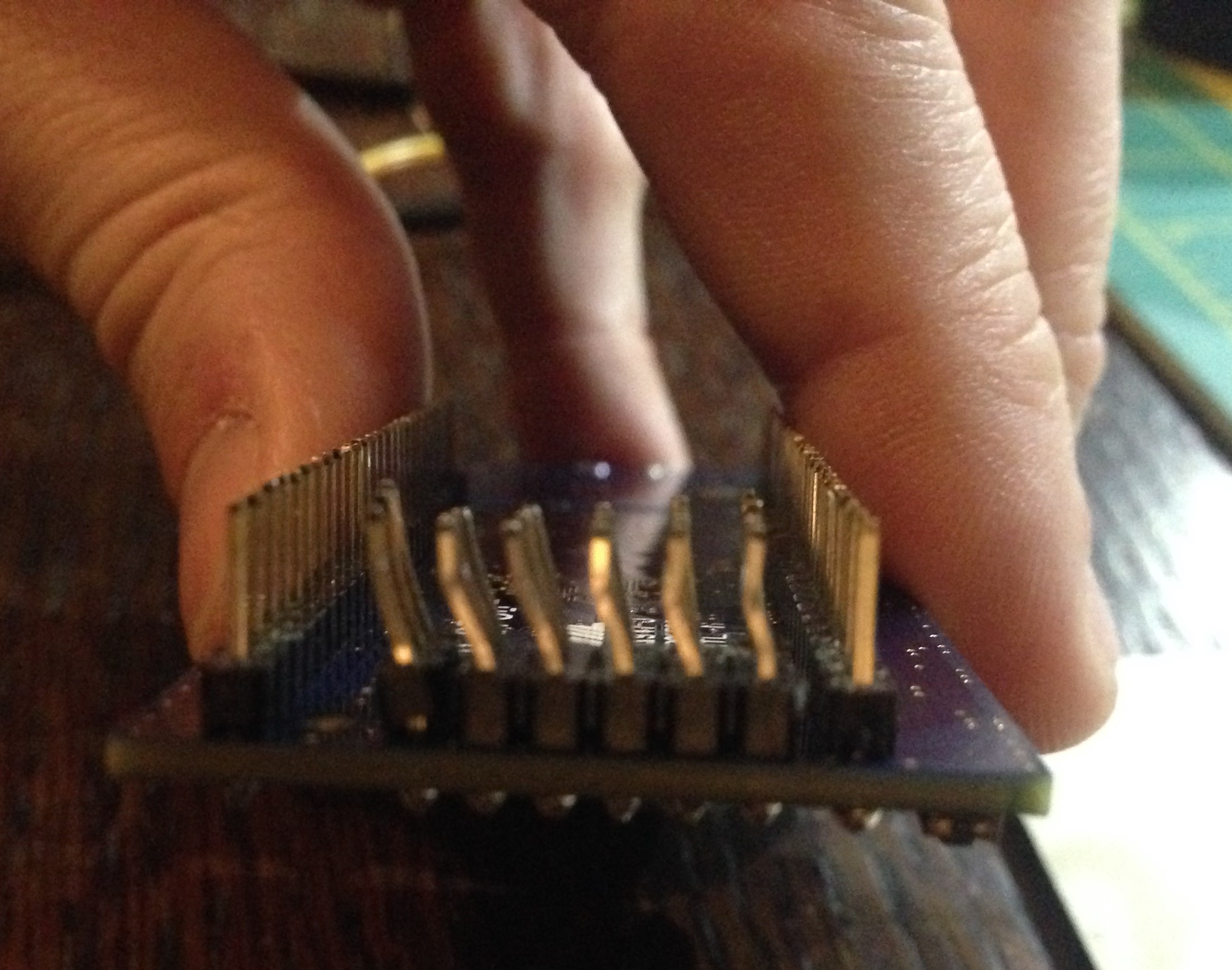

The revision D has the same issue as the revision C being that the pins are shifted. It will go into the board but is not a easy fit.

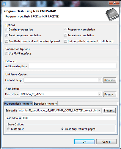

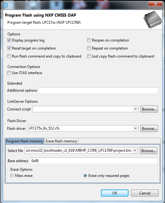

You go through the process of setting up a new project and selecting the 1769 board. There is no option for RTOS project in version 8 just select a C  project. You are just getting access to the Flash button so it really does not matter too much here except selecting the right lpc 176x board.
Select your current mios boot loader bin file to load. The tricky bit here to get it all to work is you have to set a target address with the newer version of the IDE. There is more than one place a boot loader can be flashed on the newer revisions of the LPC board. After some time spent RTFMI, I found that the base address of the boot loader is 0x00. There is a line to add this at the bottom of the program flash page. Press ok and away it programs.

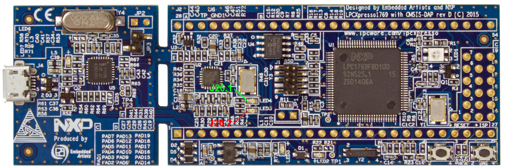

after a couple of hours going exactly through these steps myself, tripping over exactly the same stumbling blocks and figuring out exactly the same solutions, I find your post …face palming myself. But at least I can confirm, that it indeed works after a lot of pin bending and ramming the board onto the headers. I also soldered a short wire for the two Ethernet LEDs onto the left side of LED3 and 4. The network connector ones lit up, but only dimly. I guess, I should have done that either onto the right side of the SMD LED’s or onto the left side of the corresponding resistors on the LPCxPresso board. But here is how I did it:
By the way, that’s how the headers had to be bent in order to be able to give them a firm push to fit them onto the headers:
What was the reason for this modification, or what do you intend to do with it? If the reason is to disable it, is not it better to unsolder these LEDs instead of bridging them?
On the newer boards you do not have to remove the programmer. It has a jumper now to enable/disable it. I would not remove it unless you really need to reduce the space to get it to fit in your application. You may need or want to reprogram later and it is a lot easier with the programmer attached. It does not have the pin header on the bottom and the pitch is fairly small to solder it on there if you needed it and had removed it.
You have some options on the leds. I have not tried them yet so can not help a lot here. Also I am not sure how comfortable you are with soldering SMD or removing SMD parts you got the jumpers in place so maybe it is easy enough. You could remove the led on the board and your led on the jack should be much brighter this is not the best option though. You could source from the left side of the resistor. If you do this you may need to still use a resistor inline on your jumper. You could adjust this resistor value for the brightness you desire. A 100K pot would be an easy way to adjust for the value you like and when you have a brightness you like use a close r value.  If you go to low on the resistance your led will burn out so you may want to put some additional amount of  r in line with the pot just to be safe as the Ethernet jacks can be really annoying to unsolder if a led burned out. I am not sure what to recommend for the additional amount of R as I have not measured voltage and do not know the current and voltage the leds on the magic jack.. Possibly the leds are supplied at 3.3v and do not need the additional R. I have not tested and will not be able to for some time so can not be more help on the actual details here. If you have the time to test it out more please let us know I am sure it will help others as well. You may want to test with some leds not the ones on the Jack, especially if you have a few that are rated the same as the ones on the jack. That would save on having to remove the jack incase of a opps moment. I have been known to be an expert at making an opps moment. :slight_smile:

you mean, that LED light was annoying, so you disabled it, right? And bridging was an option. But sorry, I don’t get your words:
Quote
If I take a look at the board above, what exactly did you bridge? only the LEDs and not the LED resistors infront? And that’s how you changed that and we could do it that way, right? Maybe you can disable it via application code, as it is possible for the power LED too.
