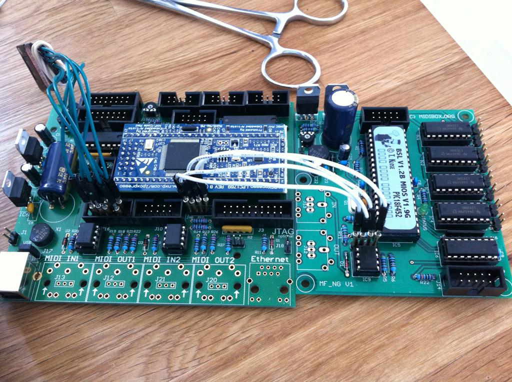

I have a few questions on getting started. I have the LPC17 setup with the SD and working over USB.
My configuration is going to be:
  • LPC17
  • (2) DIN to control 21 Rotary knobs and 20 buttons
  • (1) MF_NG to control 1 Motorized Fader (Alpha)
  • (1) DOUT for LED
I won’t be using any midi ports for this project, it will be USB-MIDI.
I have J4B of LPC17 connected to J11 of MF_NG. From here, I have no idea what to do to be honest. :smile:

Hi Eric,
welcome on board! :slight_smile:
You could try out the MBHP_MF_NG with following (temporary) MIDI router configuration, which has to be entered into the MIOS Terminal:
set router 1 USB4 all OUT3 all
set router 2 IN4 all USB4 all
Thereafter select the fourth USB IN/OUT port in MIOS Studio to communicate with the MBHP_MF_NG module.
Once this is working (and you are able to configure the module with the MF tool, which is also part of MIOS Studio), you can setup the router connections with the MF command in the .NGC file instead, like described in the manual (and demonstrated in the examples)
