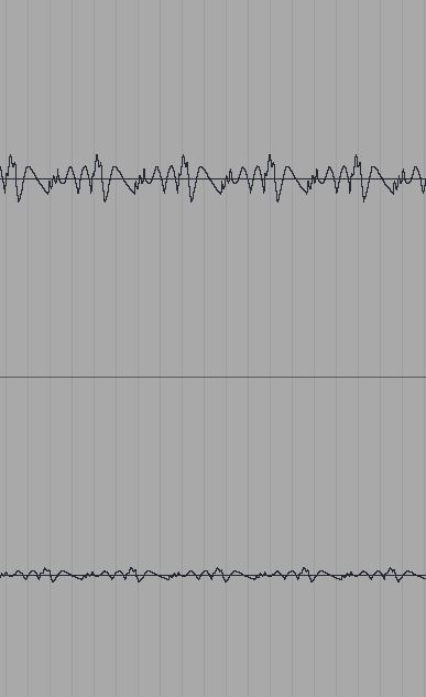

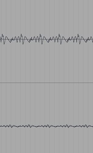

Attached is an image of a recording with the MBFM on the top and the sammichFM on the bottom. Same note, velocity and patch.
Can anyone see a reason why the sammichFM is so much quieter? Are the op-amps that different?

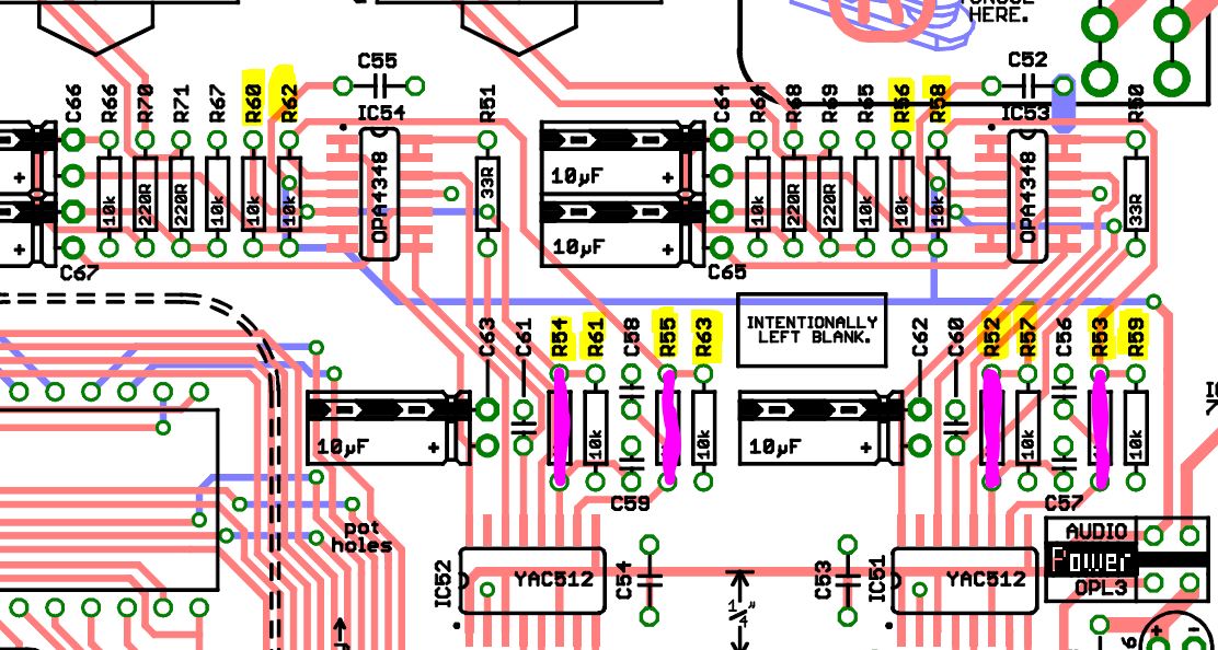

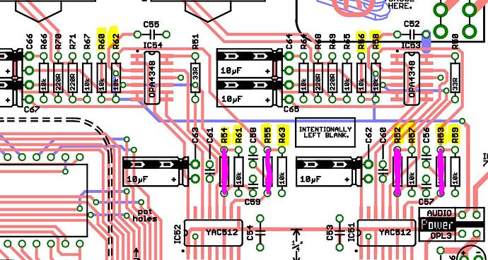

I removed the 12 resistors for the voltage dividers, and replaced R52,53,54,55 with jumpers.
Now it’s louder, same level as my MBFM with your mod.
I do notice some distortion with all 4 operators on full volume though, so nILS design make sense and is probably “cleaner”.
