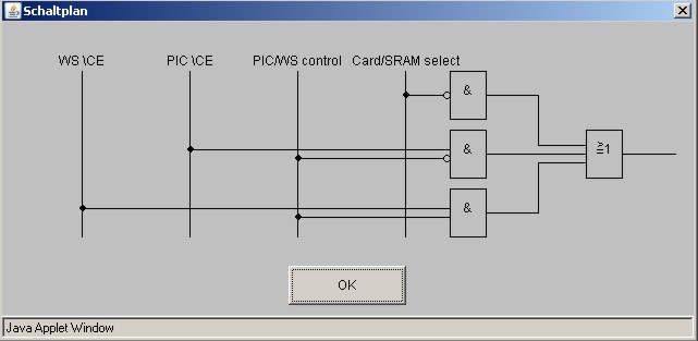

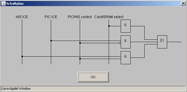

Now, what I did come up with is two circuits that synthesize my output signals, see what I attached. The question now is, whether I am better off doing this in discrete logic, in a small PIC or in EEPROM memory, as Thorsten’s last suggestion was. I may explain a little more:
I’ve been fiddling around with an idea for more than two years now. It is about a memory extension of my beloved Wavestation synthesizer. So, the PIC-based device should emulate bot a PCM card (this way, all the additional wave forms - key word ‘synth & Time Slice’  ;D - could be easily accessed) and a RAM card.
My main problem was until now the large memory I would need to store the PCM waveforms and the sound patch data - I tried interfacing a CF card to the PIC last summer but for some reasons beyond my understanding that did not work out. As I read between the lines that TK is working on MIDIbox SD, I guess this is nothing I should worry about any more, so I concentrate on the core part of my device. The main “problem” is that both the PIC and the Wavestation will have to access the address and data buses at some given time without influencing each other. I know about techniques to separate the buses using 74HCT245 and FST3245, now I am working on the \CE, \WE and \OE signals. The problem statement above is for the \CE line, the attached pictures (hopefully) make it more clear.
As I am talking about bus accesses, this is probably a bit time critical - at least probably more than Wilba’s suggestion would permit. Also, I expect at least a bit of interest in this device (e.g. the Synth & Time Slice PCM cardset goes for ridiculous prices on ebay), so it should be DIY friendly - whatever I can do using the MBHP burner would be fine.
Best regards, ilmenator

The logic you want to apply is:
Output 1: A + BD + !BC
Output 2: !A + BD + !BC
this means you only have to encode the (BD + !BC) once, which will help.
there are ways you can break this down further into only one type of chip, if need be.
So true - but actually, the requirements have changed slightly so that the truth table given above is not current anymore. But the principle of reducing and combining has become clear to me, thanks for taking your time!
