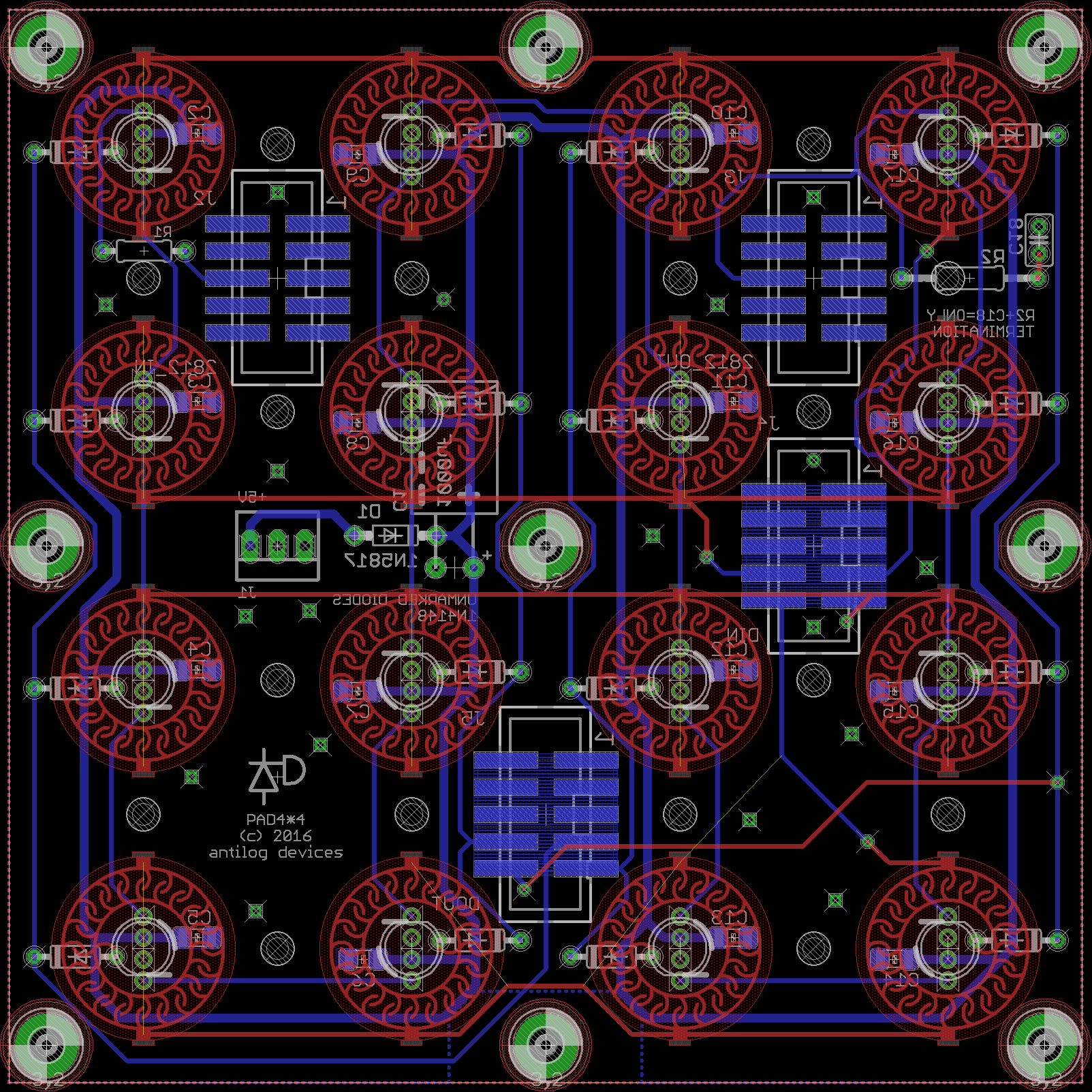

This is my take on the 4*4 matrix, prototypes ordered yesterday.
It’s designed for 2812 LEDs and Sparkfun button pads. In this way the matrix wiring is easier, and should be more programmable. TK. tried to PWM RGB LEDs with DOUT/DIN boards but the control was poor. It did work with individual DOUT pins, but then you have to dedicate a lot of modules to a single board.

There’s a couple of problems with the Sparkfun pads, which is why (IMO) it took so long for a BLM solution to materialise. First, the size and cost of the components are quite large/high. This means that a whole lot of them will be very expensive, and the case will be larger, close to half a metre. The adafruit buttons are not only half the price but 3/4 the size, which makes a more affordable and playable instrument when a lot of them are stacked together. The downside is that the latter only fit 3mm single LEDs, meaning another solution had to be found. Hence the BLM PCB with reverse-mount SMD.
Second, the matrix is not well set up/optimised for BLM. With some clever cabling you might manage to emulate the complex matrix and scan the buttons/LEDs with SCALAR boards, but this adds to the cost and turns it into wire spaghetti! This is a picture of a previous BLM attempt by , unfortunately I don’t think it made it as we never heard from him after September 2013.
Thus it’s much simpler if all wiring and shift registers are on-board. A downside is that troubleshooting is much more difficult as there are many solder points to inspect.
Thirdly, a crucial element to the BLM is the extra row and column + shift button. Without custom PCBs it is very difficult to realise this both in terms of the matrix routing and finding a mounting solution.
Looks pretty excellent - if I’m seeing this right, this is designed for through-hole RGBLEDs, yes? With 3x headers to for a DOUT module and a single one for the buttons to DIN? So if I’m understanding correctly, you’d need a total of 3 DOUT headers for each 4x4 matrix, making a total of 12 DOUT modules to drive the LEDs alone (16*3 = 48 headers, 4 headers per DOUT). Part of why I was interested in the Livid boards is because, according to its documentation, you only need to connect 2x of the headers to their Brain module. No idea what the differences are in how CORE and Livid Brain address LEDs.

Not quite, it uses 2812 programmable LEDs (5mm through hole) which are wired in a serial chain. This way you can cascade many button modules together and only one wire is used for the colour data. So you have data in and out, plus a 4*4 matrix (0.5*DINX1 + 0.5*DOUTX1) to scan the button presses. TK. has already demonstrated an animated rainbow of 64 LEDs this way.
With your omni board it will be possible to address each colour, you just need 48 DOUT pins per 4*4 array. So this is 1.5 DOUTX4 modules, plus 4 pins to scan the matrix, plus 4 pins on a DINX4 module to scan the other axis.
EDIT: okay, it looks like the Omni board has the LEDs connected in a matrix. So while you can address each one, I don’t think it will work with PWM, for the same reason as TK. found before. If the LEDs are already time multiplexed then PWM becomes much less effective. The plating also appears to be HASL rather than ENIG. I would take ENIG every time because the surface is much more even and is less prone to surface oxidation. One other thing is that the buttons look to be singular and without guide nubs. In this respect, sheets of Sparkfun or adafruit are better to stay even.

This is all very good to know. I’ll wait on the board you’re working on and see how that works out. If and when you have good results, count me in for a bulk order. I was looking to try and use the Omni RGB board for a BLM 20x16, taking a similar approach to the BLM 16x16+X you’ve already developed.
