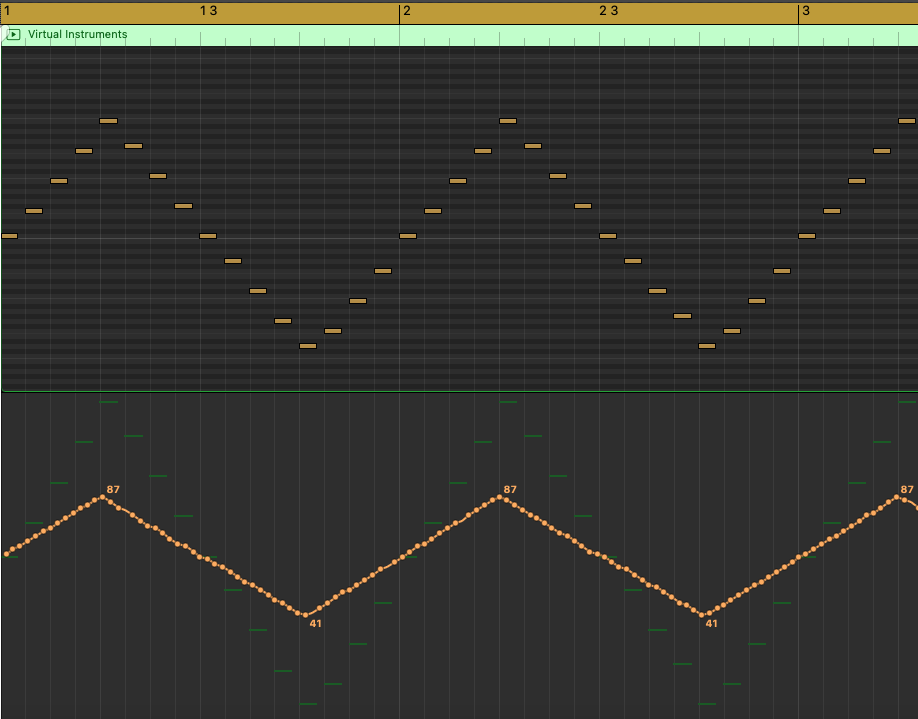

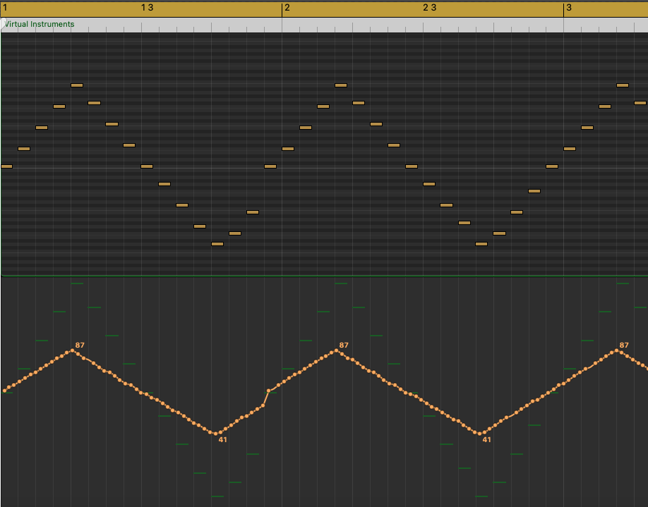

Yes, this was clearly visible - here a recording of LFO modulated Notes and Extra CC as it was before:
