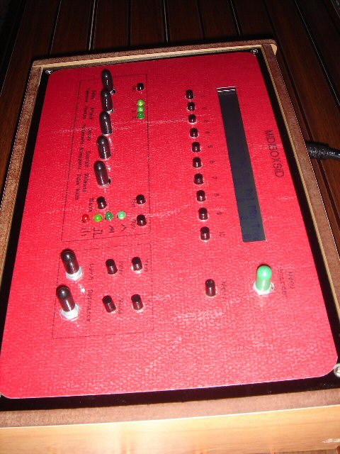

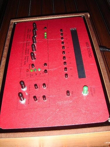

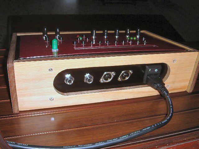

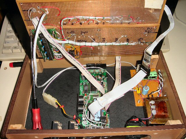

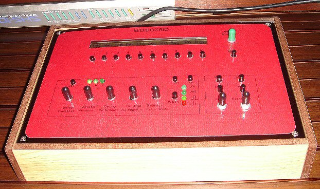

I used all the materials that I could gather from my little workshop to construct the enclosure. Enclosed hereto are some pictures of my midiboxsid.  Thanks

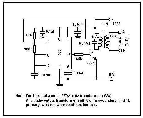

I am using a 2x40 LCD with EL backlight and have built a small inverter to power the EL element.
Hi, any chance you could post the schematics for this, I’m sure that there’s more than a few that would find it useful. How is it for intereference, does it introduce noise in to the circuit at all?
Hi Goblinz,
The inverter I used is made up components found in my sparepart box. The schematic is attached as requested.
The 555 Timing chip is wired as a standard square wave generator. The pulses are amplified by the transistor and fed to step up transformer. I used a small 1VA 230V to 9V low profile transformer. A better option would be to use a standard small audio output transformer (available at Radio Shack) with a primary measured 1k Ohm and a secondary of 8 Ohm. With the configuration as shown in the schematic the output of the transformer at A and B varies between 80V to 120V AC (loaded) with a supply voltage of +9 to 12 Volts. To test the circuit, connect a 2 nf capacitor as a load across A and B and switch on the supply. Measure the voltage across these points. It should be around 80 to 120V. The brightness of the Electroluminescent (EL) element depends on the voltage that is applied to it.
Shum
Edit: I forgot to mention that there is no interference heard over the audio system (with external amplifier).
