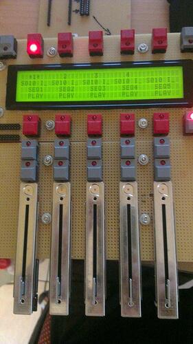

and to get a idea how my midi controll looks here’s a image :slight_smile: it still a work in progress each time i test it to see if it works ok..
