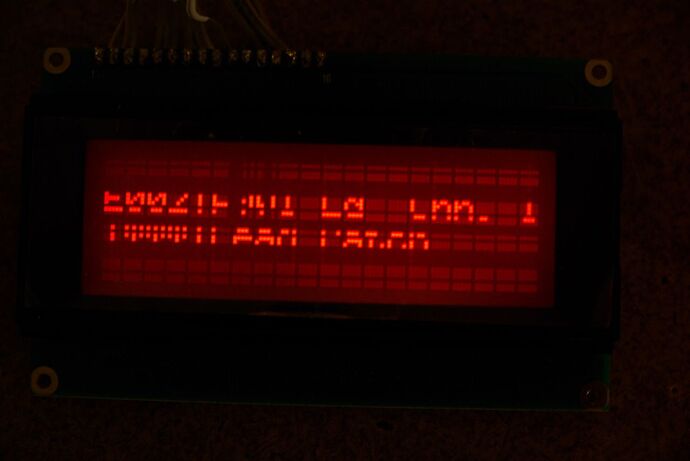

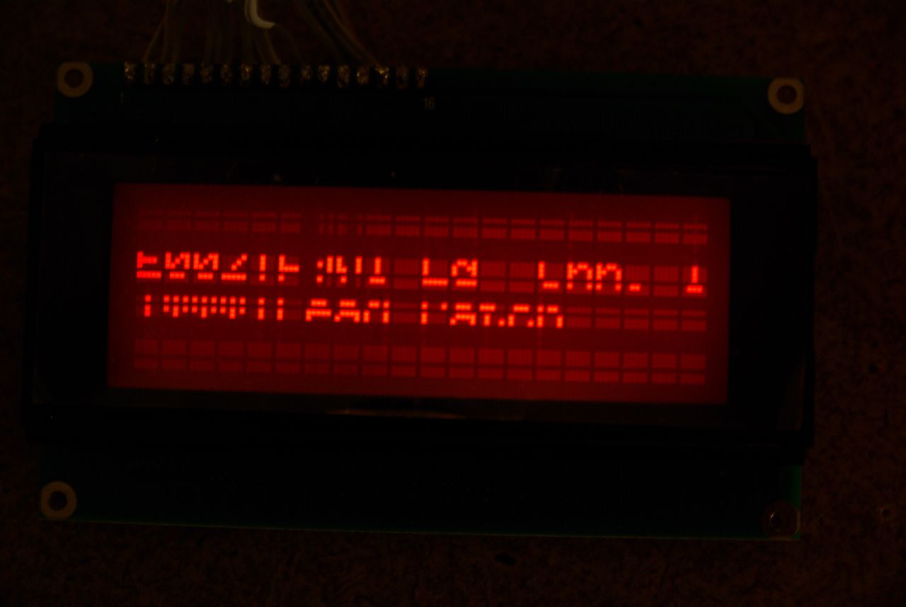

I just tried to set up my 4x20 oriental display on my mb6582 and get this uggly result. I have connected the display from my mb64 to the mb6582 and it looks good except that it is small. I have tripple checked the wireing and it is correct. I think the display is broken one way or the other, anybody has a better idea?

There is nothing wrong with your wiring, because the display is almost showing the correct text for MB-SID…
I can see what should be:
E002|A001 Ld  Chn. 1
1---|Lead Patch
[/code]
therefore the LCD is receiving the correct data - this is a character LCD, the PIC only sends characters (i.e. ASCII codes) so for the display to show incorrect/garbage characters means the problem is in the LCD.
It looks like whole rows and columns of the display are not lit... they're blacker than a "black" LCD pixel. This is a negative display so pixels that are black/unlit should still have a bit of glow behind them, you can see this on the display, but then there are even darker lines... I don't know much about LCDs but that to me suggests the LCD material is faulty.
I hope you can get a refund or replacement for it...  :(
^^^ Agreed.  Looks like a faulty LCD module.
$25 is a lot to spend on an LCD with no commitment from the vendor.  You should email them, and tell them you hooked another LCD up to your project and it worked fine.  Chances are they will just send you another one, especially since you have a photo to show them.
It is possible, but unlikely, that they will want the old one back.  For them, it’s not worth trying to fix.  For you, it might be - if the vendor lets you keep it, look all over the module for any bad or bridged solder joints. Just make sure you get a commitment to have it replaced before you play around with it.
