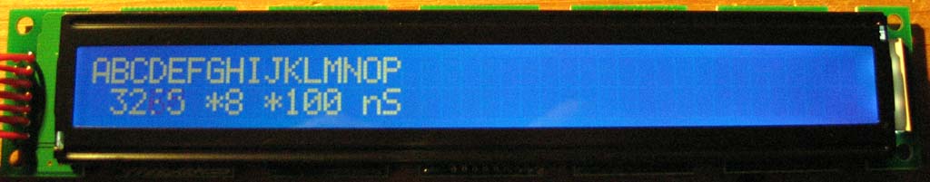

I’ve bought two Displays at ebay - for my SEQv3  :wink:
PMC4002A7-SBLW - 2x40 - blue/white
3265 *8 *100nS = 2,612mS
This is a good value !?! Isn’t it?  ;D
