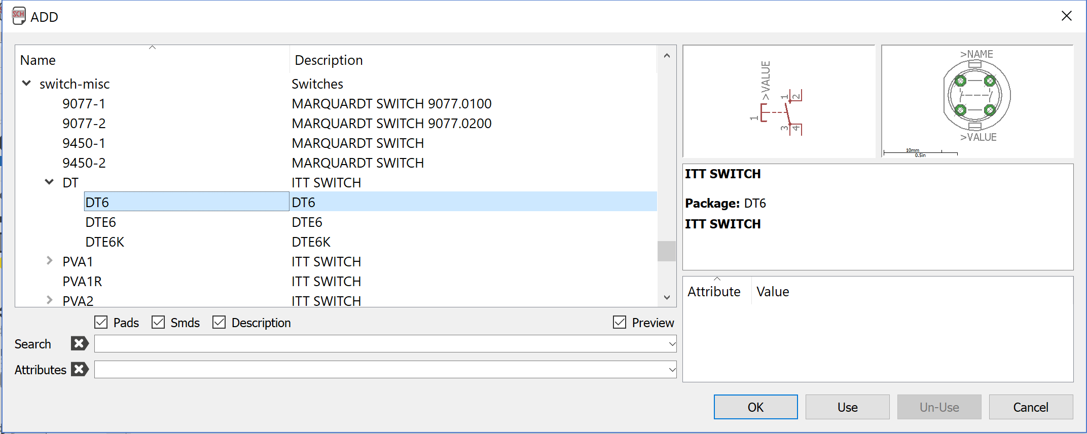

I’ve got it, but in eagle format, in fact this is part of the basic eagle library.
Maybe you can import it, I don’t know.
i downloadet a eagle trial,    opened  the   Library where the Switch was in it — and in it i run the script: eagle-lbr2kicad-1.0.ulp   -  download:    https://github.com/lachlanA/eagle-to-kicad-libs
then just include the library inside kicad,and we have it…

Part of the standard EAGLE libs.
