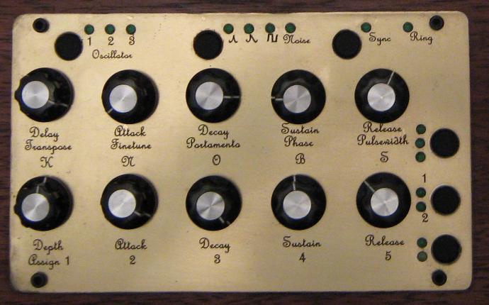

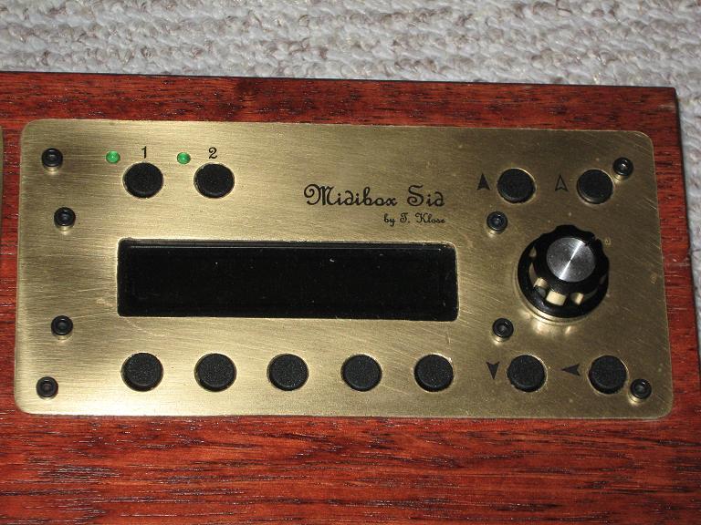

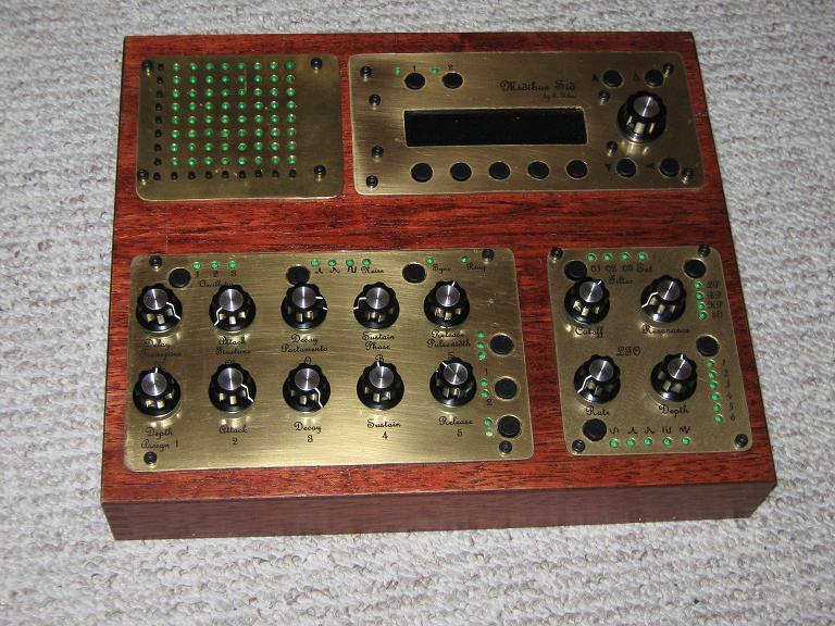

My SID, still WIP but nearly complete
the Panel is made of brass with laserprinted film
I have made this in my bathroom…so no real workshop was involved :wink:

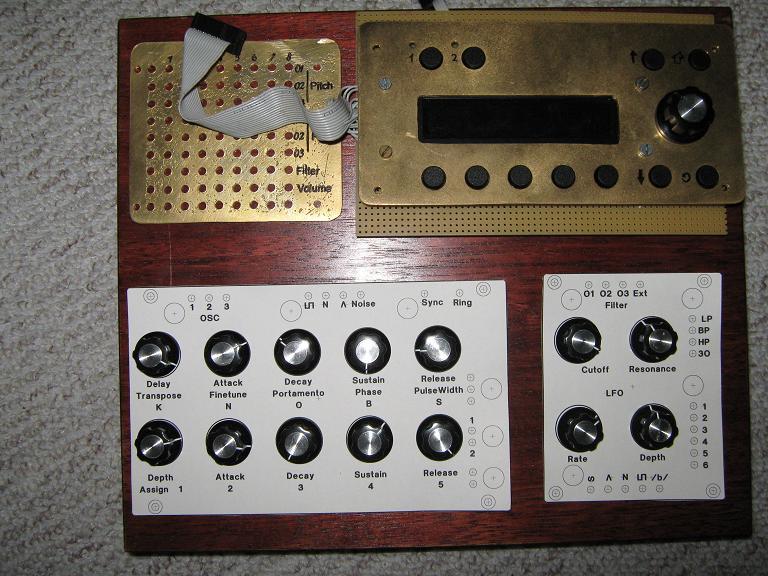

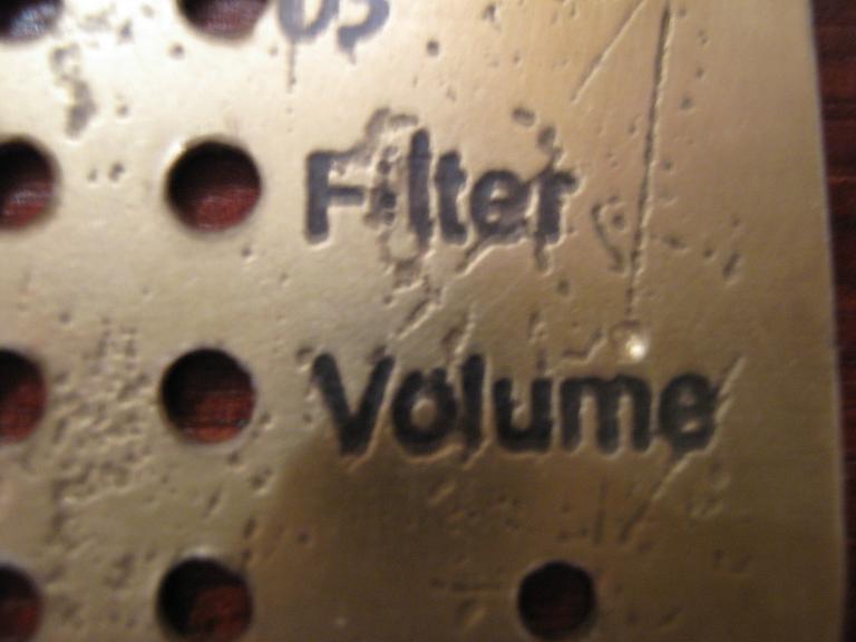

This is the backside of the etched panel, i just flipped it over instead of drilling all those holes again…

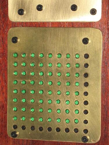

A part of the modmatrix. I made it by ironing on Press’n’Peel and then etching it in Copper sulfate.
As you see, it has not worked so well…

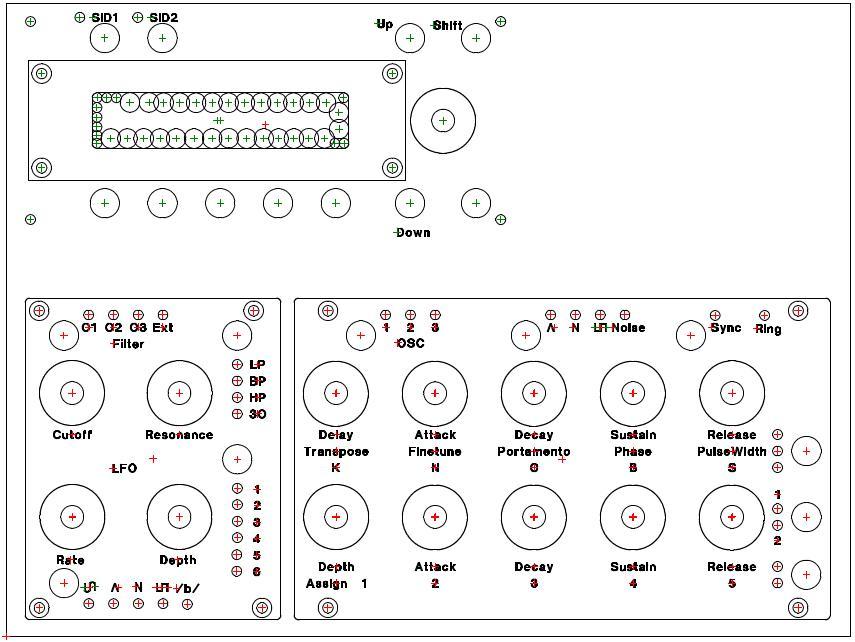

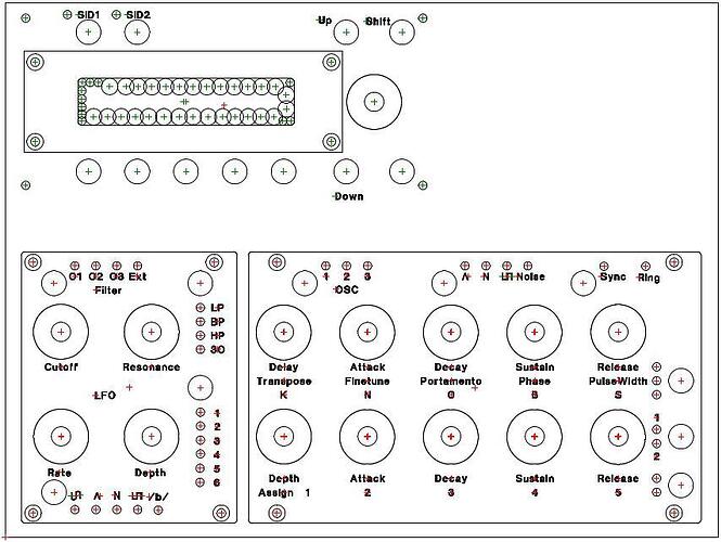

Just to fiddle with the layout, the design is not the final one…
I printed this, doublechecked for scale, taped it on the brass, and marked the holes before finally drilling them.

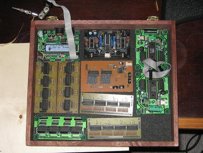

The guts minus the dreaded spaghettiness still to come…
It’s obviously the modular approach, with modules from Smash and Mike, and Seppoman’s ssm2044 Filter, controlled by one Aout_LC.

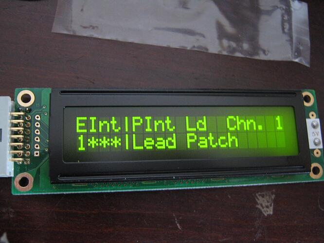

midibox Cv V2 CS 04b
Re: it's a brass thing.JPG
Great job. :smile: It reminds me of some of the steampunk projects out there which also use brass on wood.
Wow, that is the most “vintage” midibox design i have ever seen.
Its beautiful. Vintage SID would be a fitting name!
