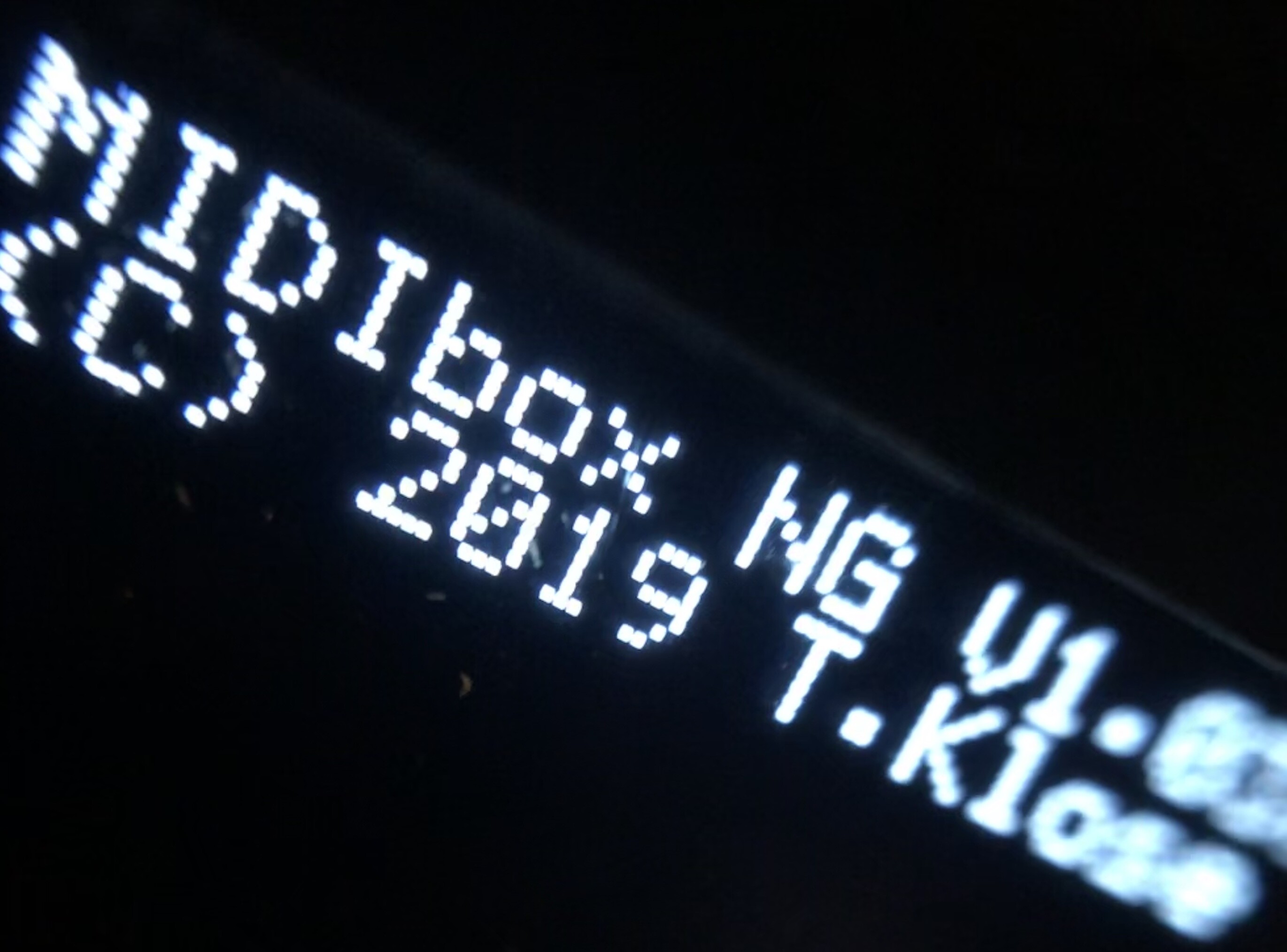

LED1 still blinking slowly, not sure if my old one did that? anyway, all seems to be working
EDIT actually no, while the ST now boots up properly and runs the NG program with only the midi USB connected, i can not access it via MIOS studio. Red COM LED1 keeps blinking slowly. i re-did firmaware updates twice and re-flashed bootloader after each time…
EDIT 2 as per usual after pluggging everything in and out 5 times, it now eems to reliably work. LED1 still blinking red, but everything works. shrug should emoji.
