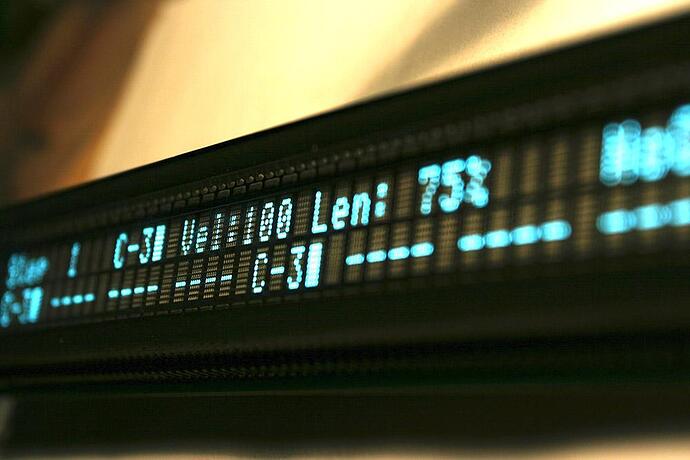

Futaba M402SD10FJ in 4-bit parallel transfer mode

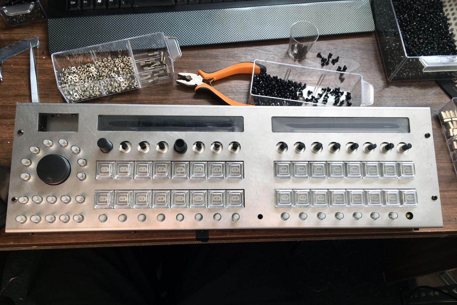

MBSeq V4 - Building the step button/encoder control surface

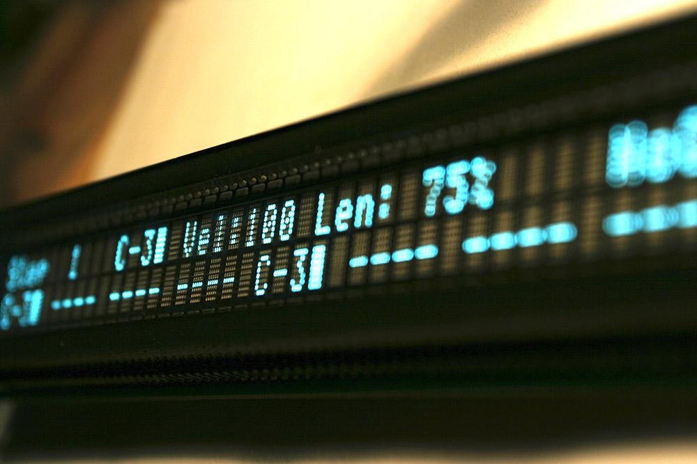

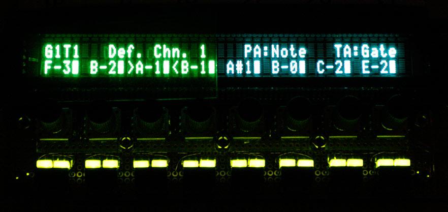

VFD hue color filtering
… using a cheap yellow color foil. These color foils are used to change the light color of presentation “spotlights” usually.
The foil is not yet applied firmly to the glass vfd surface, which is why you see a “ghost image” of the font.

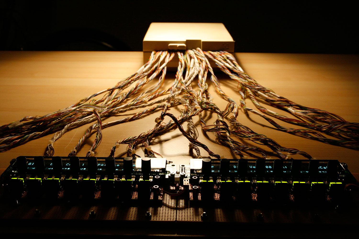

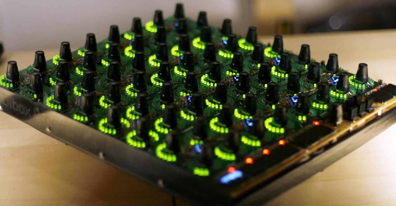

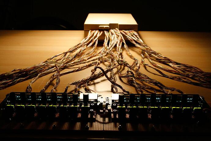

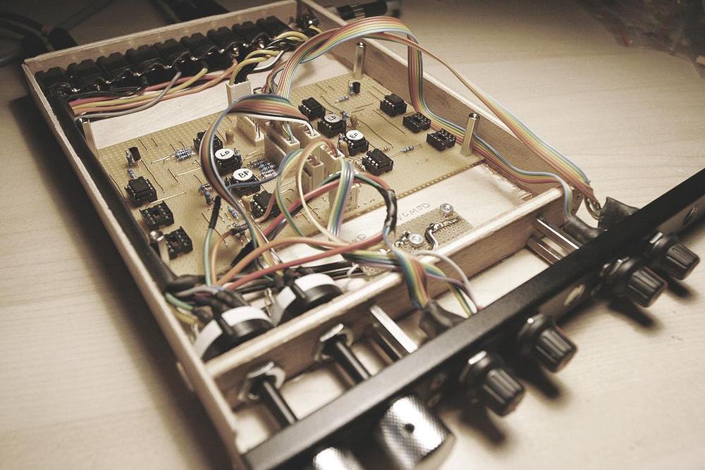

Cables!!
3xDINx4 + 3xDOUTx4 + 2xVFD Cables :slight_smile:

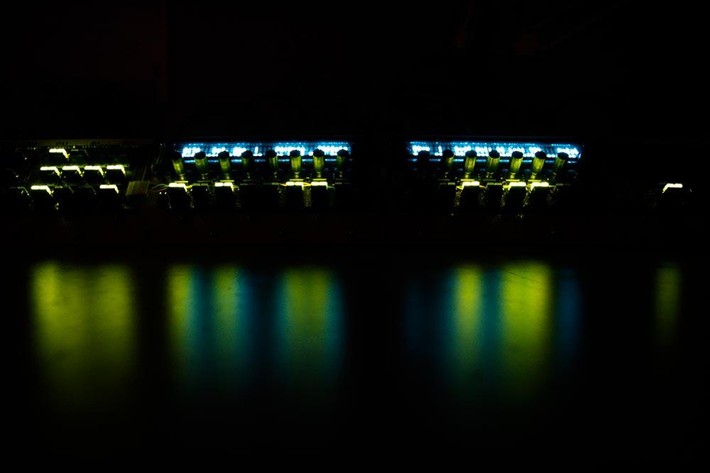

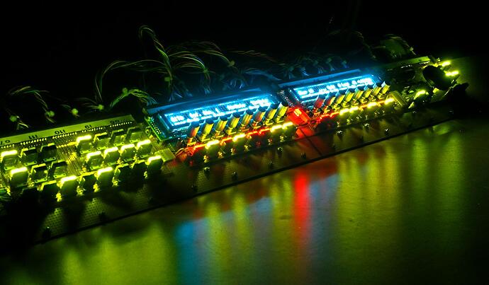

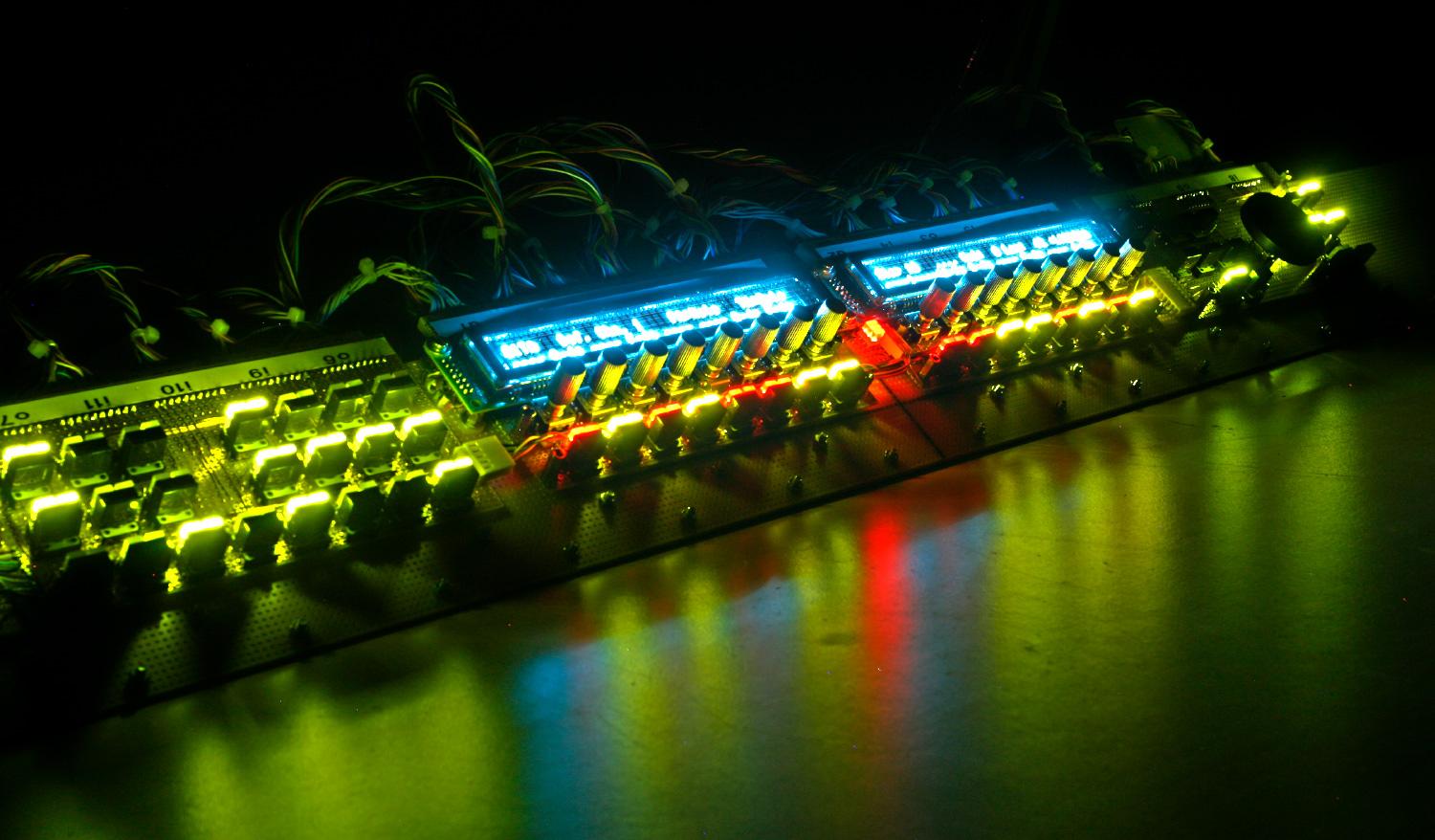

MBSEQ V4 at Night
An atmospheric shot dedicated to Antix, my friend :wink:
MBSEQ V4 HDR
Ok, sorry to bore you… I promise, this is the last night shot, at least for this month :wink:

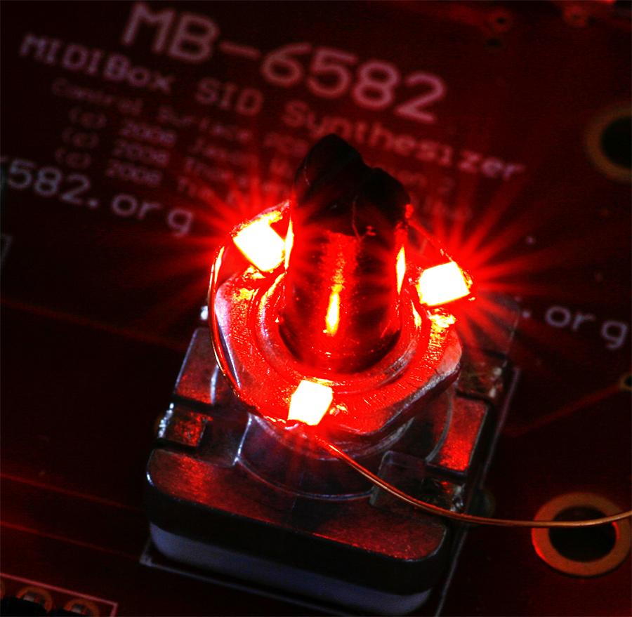

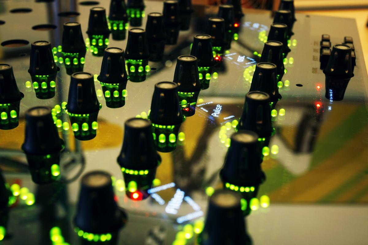

Backlighting transparent knobs for the MB6582
Those SMD LEDs are frickin´ small… should not have had soo much coffee :slight_smile:
Welcome to Lava City!
ah those lead free solder fumes dont make happy no more :rolleyes:
(backlight smd leds for transparent mb6582 waldorf knobs - last “night shot” of them, i promise :-))

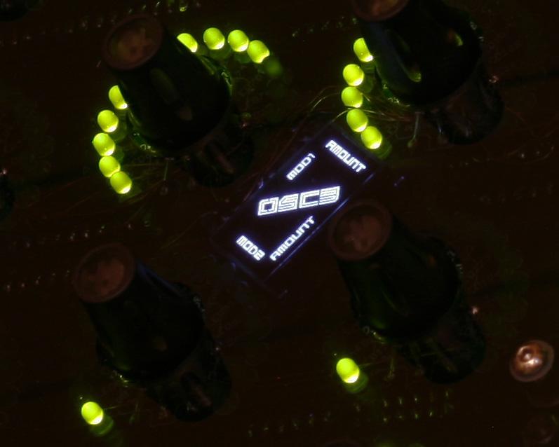

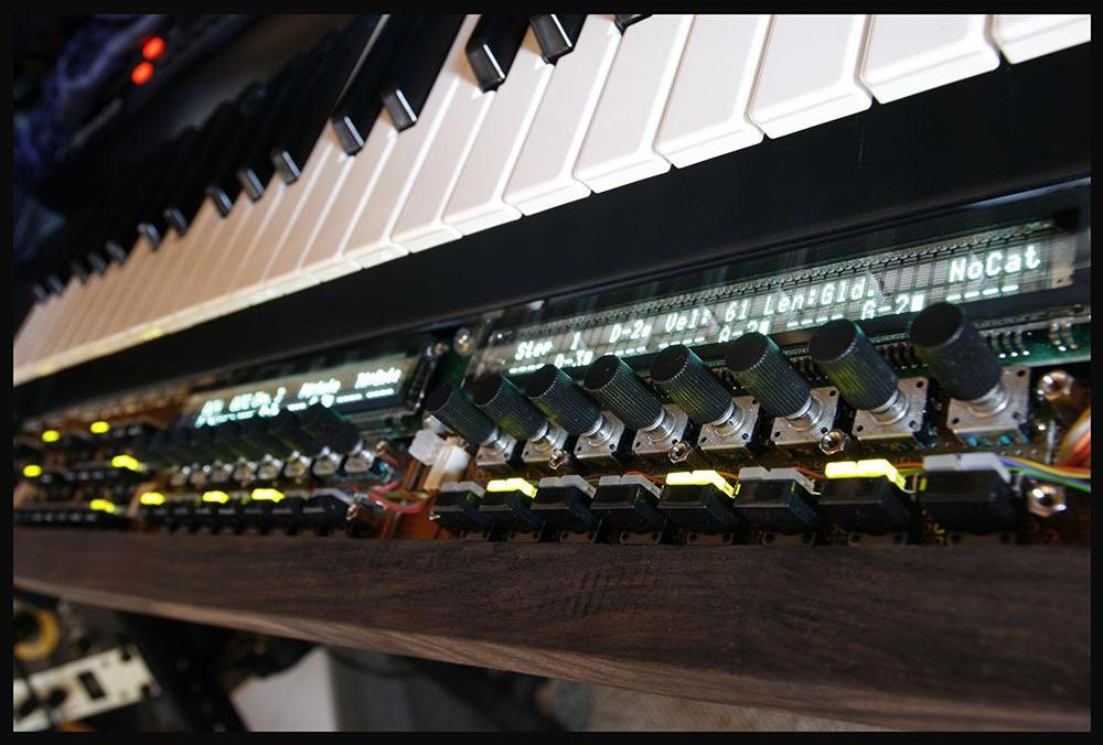

VFDified MB-6582 :slight_smile:
Using a color foil for VFD hue-shifting.
Including a space invaders alien.
Hope you like it.

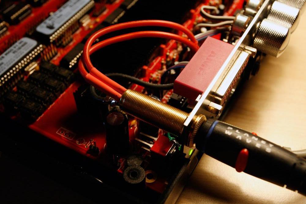

6.3mm Stereo Socket for MB6582 Passive Mixer Output
It fits perfectly… If you don´t have 8 mixer channels left, then this is the next best alternative to connect the MB6582 to your studio…
The case closes without problems and there are no contacts to the CS PCB or the display.
(-> See photo tutorial for more infos)

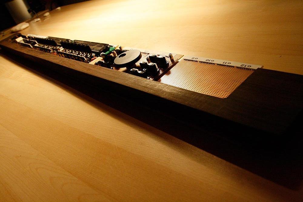

Ebony Frame for the SEQ V4 user interface
…for the worlds-first ebony MBSEQ v4
Ebony is very hard stuff, took some hours of woodwork :slight_smile:

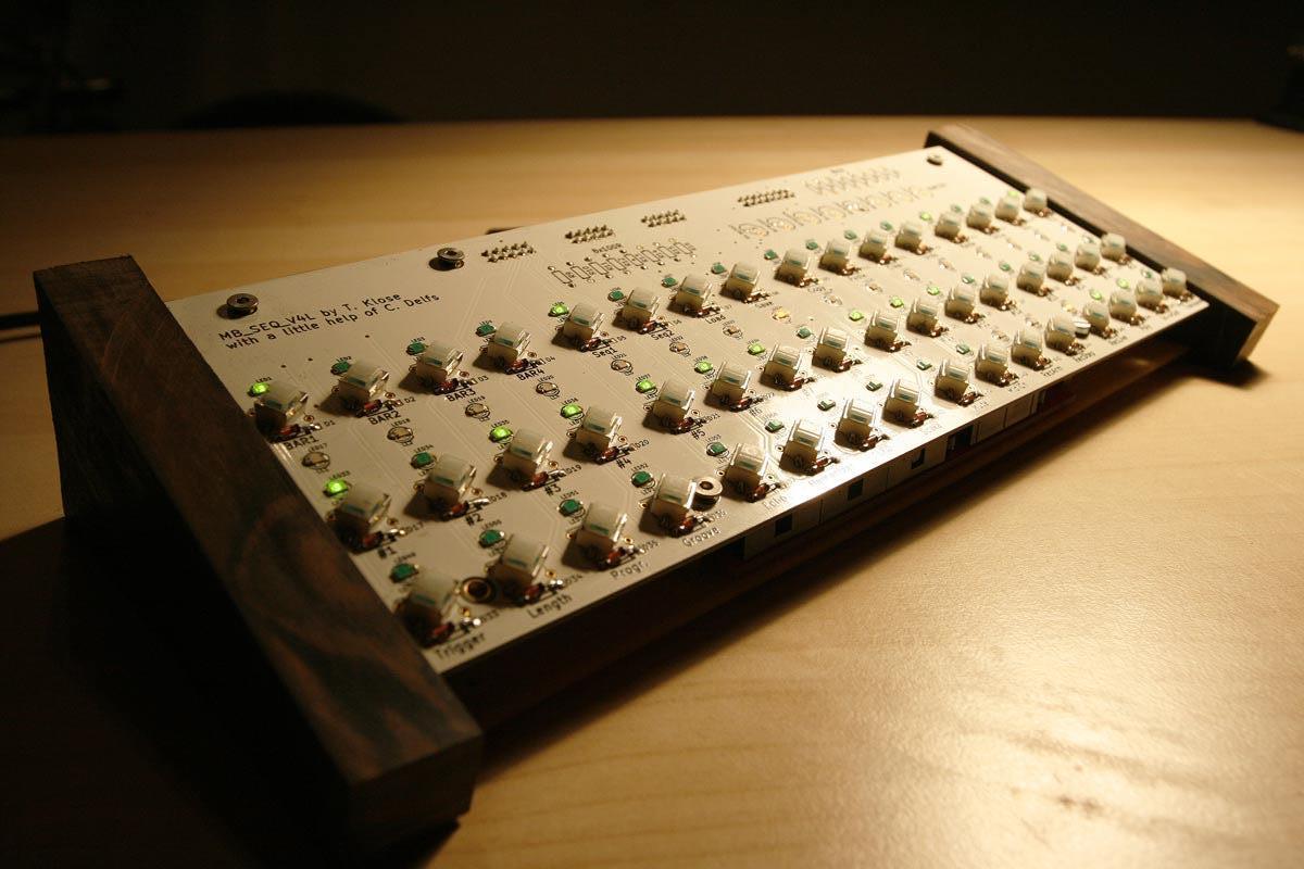

Ebony MBSEQ V4 installed below keyboard
Yes, the frontpanel is still missing :slight_smile:
I can totally recommend this kind of wooden frame for your builds, because it adds lots of stability.

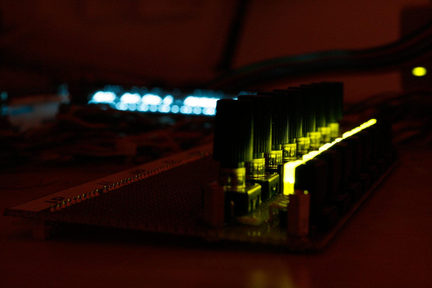

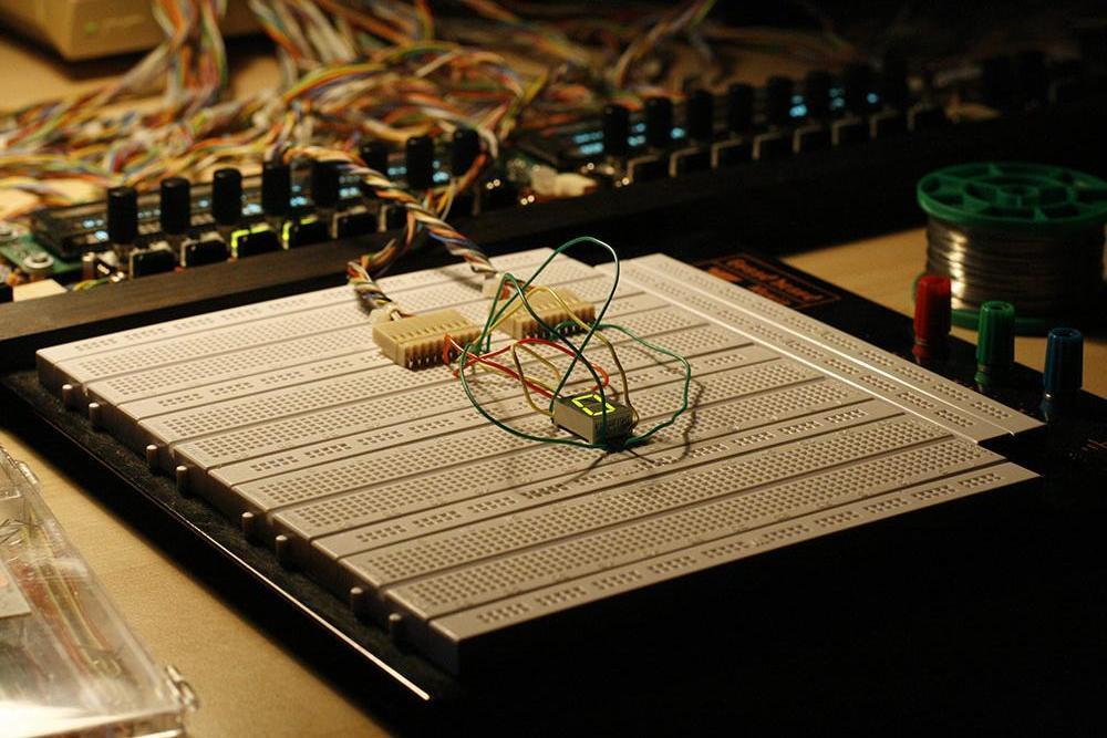

SEQ BPM LED digit on a breadboard :slight_smile:
it works :slight_smile:

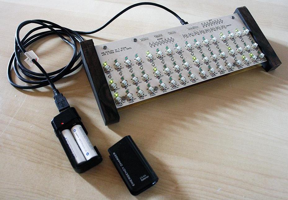

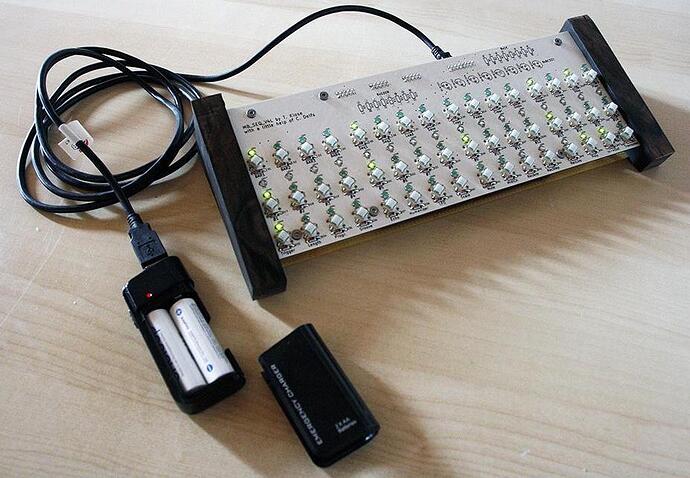

ebony +smd seq lite
just had some smd leds and pieces of ebony wood leftover :slight_smile:
´lite on batteries
2xAA batteries and an el-cheapo emergency charger from china :sorcerer:

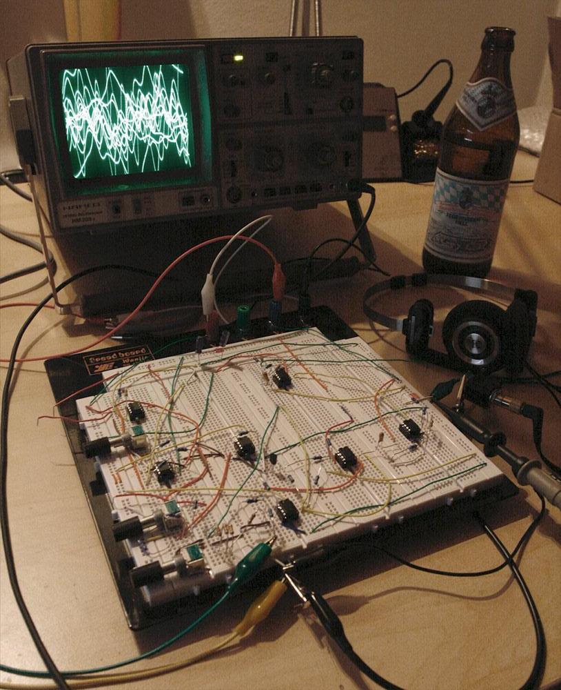

Breadboarded the “Bareille” Polivox clone and just did a test! Works nicely and does some very civilized filtering, when the resonance turned down, becomes a screaming beast when resonance turned up… Still to test: frequency modulation of the filter, have to connect a lfo voltage source and see what happens /public/style_emoticons/default/smile.gif) class=“bbc_emoticon” alt=“:)”>
Will build a stereo variant on veroboard primarly to be used with the MB6582 later, the rawness and the extreme resonance should suit the SID sound /public/style_emoticons/default/smile.gif) class=“bbc_emoticon” alt=“:)”>
Highly recommended because of very good performance for material cost - less than 20€ in parts, just 7 opamps, about 25 resistors, two 1uF tantals and three pots, +15V/0/-15V or +12V/0/-12V PSU (e.g. from MBFM) required.
Have fun!

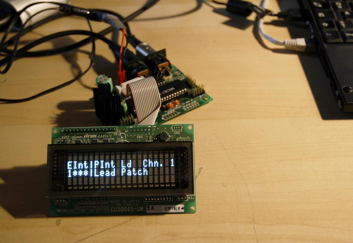

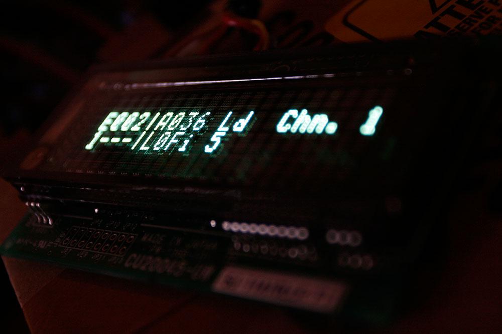

Noritake CU 20045-UW VFD for Core8
This one is for Altitude!
Thanks for sending the hardware, man! :slight_smile:
It is a beautiful VFD and currently quite cheap in the U.S. :slight_smile:
Many greets,

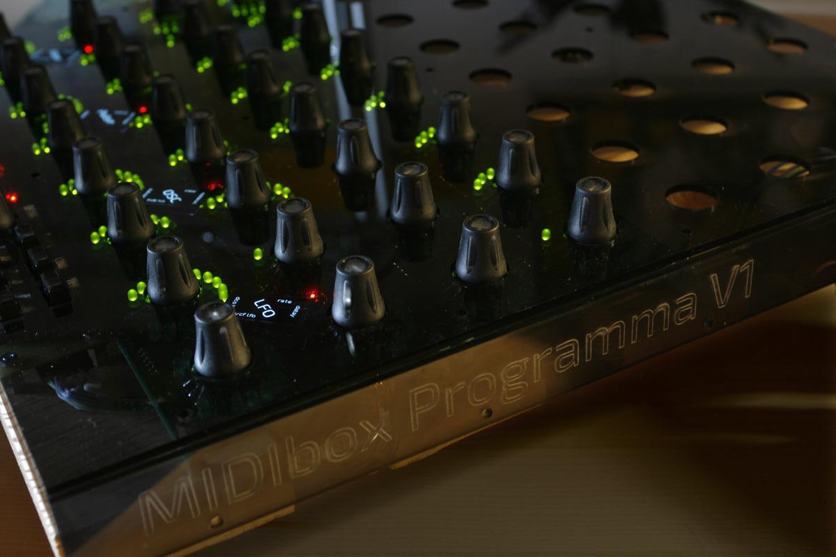

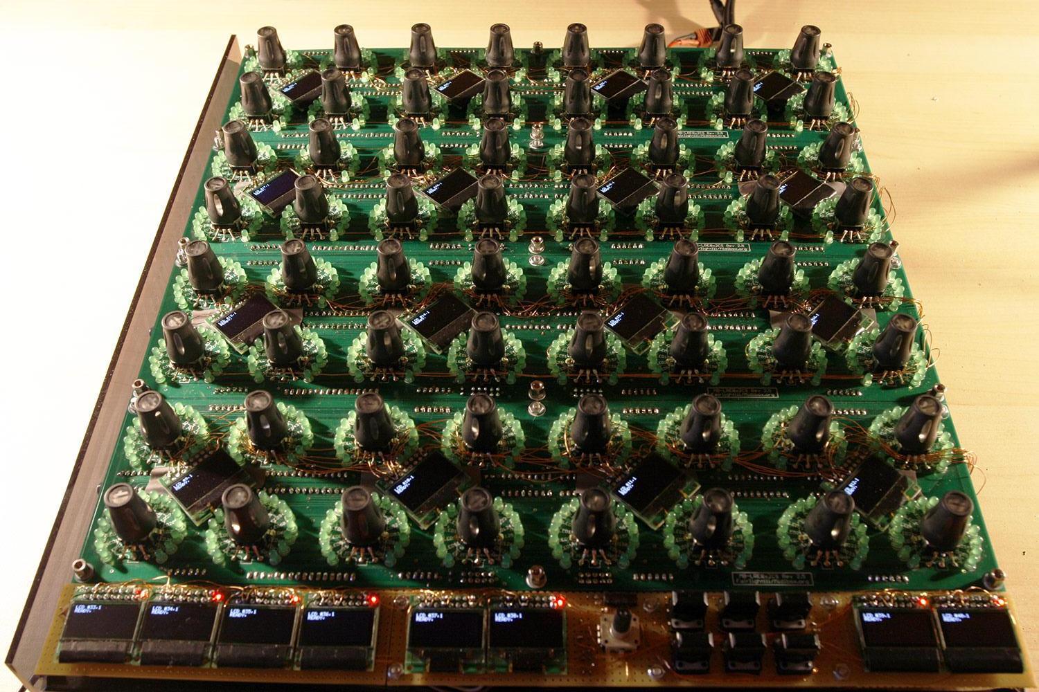

MBProgramma V0.1
…make some noise! :smiley:

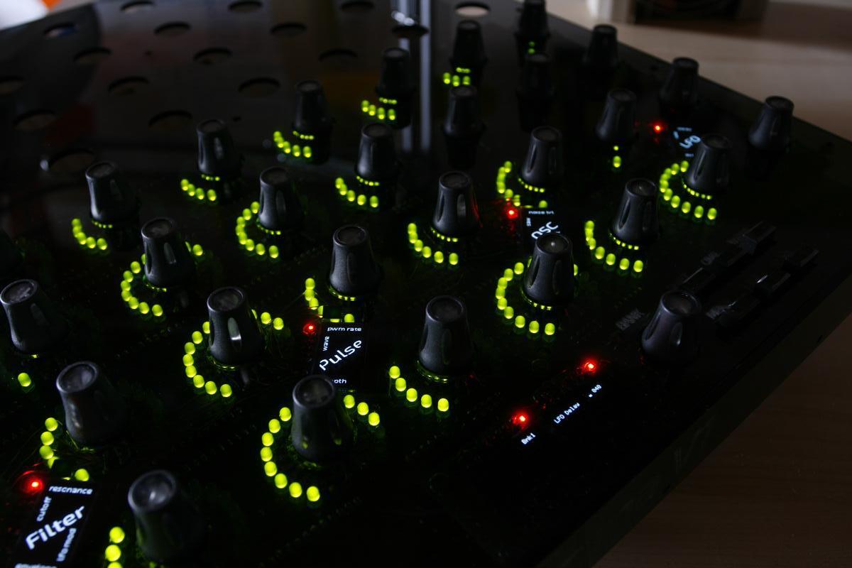

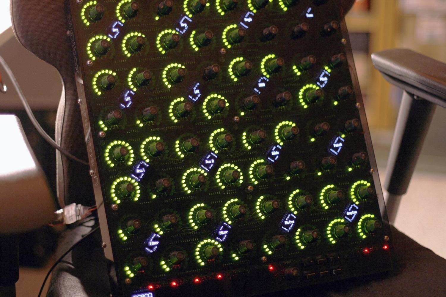

MBProgramma label displays! :slight_smile:
MBProgramma Side View
(panel not properly attached yet, just a teaser! :-))
programmaPanel
MBProgramma transparent / 50% smoked acrylics panel - not properly attached yet, just a teaser! :slight_smile:
programmaPanel2
MBProgramma smoked acrylics panel, part 2 (not properly attached yet, just a teaser! :-))
MBProgramma Reflections
:slight_smile:

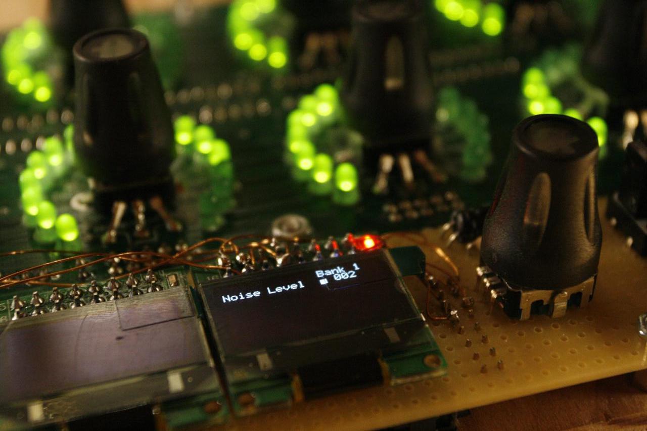

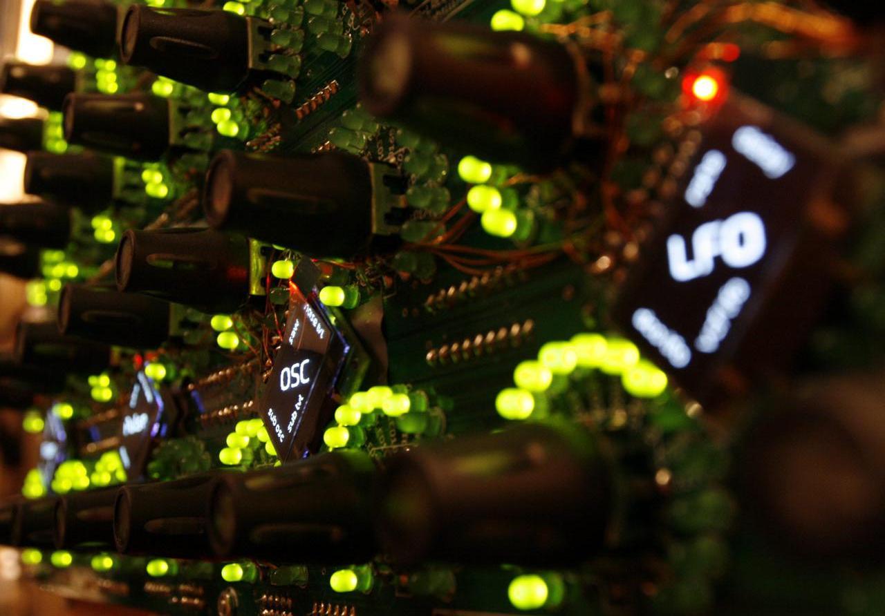

MBProgramma: 24 OLEDs working (1)
MBProgramma: 24 OLEDs working (2)
MBProgramma: 24 OLEDs working (3)
MBProgramma Label Display Detail
:slight_smile:

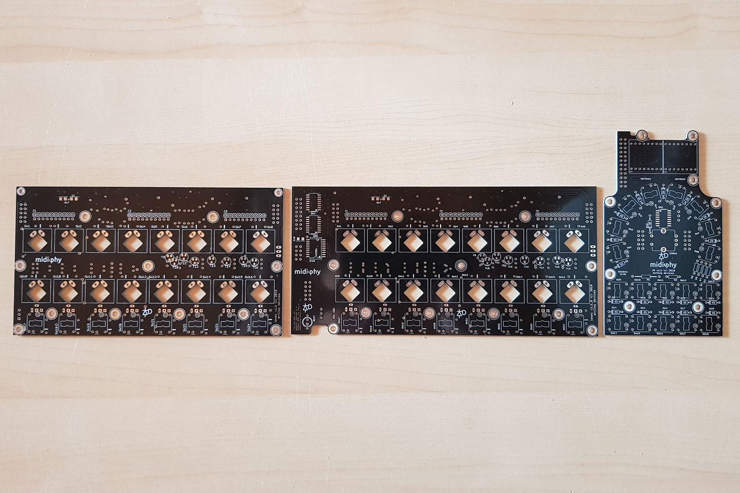

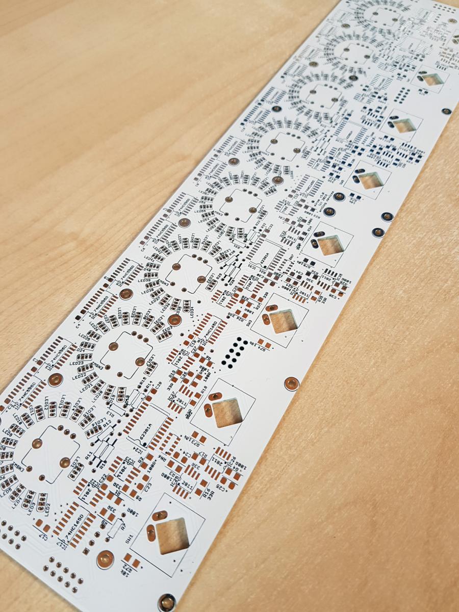

New v4+ UI PCBs :slight_smile:
… just arrived yesterday, off to validation soon, so that they can be made publicly available! :slight_smile:
Many greets,

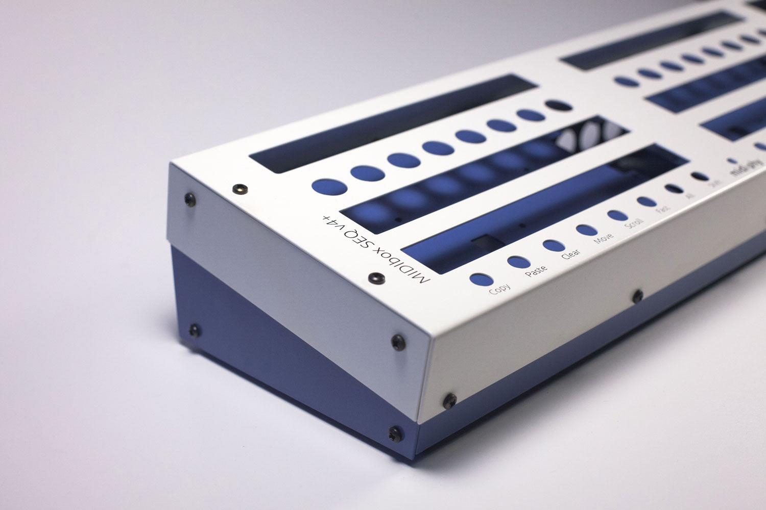

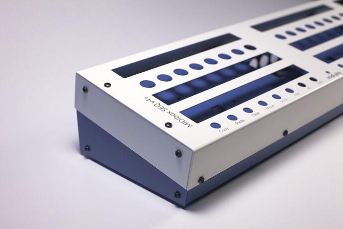

Assembly test of unpainted SEQ v4+ case , left handed jogwheel
Directly from AdrianH’s workshop - thanks a lot for the photo! :slight_smile:

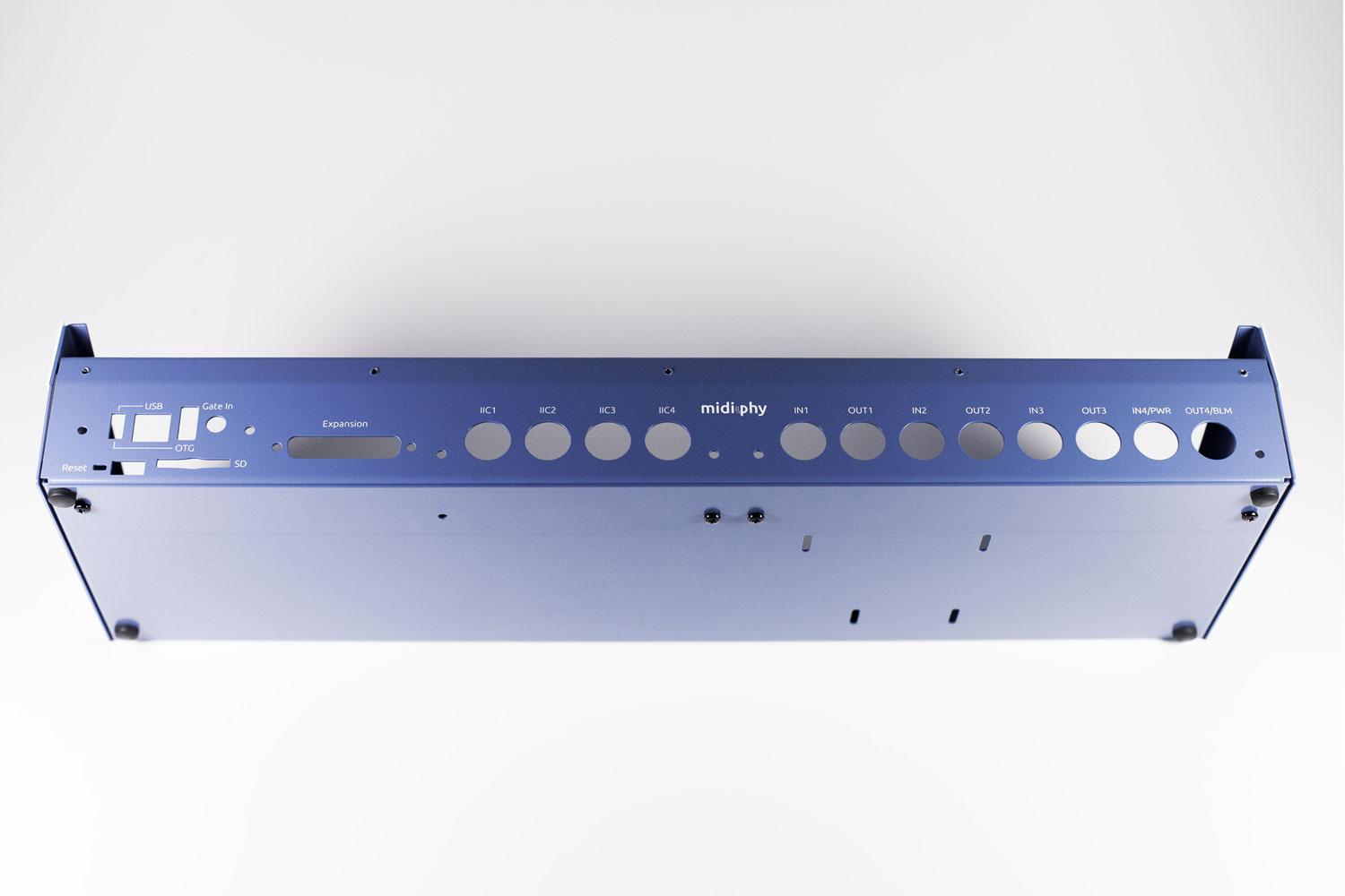

Unified midiphy SEQ v4+ case backside
including labels and an installed blinding plate, that covers the lower case options, that are available for optional rackmount mode.
Fantastic work again by Hallik Engineering!

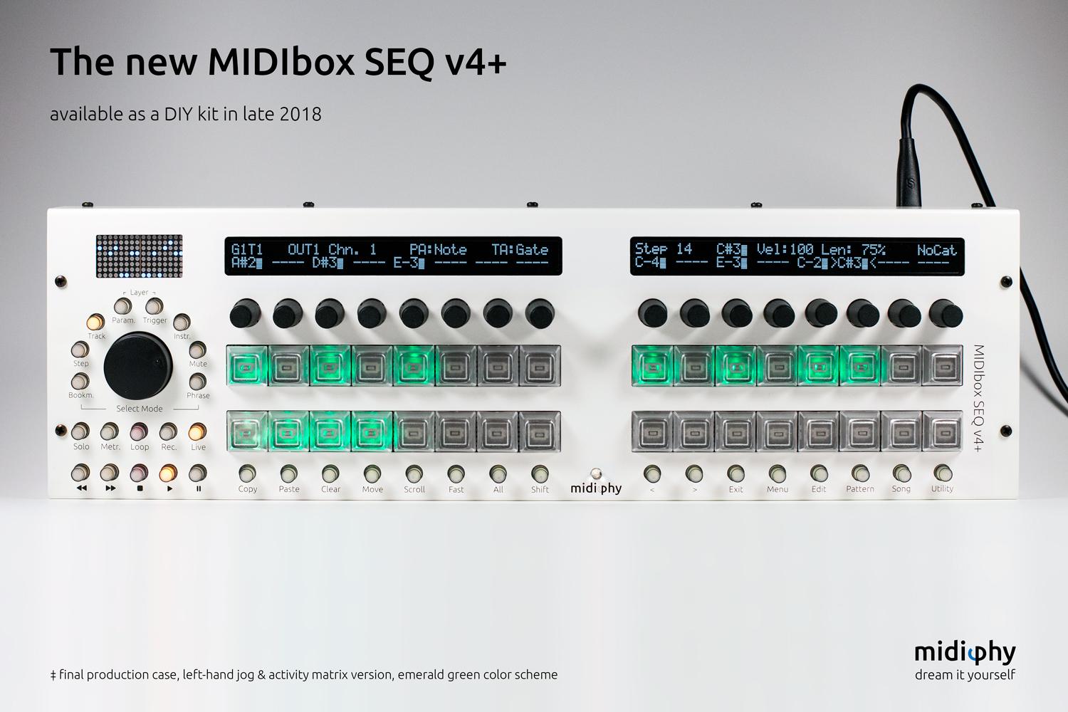

And the final SEQ v4+ case! :slight_smile:
This one uses a left-hand jog and activity matrix configuration, with green/red (“emerald green”) color scheme! :slight_smile:
Enjoy and many greets!

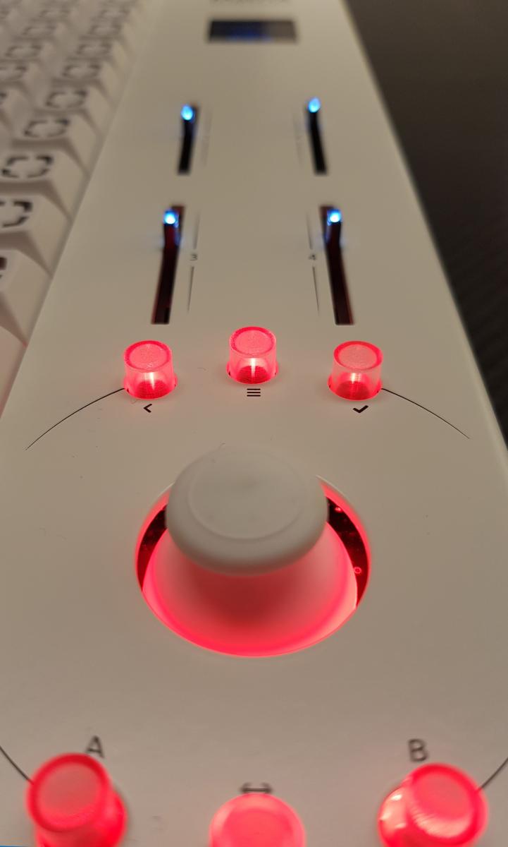

Red MatriX/BLM Teaser :slight_smile:
It’s on the way and working nicely - we currently estimate shipping of the first batch should be possible in January 2021.
Best regards and have a happy wintertime! :slight_smile:

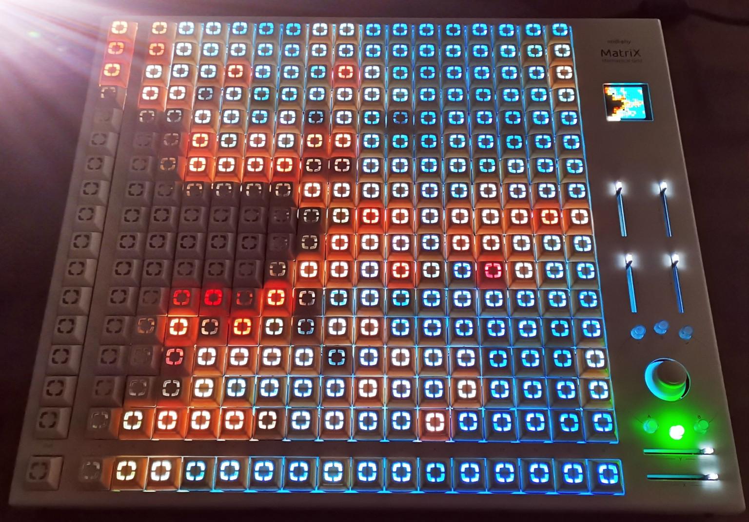

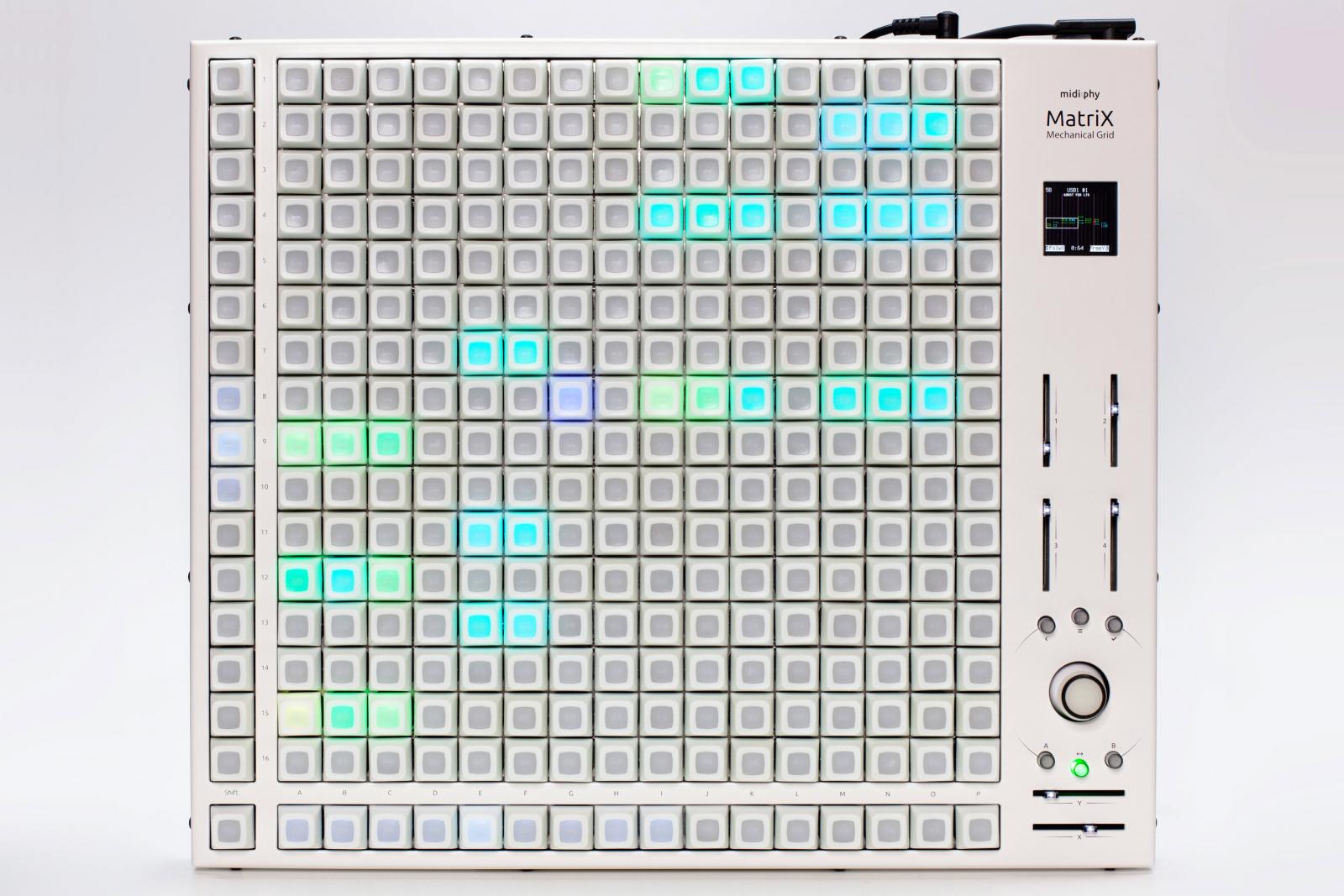

midiphy MatriX :slight_smile:
And here’s the final MatriX production case and looks - hope you like it! All kudos fly out to /profile/21362-adrianh/?do=hovercard" data-mentionid=“21362” href=“/profile/21362-adrianh/” rel=“”>@AdrianH and /profile/5453-latigid-on/?do=hovercard" data-mentionid=“5453” href=“/profile/5453-latigid-on/” rel=“”>@latigid on - thanks for the great case and the great hardware! :slight_smile:
Many greets,
latigid on’s new MatriX :slight_smile:
Well done, it’s looking great!
I’m still working on the software side (dual device support and LoopA support), but we’re definitely getting closer to the release date!
Many greets,

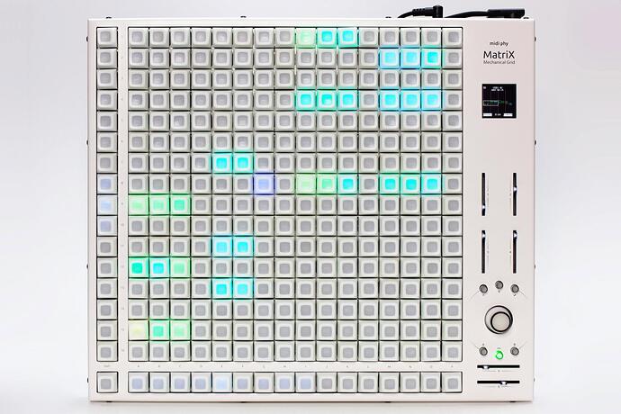

Hola,
it sure has been a while - but finally the new midiphy MatriX has been launched - with full BLM 16x16+X support, so all MIDIbox SEQ v4 can be attached.
More info:
[https://www.midiphy.com/en/matrix/](https://www.midiphy.com/en/matrix/)

Re: Futaba M402SD10FJ in 4-bit parallel transfer mode
Hi Hawkeye,
Why use the 4 bit transfer mode?
It is not really compatible in 8 bit mode?
regards
Antix
P.S.
really like this fluorescent displays
Hi Antix…
thanks… it is really not 8-bit compatible, read /topic/14858-lcd-character-scrambling-futaba-vfd-m402sd10fj-core32/for?do=embed" frameborder=“0” data-embedcontent=“”> more info and 4-bit mode code patch :slight_smile:
Greets,

Re: VFD hue color filtering
That looks very nice hawkeye!
Besides a little blurring its very hard to tell its not a green on black lcd.
thx, Smithy!
The blurring will be gone, when the foil is applied firmly to the vfd. i tell ya, never ever touch vfds… if you have seen one, you don´t want anything else - i would love to own a ~10 inch 80x25 character “pure command line” vfd for hacking, if it only existed :-).
Re: Cables!!
IT’S…ALIVE! :smiley:
Re: Cables!!
looks like LOTS of work!!
looks great!
Re: Cables!!
surely a lot of work :frantics:
Any problem with these long cable?
How long are them?
regards
Re: Cables!!
thx :rolleyes:
no problems with the long cables so far - ca 50% of the inputs/output wires are connected to cs modules by now…
I tested up to a meter and it worked… even without din/dout chain terminators (which I installed for sanity reasons). Now the distance from the core to the CS is about 50-60cm.
We will see what happens when all modules are connected…
Have a good new year y´all :clover:
Re: MBSEQ V4 at Night
i was just looking for the “like” button.
:slight_smile:
Yeah !!
:thumbsup:
remember me Sci-Fi movie
This almost reminds me of a city skyline at night :slight_smile: Nice!
Yes really…
a skyline of a city closer to the river
hehehe, thanks, i polished the table for an hour :wink:
