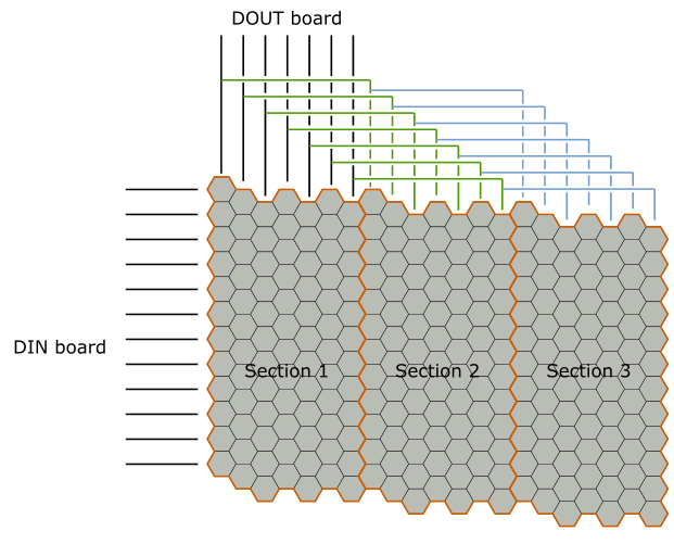

I’ve been working my way through the search results of this forum, its how I reached the approach by @TAG

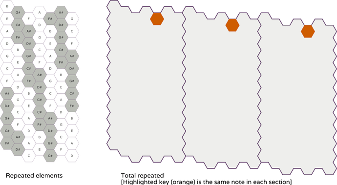

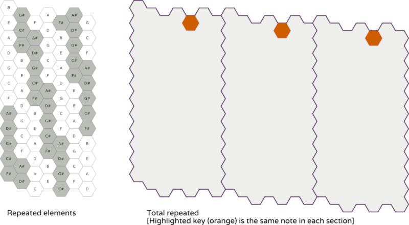

Split lines on top pcb:
Each section contains the same notes (octaves 1-7) and a duplicate of the matrix. When a note is hit, e.g. C4, it shouldn’t matter which section it is from.
As well as only a smaller matrix to scan, there is the possibility of adjustable length to the keyboard by addition or removing sections. This doesn’t affect the range of notes.
The Midi channel could be assigned based on rows, but not by section due to the repeated lines.
So you do not care what section you hit. Why? that’s a shame cause the SRIO is able to handle it even if you’ve got 2 switches layers and with not too much latency.
it’s 3 registers out x 3 registers in. The scanning order of your buttons is important as you can measure correctly the duration between 2 associated Switches.
But maybe i’m wrong, ?  is an expert in switches matrix and BLM, ask him maybe!
It looks like you would need 3 Dout in the above diagram or you are not going to have the button count you want. The way it is drawn you will have 3 sets of duplicate buttons. That does not sound like what you want. You could split the lines like you show for the velocity section if you feel you will never want to know velocity if you are hitting the same notes in multiple sections at the same time. This use case for scanning all 3 sections would come up if you were playing cords, slides and if you were playing a bass section and a melody on the other hand. There are likely other use cases if you consider things too. Splitting lines really does not make sense from a design perspective though as the CMOS cost is very low compared to button cost. If you are wanting to reduce components or costs it might make more sense to only start with one section and have an octave button and design with a modular approach where you can add sections if and when needed or wanted. Antichambre is basically saying the same above, hope this is giving you some other thoughts and hints around his initial “Why” question.

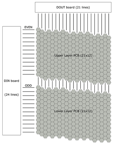

And if you want the 2 layer switch. try to use 24 DIN lines with 21 DOUT scanlines, maybe with even DIN lines connected on top and odd on bottom switches as you can apply some mask in the software  and calculate the duration easily,
Anyway keep the 2 layers on the same scanline, easy addressing will help you to compare the timestamp pairs.
Just an idea.
Thank you for the feedback on the matrix design. The matrix was really flawed.
I will build the matrix as you suggested
(Diagram not to scale)
